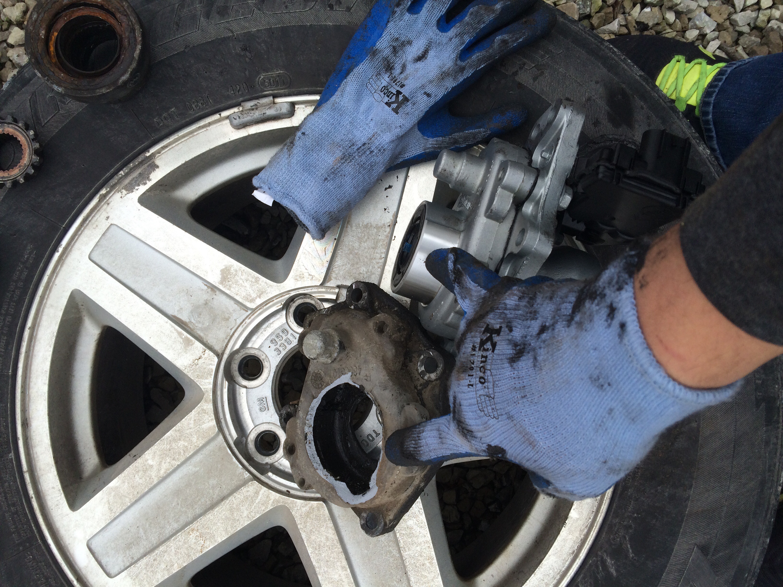

I could never get a bolt threaded into the intermediate shaft to stand up to a slide hammer.
Had to drill lots of holes and use a chisel to get the rest out over a few hours.
