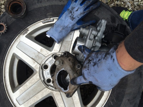

What are some methods used to remove a broken axle disconnect housing from the oil pan? The inner housing has broken off flush to the oil pan and the intermediate shaft is in the way to fit anything inside the broken collar to try to cut or release it. I purchased a small snap on slide hammer to fit between the collar and shaft but there is no lip to catch.

by Trail X » Tue Dec 16, 2014 11:27 pm
This is a surprisingly common issue. You'll likely find some topics if you search. Generally - you have to drill it out. But be very careful not to drill into the oil pan.

by v7guy » Wed Dec 17, 2014 6:14 am
I could never get a bolt threaded into the intermediate shaft to stand up to a slide hammer.
Had to drill lots of holes and use a chisel to get the rest out over a few hours.

by c0a8l0v6i8n9 » Wed Dec 17, 2014 4:45 pm
Drill holes very slowly until it gets very easy to drill. When it gets easy your drilling into the rubber ring in the disconnect. Then take a screwdriver and start breaking it apart.

by Trail X » Mon Jul 13, 2015 5:35 pm
You'll have to try a few bits to find the right size. Drill straight into it but be careful not to go into the oil pan. You want to simply relieve the radial stress and get the remaining casting to crack.
