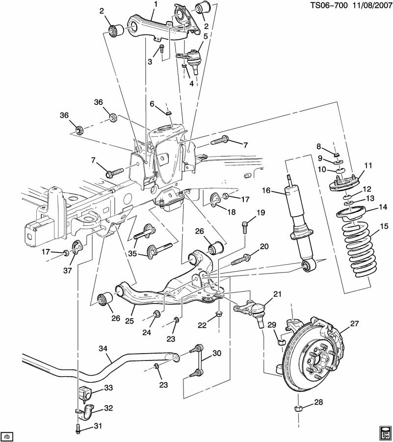

The Colorado has a completely different suspension than we do. Specifically the shock mount is totally different as is the lower a arm mounts.
But if you've gotten far enough that any of this is in the realm off possibility for you then you wouldn't be asking these question because you would have already done a google image search and compared them to what you see on your truck.
Basically, if you're looking to do anything beyond the MarkMC lift you're likely looking at something completely custom. By the point you look at changing shocks and their mounting you're looking at a "why not" snowball effect... for example, if changing the shock mounting is of interest then you need a new lower control arm to mount the shock to. You have to change the upper mount to fit accordingly. Then if you're building a new upper mount and a new lower a arm, then you've still got to build a bracket to lower the diff and house the intermediate shaft, within the confines of the stock subframe (good luck). If you're hacking off the stock subframe then you're moving the lower control arms down so you can clear the diff and then you need a longer spindle to make up the difference. At that point why aren't you just extending the arms for more travel and running a bigger diff? Why are you bothering with stock anything?
It really never ends. Then you're still limited by the angle a CV joint can run at.
