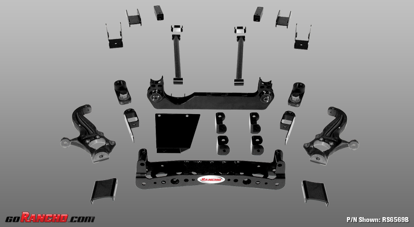

Man, if we had their suspension design instead of the one the GM gadget team stuck us with, it would be heaven. Look at the bolt-on ball joints! The easy pivot lower strut mount!
Look at the fantastic kits you can buy like this 4" one from Rancho for only $1500!
Man, people even sell adjustable ball joint mounts to fix camber problems. Droool.
