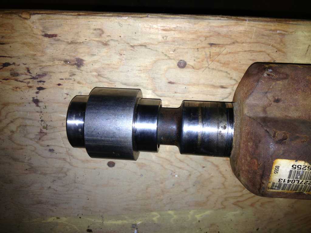

I think I may have screwed myself, but does anyone know if you can remove the AWD sleeve from the CV axle after the retaining clip locked in? I am working on my broken disco and was fitting the sleeve to see how it fit on the CV axle and pushed it too far in and heard clip and basically realized I probably just F'd myself. If anyone knows a trick that would be greatly appreciated. I don't want to cut it off with a saw and waste it.
I figure there is a way since looking at the AWD vehicle diagrams they have the same clip but maybe I just pushed it on too far. :wallbash:

by flyme » Sat Oct 26, 2013 8:42 pm
Thanks for the reply Erik. This is the current situation:

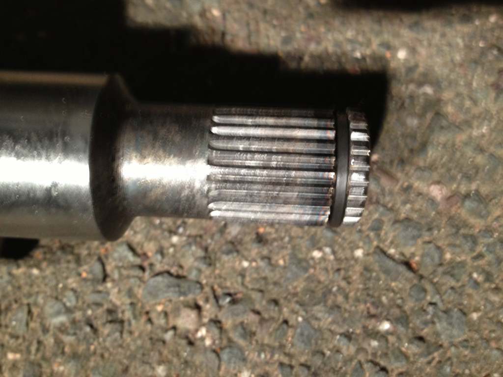

And it is stuck on this retaining ring, if you can see it:
Now I went and got another CV axle and put the disco back together. Since my 4x4 wasn't working before I don't mind not having it for a few more days until I figure this out or get a more sleeve.
If anyone who has swapped to the sleeve reads this, can you tell me if you left the retaining ring on the CV axle or did you take it off? If you left it on, when you put the CV axle back in, did it click into place?
I am having a hard time imagining that it would click into place and lock on the AWD vehicles and then not be able to come off and replace any bearings in the disco.

by TangoBravo » Sat Oct 26, 2013 9:19 pm
Looks like I would use a pulley puller if I had that stuck on there, now this only works if it's a true sleeve and open on both ends.

by flyme » Sat Oct 26, 2013 9:56 pm
Thanks for the reply. I will look into it as it is a true sleeve. The only problem I could see is the retaining ring needing to be bent and that would be a lot of force.

by Trail X » Sat Oct 26, 2013 10:21 pm
The cv shafts are the exact same for awd and 4wd vehicles. It will take some toying with it to unseat the clip, but it certainly can be done. Do not remove the clip. That keeps your axle seated in the disconnect - otherwise it would quickly ride out. Drop some oil down in the open end of the sleeve to help lubricate the clip and splines, and then either use a bearing puller, as was recommended - or clamp one end into a vice, and hammer on the other one with a drift. I bet my pitman arm puller might even work.
by dvanbramer88 » Sun Oct 27, 2013 12:13 am
Solid advice all around. I'd put the Sleeve in a vice, somehow trying not to mar it up, and with a big ole drift/punch Drift the CV shaft out of the sleeve. Lube it up good first.
Or you could put the CV tripot in the vice, be less worried about marks, and drift the sleeve off. But in that case, Id be worried about damaging the edge of the sleeve. Not sure if that would really effect anything at the end of the day.
Or like others said, if you have access to a jaw, pitman, or wheel puller, that would probably work too. Either way, use lube.
And than on re-assembly once you got it all figured out, lube the spline of the CV shaft with grease or anti-seize so the CV is easier to pop out next time.
Good luck
by v7guy » Sun Oct 27, 2013 12:36 am
Lots of solid advice here, I'd be inclined to use some kind of impact to pop it loose. Much like when removing the CV a sharp impact compresses the clip and lets it pop out. A vice,a hammer and a drift/pipe/chunk of rod whatever should get the job done with no drama. As others mentioned, some oil or grease might help.
