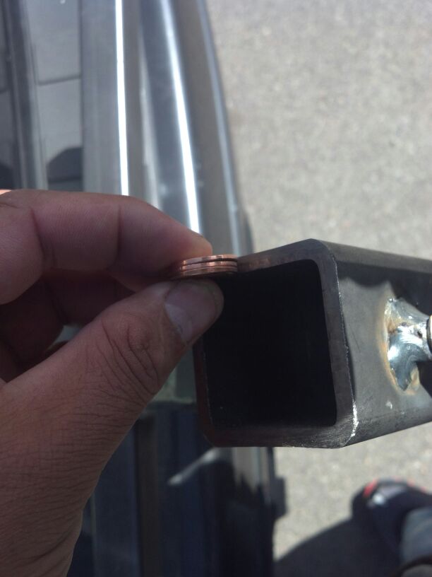

So we welded this up this weekend in about 4 hours from scratch. We were talking about making a couple for sale probably looking $200 plus shipping and a couple weeks build time cause my brother does the welding and hes a railroader so only in town about a week each month. The pivot pin ir hidden. This thing is heavy duty.

The pivot was welded in place the grinded smoothon the outsides. The length of reciever would not be a prob at all this one still needs cleaning up cause we ran out of time while making it i will also post pics of finished product. Im posting some pics of the raw welds too so you can see the quality and some comparison so you get an idea of thickness and strength of metal used. I wasnt concerned about the length cause i wanted to have plenty of room for ball to take my 4x8 trailer on and off with tire mounted. I will let you know max size tire for glass to open in about a week the ones i have now are 32s and i have about 2 inches but i ordered 33' guard dogs and i wanna make sure hatch still opens with a ball mounted when its down.

Everything was made with same thickness materials that were on a reese 3" drop hitch we had laying around.
