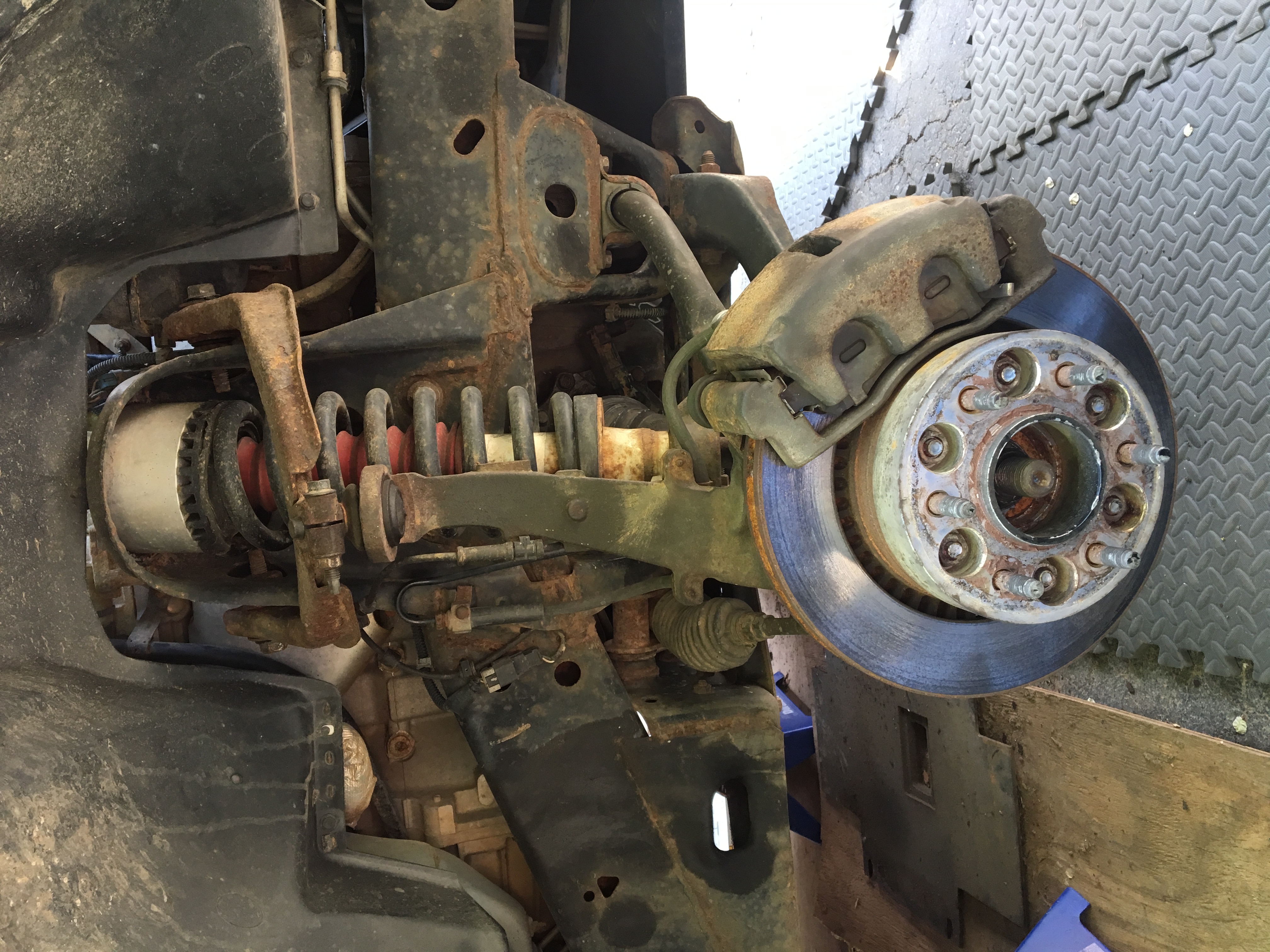

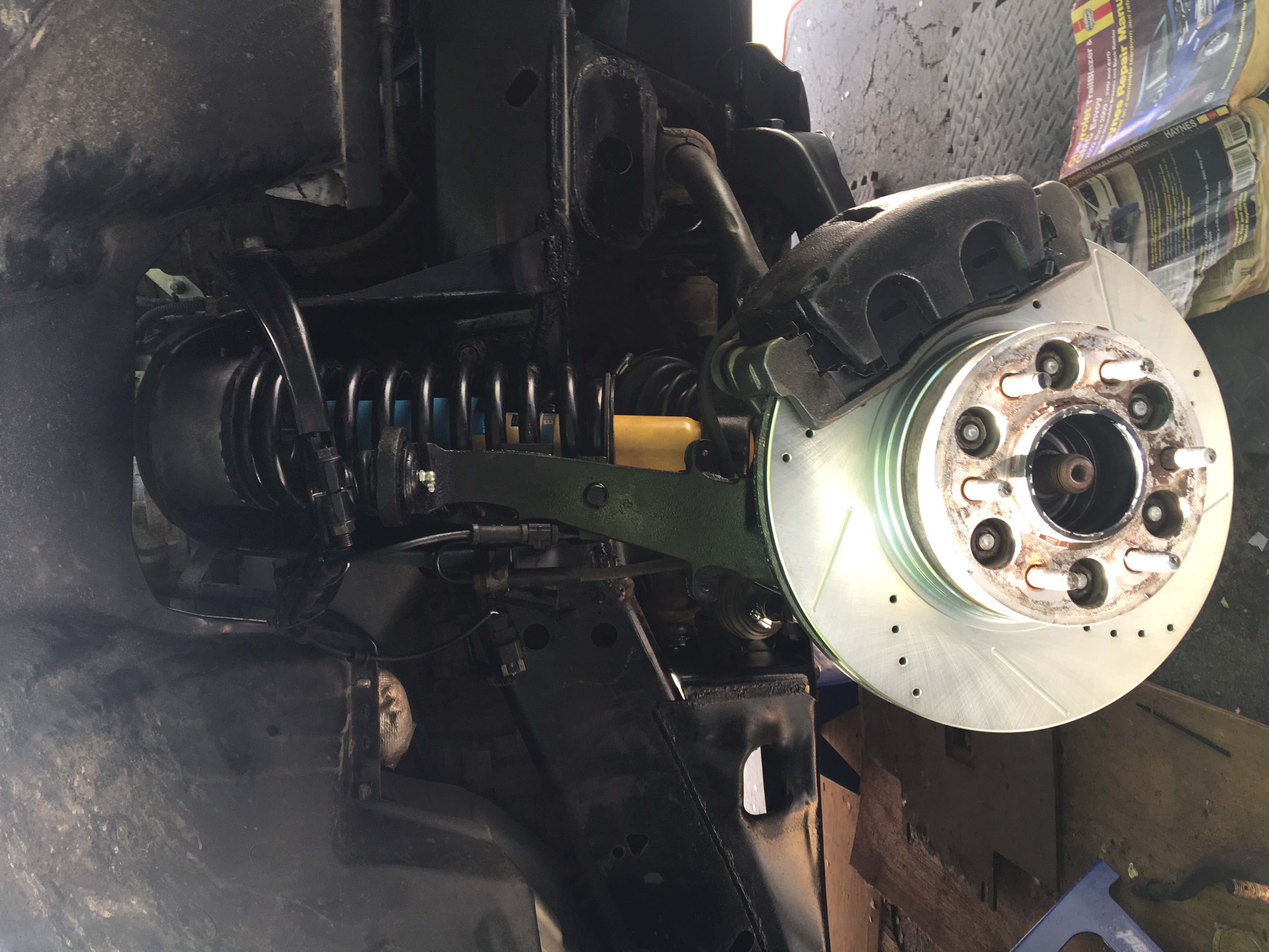

by Anthony Hernandez » Sun Apr 16, 2017 10:05 pm
Replaced tie rod ends(inner and outer),ball joints, upper and lower control arms, cvs, struts, and moog 14's. Rides stiff.

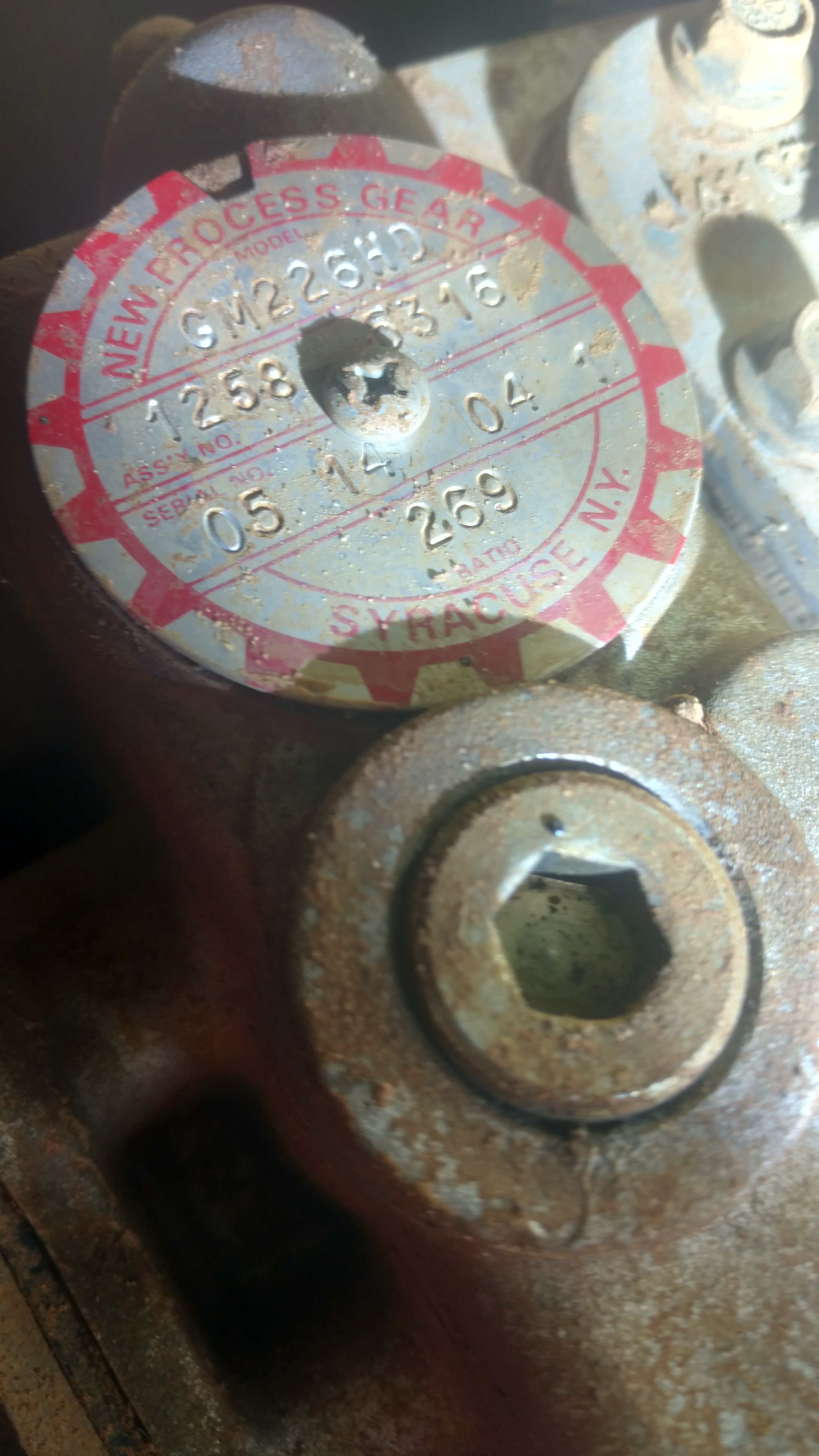

Not today, but recently switched out transfer cases. Mine started making a loud clicking noise which then became a popping at moderate acceleration while 4wd was engaged. Had no power at the front wheels either. I used the troubleshooting guide to determine that it was the transfer case. Then I went to the yard and jerked an HD case out of a TB EXT.
$150 and two hours later, I was back in 4wd.
I've sourced the parts, and while it's a bit cost prohibitive (since I can get t-cases for $150), I don't want to swap out t-cases every couple years, so I'm going to do a complete rebuild, clutches and all, as I get the cash to buy parts. Judging by what I've found, I should be able to do an entire rebuild myself for around $500.

HD case???

Aren't they all that?
by KingBird » Mon Apr 17, 2017 3:26 pm
I'm not real sure, I don't think the one I pulled out said it but I could be wrong. I couldn't really find anything online differentiating except for when the names changed (new process, new venture gear).
This one works, the other one didn't. Lol

I'm not sure they are all the same Kyle, when I went to the junk yard to find one I couldn't get any one with the same numbers on it, some were 226, gm266, 226g, it had me confused I ended up leaving with nothing because I thought I needed a gm nvg226.

I think it is just nomenclature but they are all basically the same

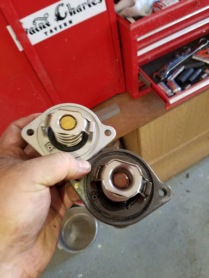

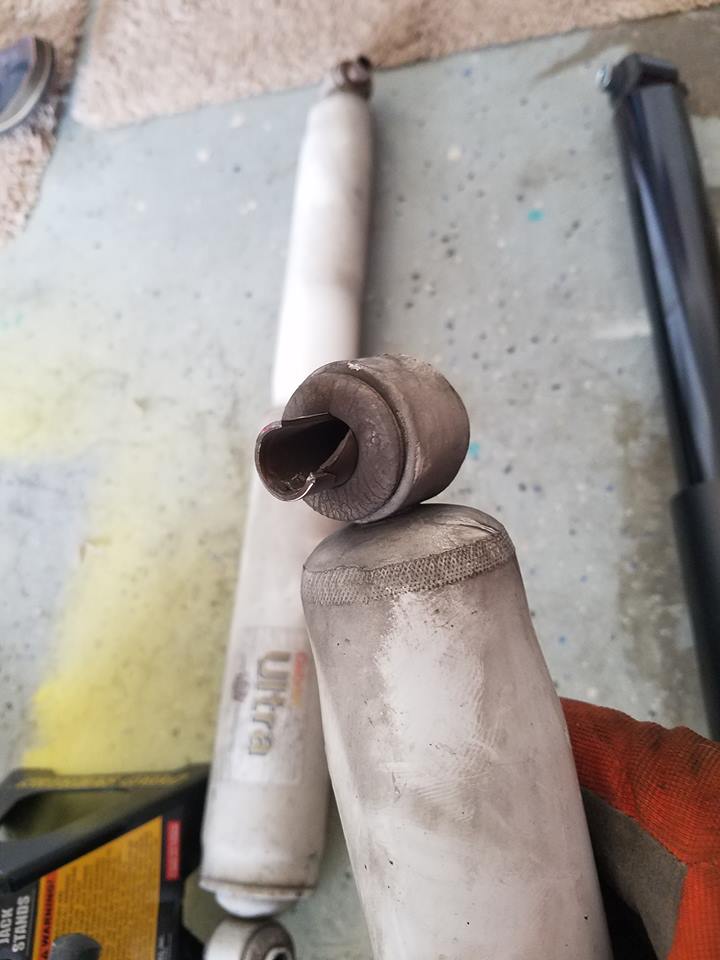

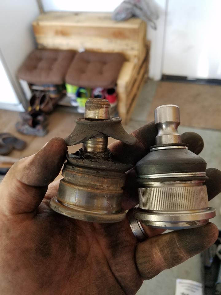

Busy busy busy...After all this work it is still a bit squeeky so I guess I haven't solved all my problems yet. The truck does have 188k miles so I should be grateful
UCA, Shocks, Sway bar links
Upper Ball joints...EEP!

Replaced the Thermostat...running soooooo much cooler
