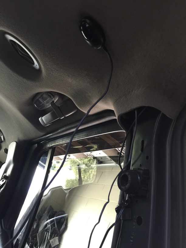

Also, I have this speaker and wireless thingy on driver pillar. It used to give a tone like power on but no connection. Is it a cell phone thing? I just realized I have not heard the speaker humm in a while. hhhmmmm
Any ideas are great!! Posting this just made me think about that speaker on pillar....

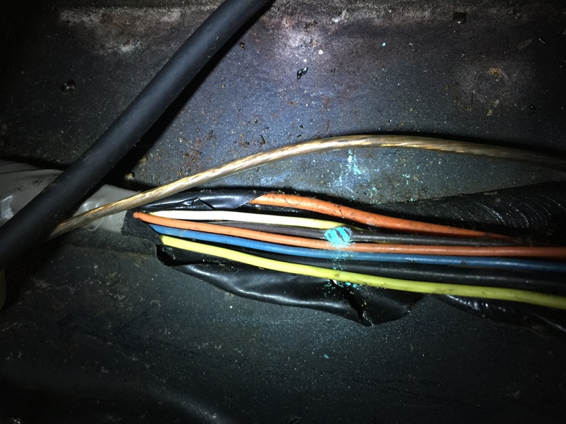

by bljis123 » Thu Dec 01, 2016 9:55 pm
Finally, I found it!!! Funny thing I tore the whole insides out just to find under kick panel trim on driver side. :facepalm:
Tore all out though unnecessary:
Corrossion on wire and metal area where it was grounding for awhile:
On another note the tune from PCM of NC is awesome and noticeably better!!!! :woot:
