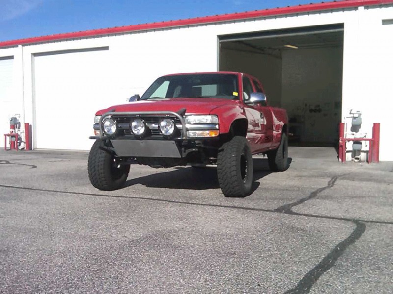

Hey guys? Just out of curiosity... Has anyone built a "light weight" front bumper like on a pre-runner or trophy truck? I've seen a them on older vehicles and a few on newer trucks but I've never seen a tb or envoy with one. I tried searching the site and turned up nothing.
This might be a project in the future if no one has done it yet. I'd be interested to see what they look like.
Thinking something like this...

There have been various custom bumpers created by some of our members. About the closest to what you're showing was probably Teebes' jeep bumper that he adapted.

Teebe's jk bumper looks good, pretty much what I'm wanting. But I'm worried about weight...

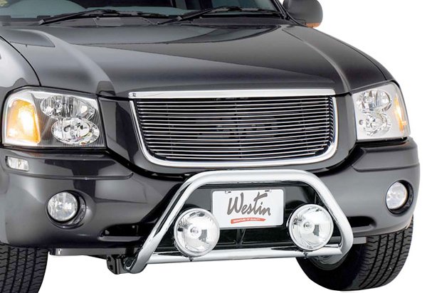

I'm not a fan of the brush guards on these trucks, but I do like the Westin Safari bar...just wish it was taller...maybe I could alter it.

those are the ones warned about above. they mount to your radiator mount, and lower your approach anlge.

Hmm. The install vid on YouTube shows it being mounted in place of the tow hooks on a Silverado.
Guess I'll just have to make my own then, or buy a brush guard with out the headlight bars...those are ugly as hell imo.

AZ2wdEnvoy wrote:Hmm. The install vid on YouTube shows it being mounted in place of the tow hooks on a Silverado.
On our platform, everything like that made for us mounts to the radiator mounts.
