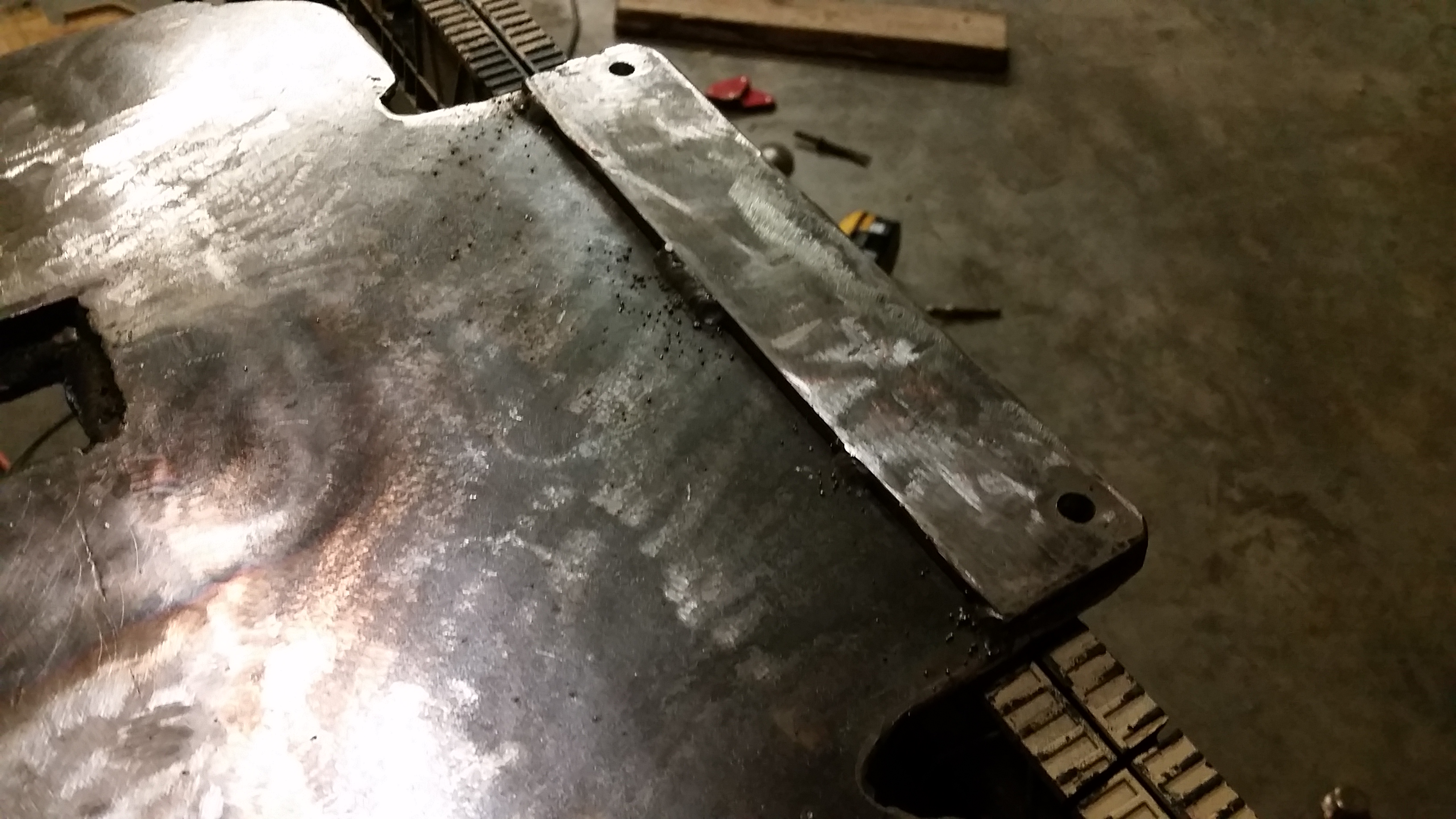

After making that, I've had a big "L" shaped sheet of steel leftover (like the one below). Yesterday I must have lost my marbles, because I decided to make an oilpan skid out of it.
You can see that I did't have the right shape sheet of metal to make the skid, so I cut off the top part of the "L" and welded it back onto the right side to fill in the gap and make a big enough square sheet. Yes, I know thats not as strong as a raw sheet and I run the risk of it warping, but I had the extra metal, and I like saving money, AND I needed the practice, so why not?

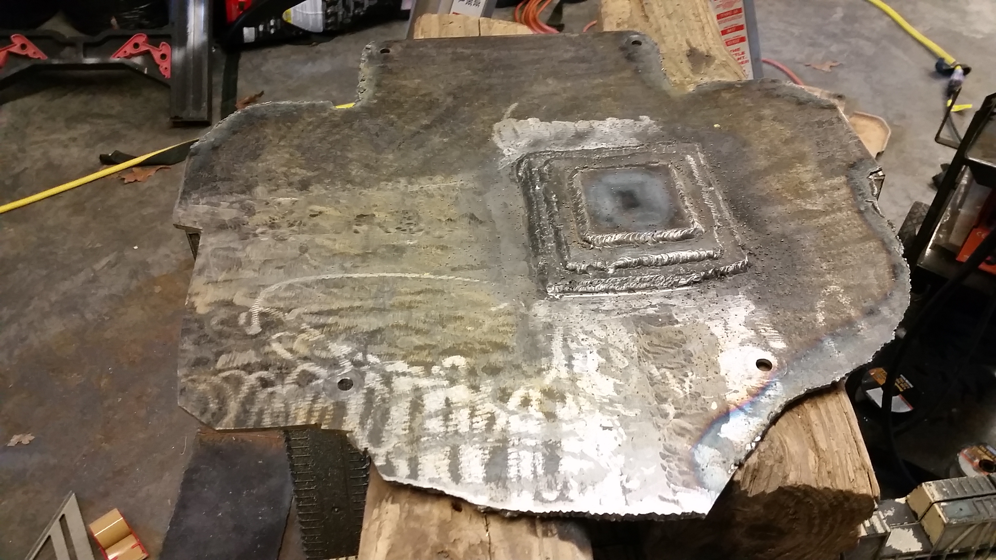

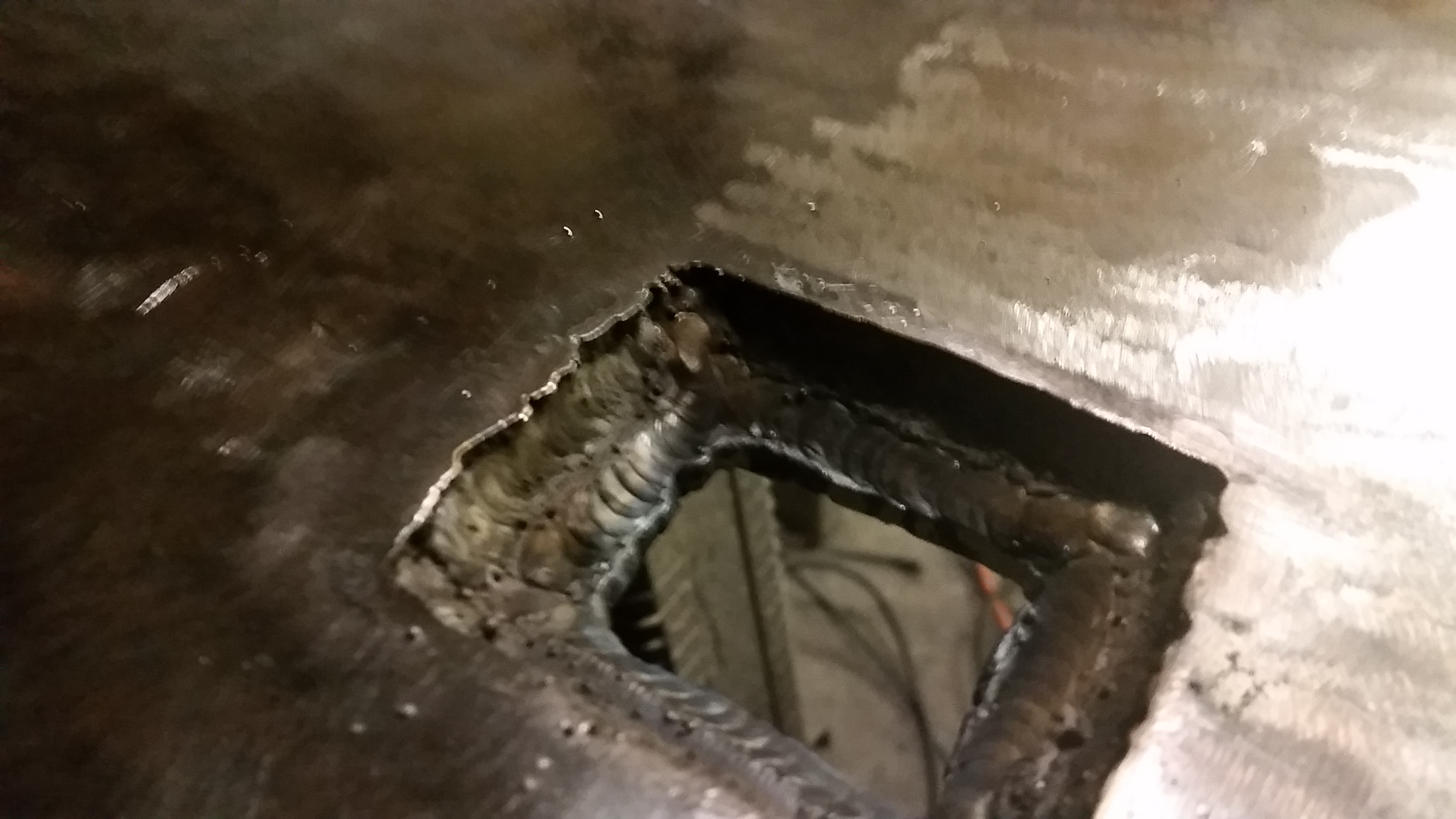

I laid the stock skid down on the sheet, traced it out, and marked where the drain plug was. Torched the whole thing out, and started trying to figure out how to make the dropdown for the drain plug. Basically just started copying every other oil skid you have seen for a trailvoy, and started layering strips into squares like nesting dolls, making a sort of pyramid. I finished the first layer tonight and I'll do more tomorrow.
I'm nowhere near done with it either. It's not even smoothed on the edges yet. I know its messy, but I'm really proud of it so far! I'm pretty much a noob when it comes to all of this, so I think its looking pretty good considering that.
