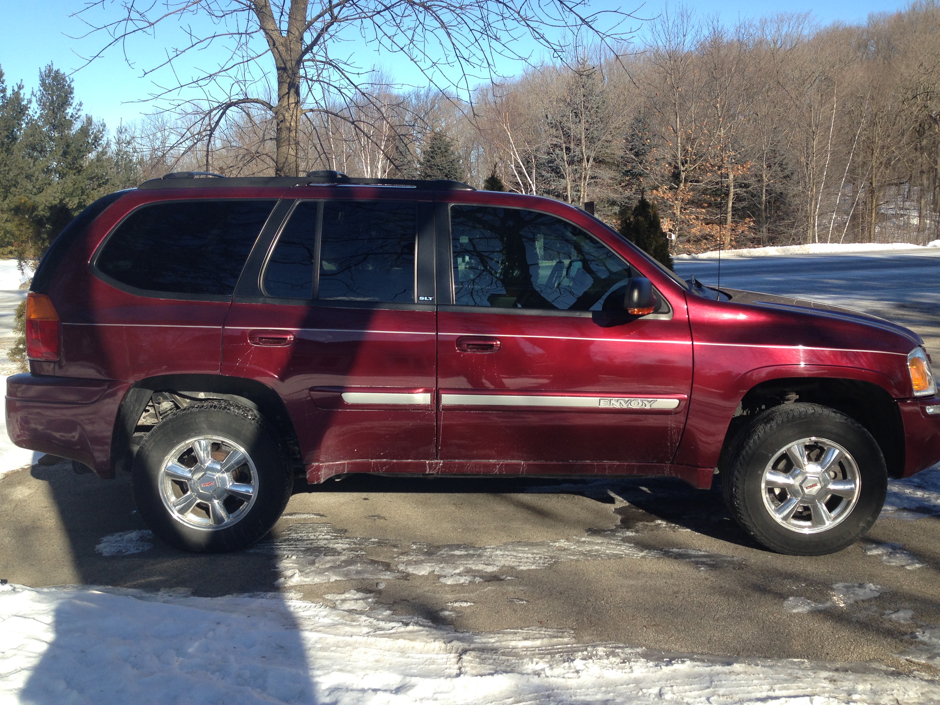

Hey all! Rockin' an '03 Envoy SLT. She's a great truck. I just installed the RC 2" lift. I looks great but I'm getting the front CV axle binding. I've been reading countless articles of people who've had the same issues but no one seems to ever have the for sure answer. Hoping for some luck here! Thanks!
