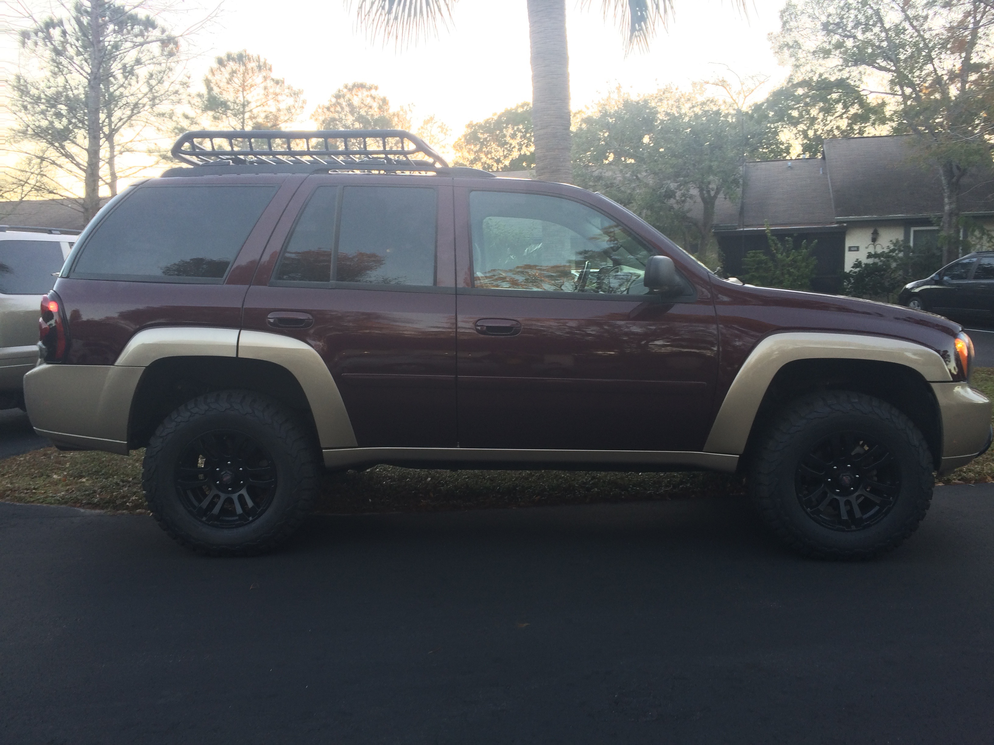

by Brendon » Sun Feb 14, 2016 2:58 am
I went with the 81112's and 81069 and ended up with a 1" rear spacer and 2.5" front. I'm really happy with the results and love the ride quality. Here she is:
