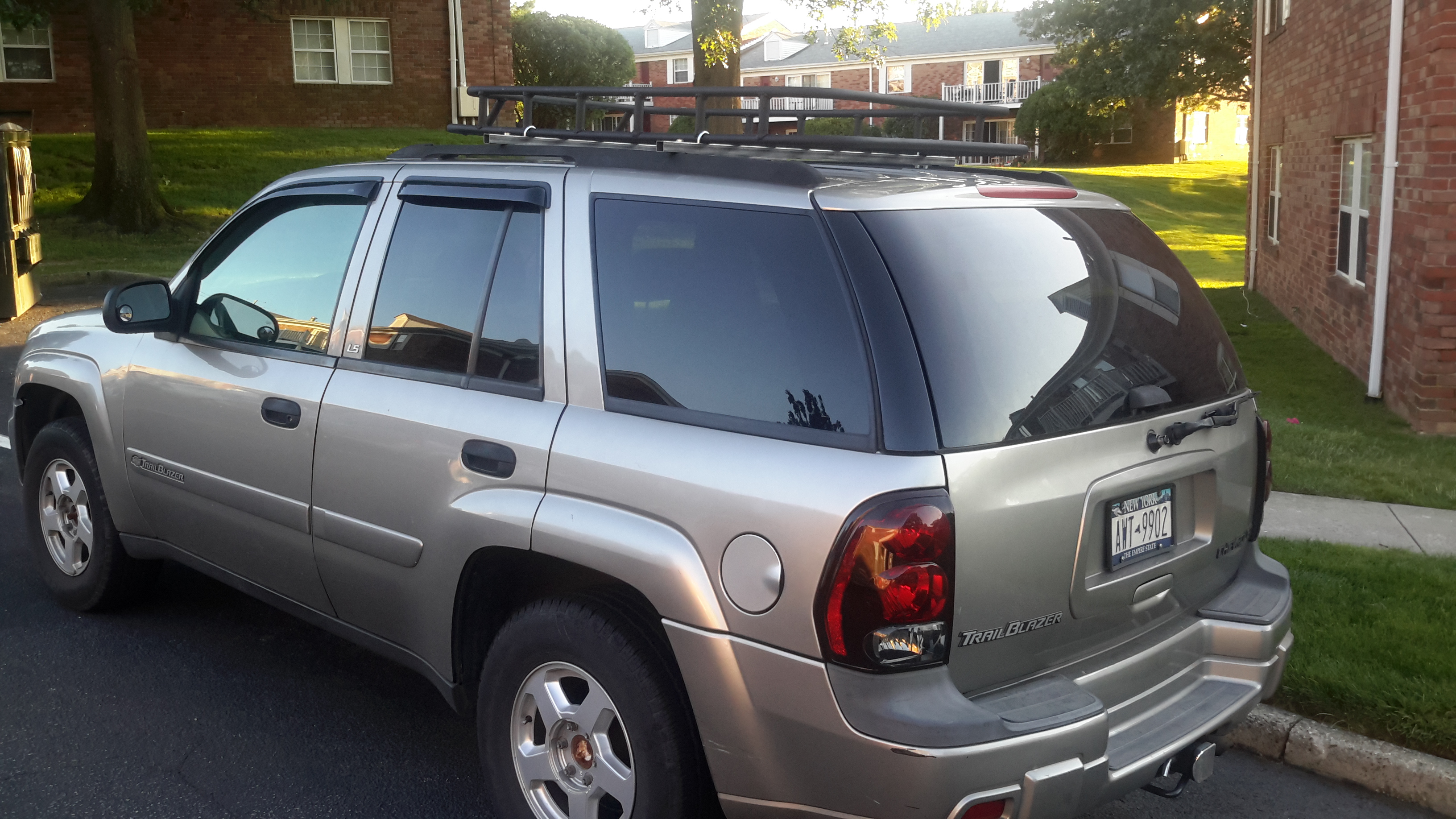

I also tried my hand at a roof rack. I'm an electrician, and novice welder at best. I bent up some EMT rings, cut some vertical stanchions, welded a front air valance and sone vertical plates for lights... sprayed it with some black hammer finish Rusto and I think it's not too bad.

by Trail X » Mon Oct 26, 2015 5:09 pm
The rack looks real good James. How did you mount it to the roof and to your cross bars?

TrailX- The roof rack was secured using 3/8" kindorf nuts (that actually are made to fit inside the kindorf strut that I believe you used to mount your half rack and tent to your roof). Their rectangular shape allowed me to fit the nut inside our stock "C-channel" rails and then spin them long ways to tighten down a piece 1"x1" steel square stock. Pipe clamps secure the rack itself to the stock. It's a little hard to see while installed but I'll take pic of just the nut and bolt. The assembly clamps down very tight and is not going anywhere.

The rack also has a little more to it... If you notice, there are three pieces of 1" stock with flat Furniture caps on them; these hold the rack to the roof. The two pieces with round outter furniture caps have a 3/4" sq. And 1/2 sq. stock within them. I drilled through all three pieces with a 1/4" bit and inserted a threaded turn knob with a plastic washer, and wing nut underneath to keep inner pieces from sliding out on the road (wing nut also keeps it within the channel.

The metal is just shy of 4' so if I extended the 3/4" and 1/2" out fully, I'm a little over 7' of coverage. I keep two 10x10 tarps on board. One covers the extensions, the other I drape and tie off over the tailgate....
