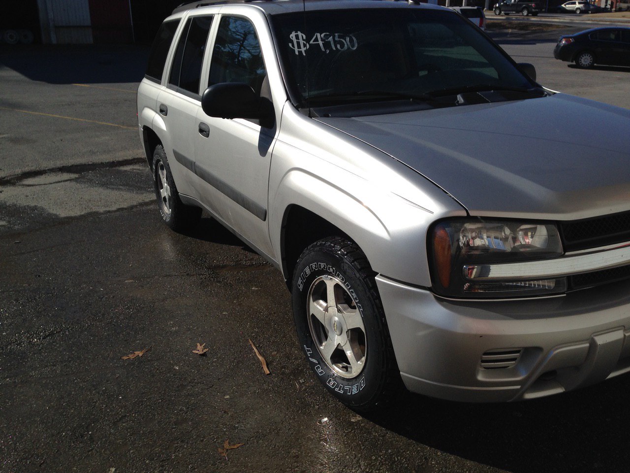

This was right before driving off the lot
New 245 Delta A/Ts on the way home from lot

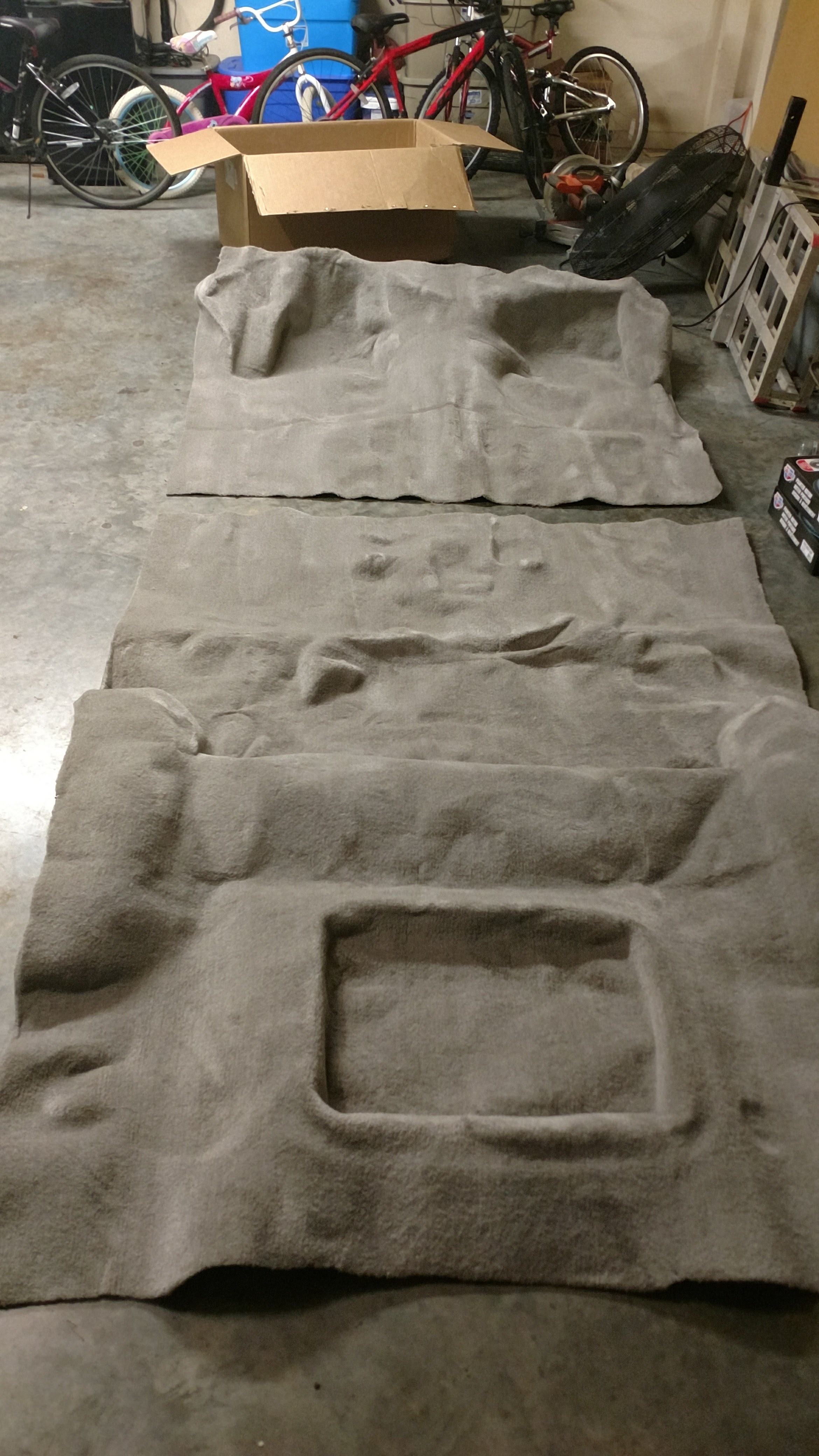

Next, gutted out interior and did some major cleaning. The previous owner wasn't vert clean lol

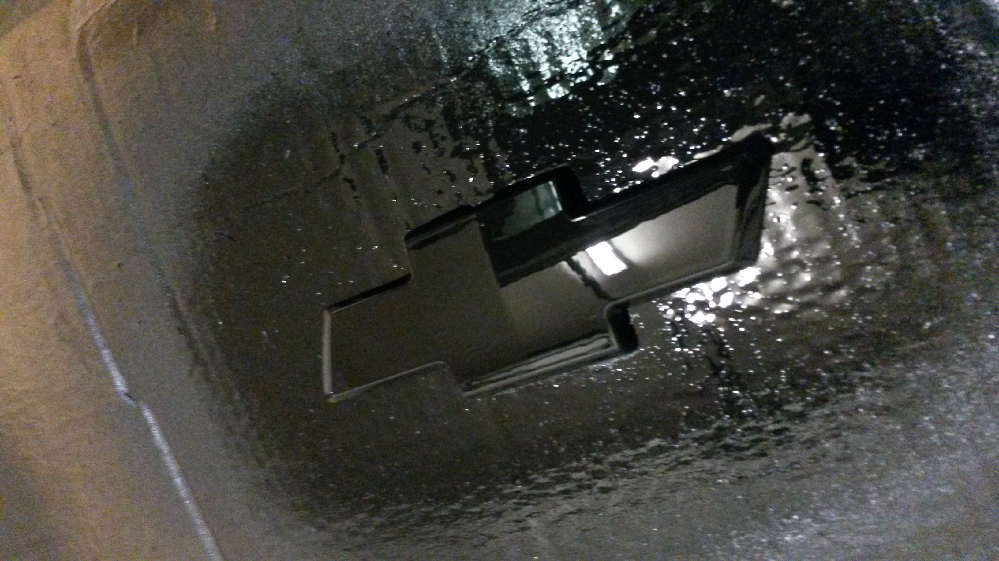

Painted the bowtie for some accent

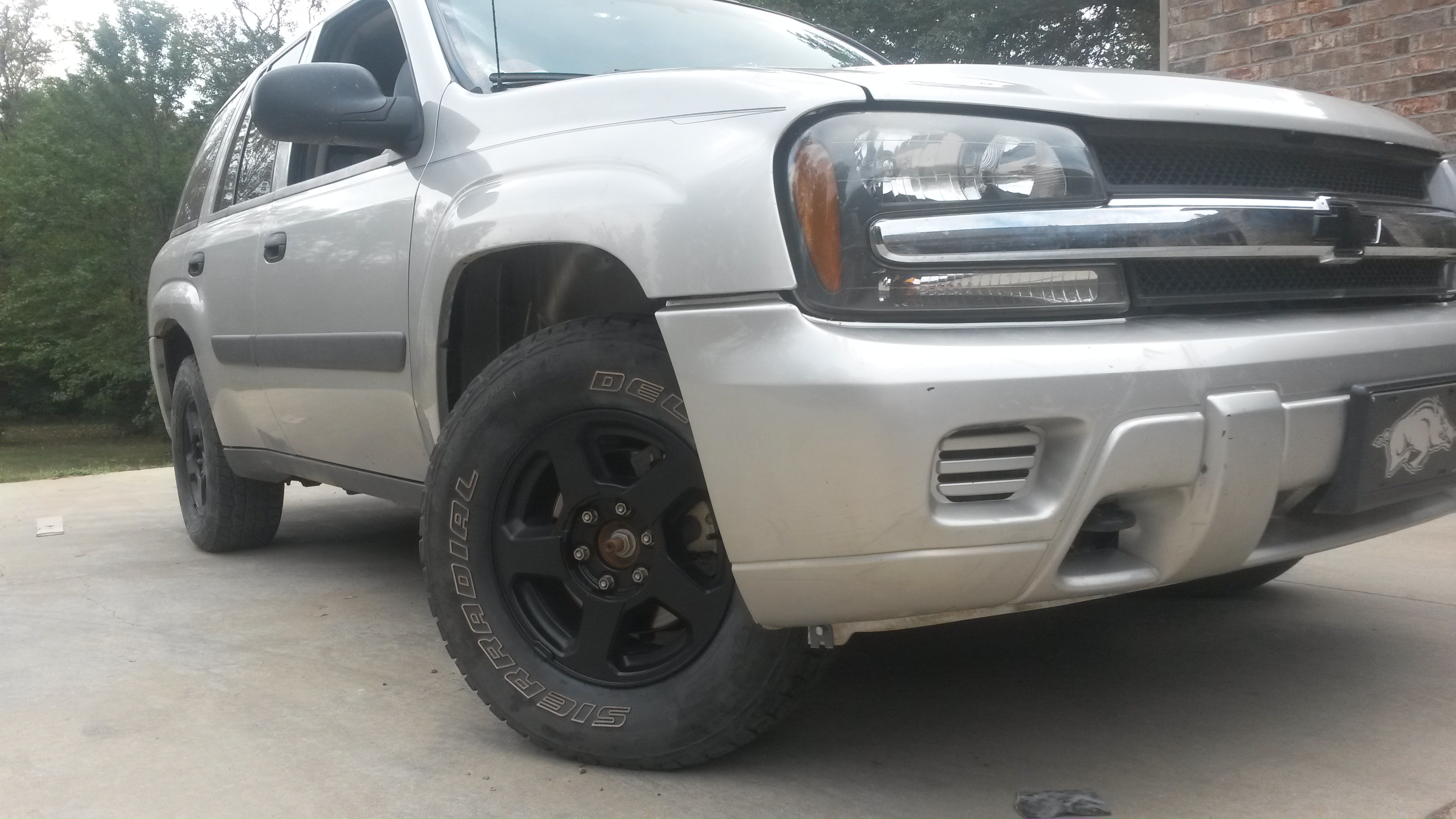

by mason10198 » Tue Sep 29, 2015 9:46 am
Painted my rims and center pop-covers black. .

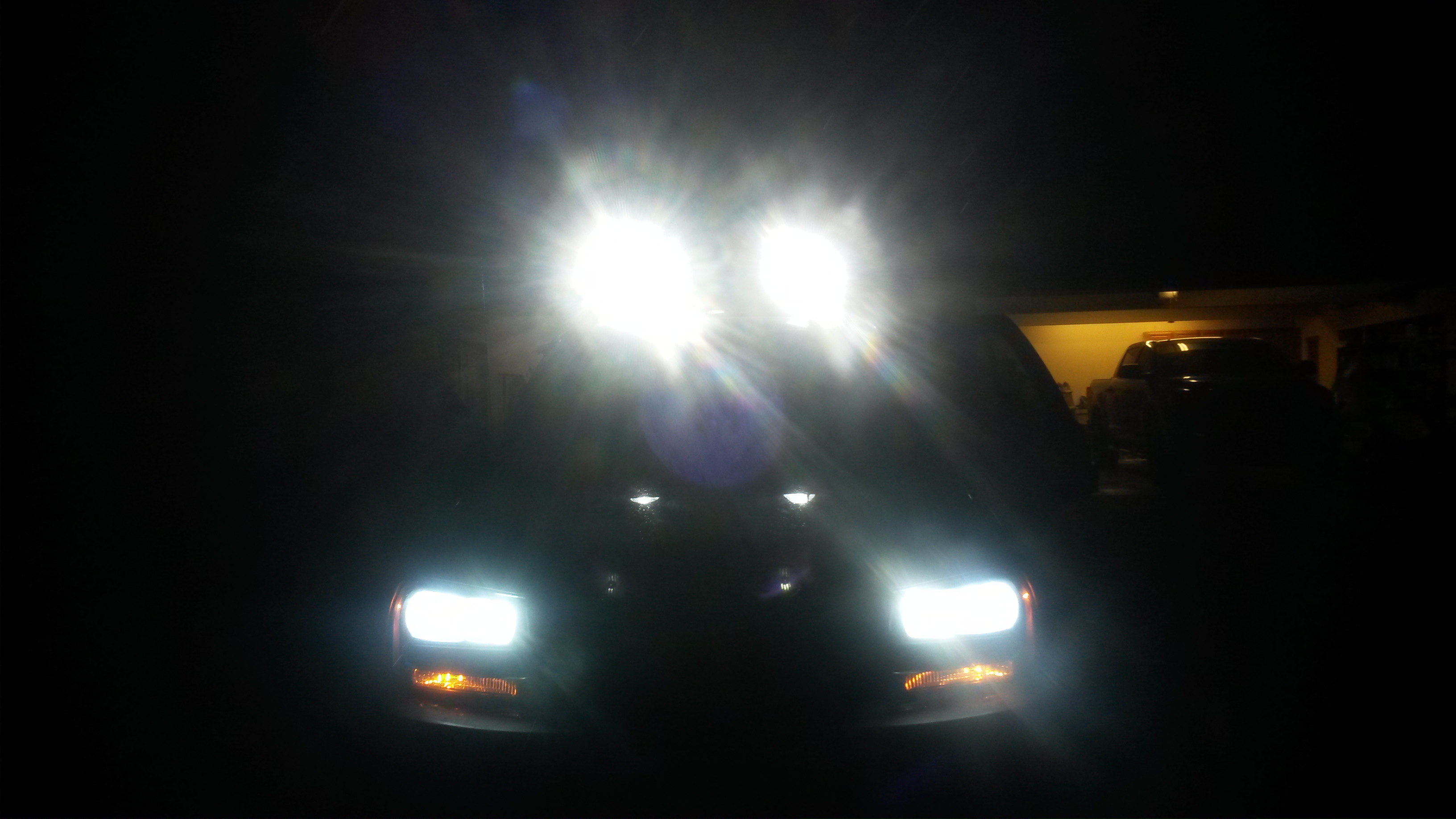

Mounted two 7in. HID wide beam spotlights to the existing OEM crossbar. These things were cheap, but they are huge and have a nice beam pattern. they focus the light beams while also extending the range (width) of your vision.

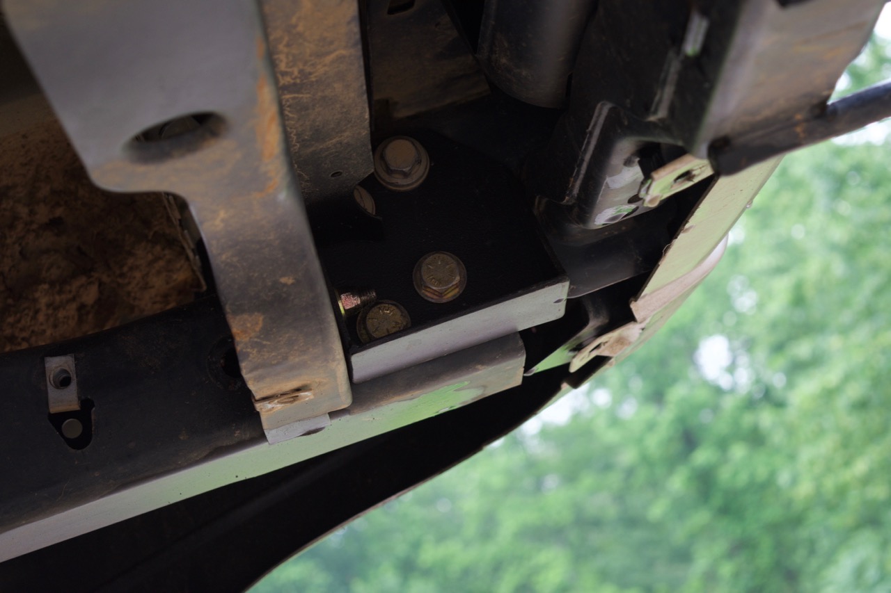

Built a homemade replica of MDBs oilpan skid and got it bolted up no problems.

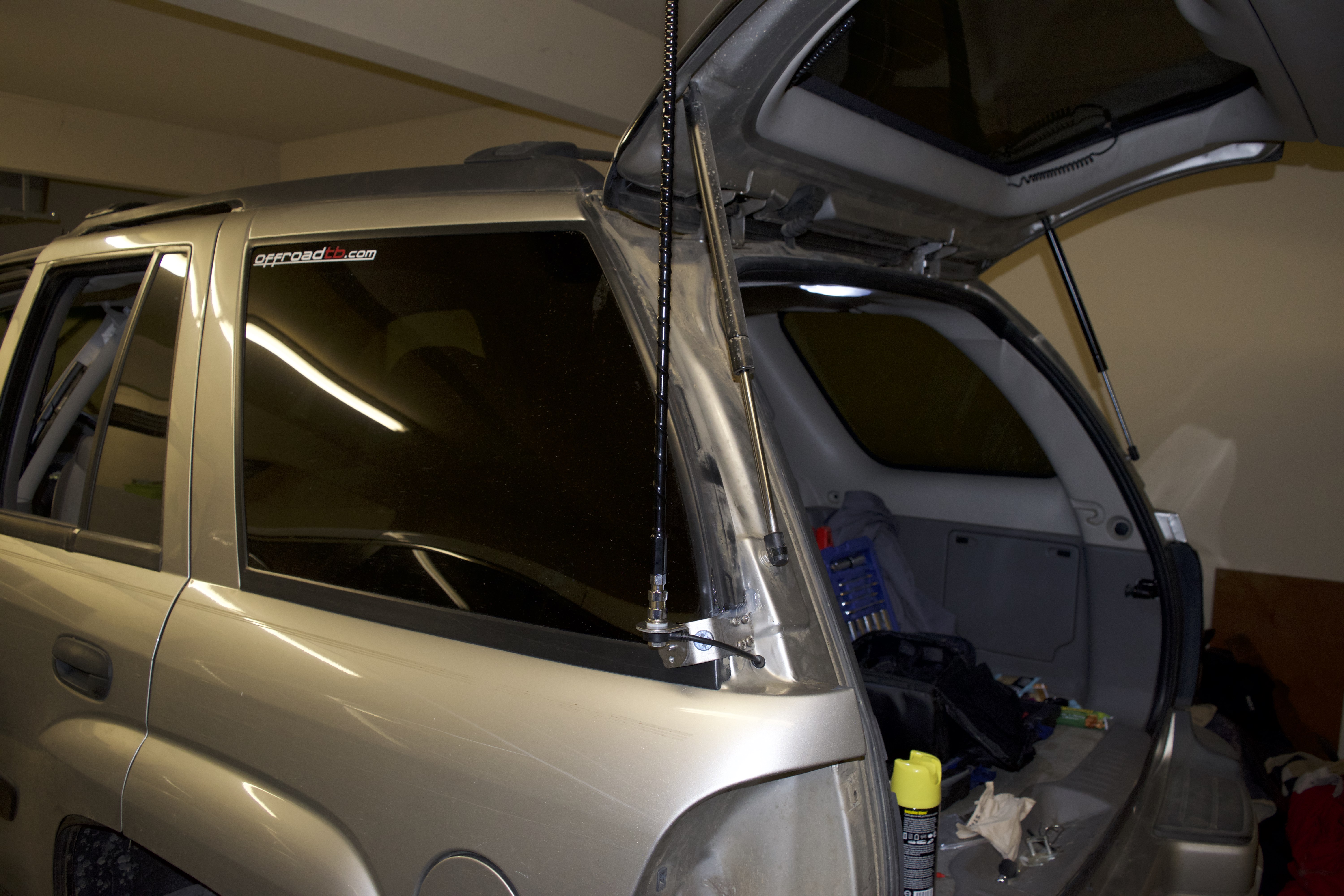

Also... got a brand new CB unit!! :excited: Bought a Cobra 29LX from amazon on a great warehouse deal. Almost half off just for damaged package! Unit had nothing wrong with it whatsoever. Anywho, bought the unit, a 3' Firestik II, and a Firestik door jab mount with 18' fire ring cable. Mounted the firestik behind the rear window above taillight on the drivers side, and it's been working great there. Drilled a hole in the body (ouch!..) and ran the antenna cable up and through the roof support frame, away from other wires to reduce interference and increase performance. Also went ahead and bought a cheap Pyle PA horn since the CB has a PA function, and mounted in to the side of the battery cover under the hood. Its not super loud but good enough to hear clear with engine running. Not amazing, but pretty good for a 12 dollar horn.

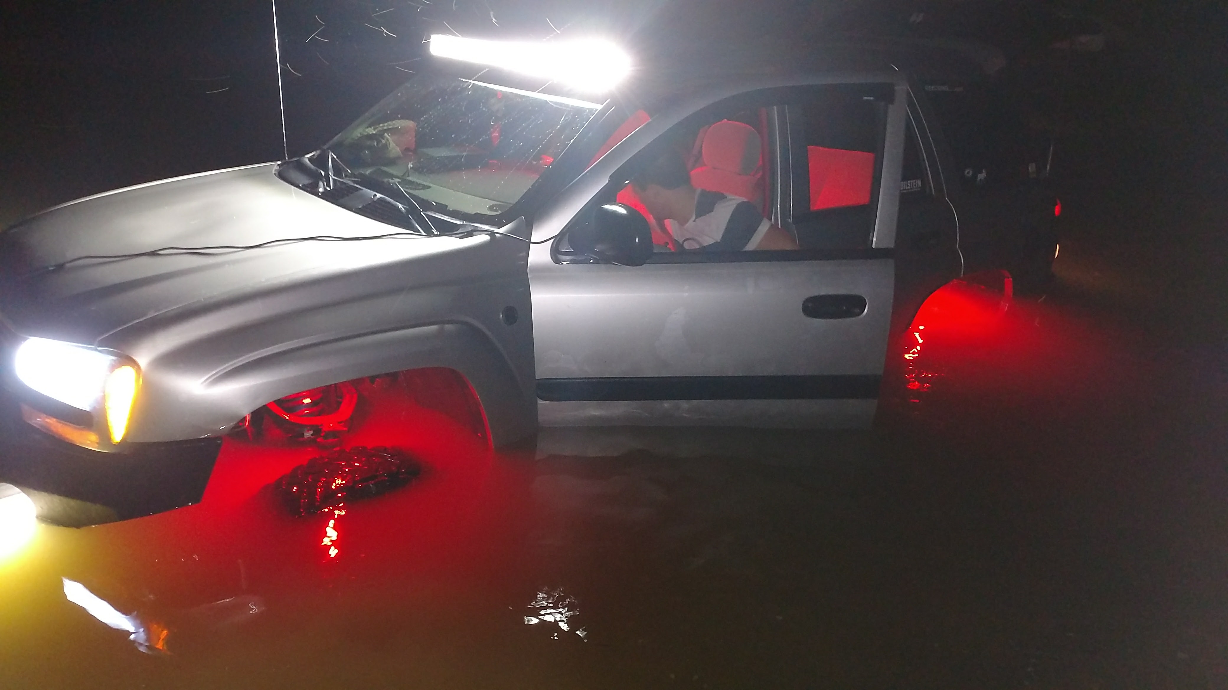

I blew the motor while offroading by going in some water that was WAY too deep.... stupid right?

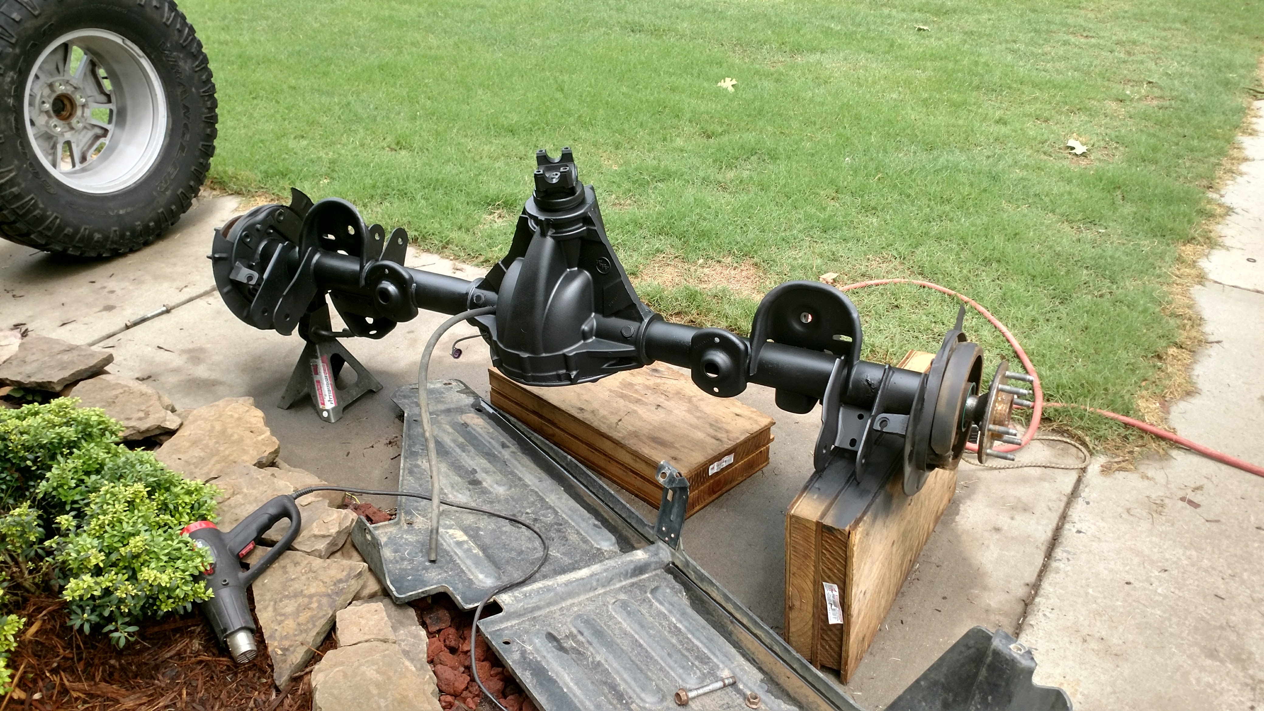

Complete rebuild. New engine, new transmission, new front and rear diffs/axles, new interior carpet, lots of replaced parts.
Unfortunately, I'm way too lazy to even attempt to talk about everything I did up until the end of the rebuild. Instead, I will forward you to the original rebuild thread, and include a couple of pictures. All of my pictures can be found in my TB album. You can find a link to that album at the very top of this thread, right above the latest pic of the rig.
