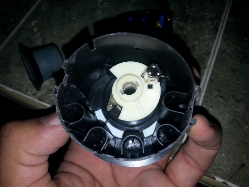

When finally I get the switch I proceed to remove and open the switch to see the problem.

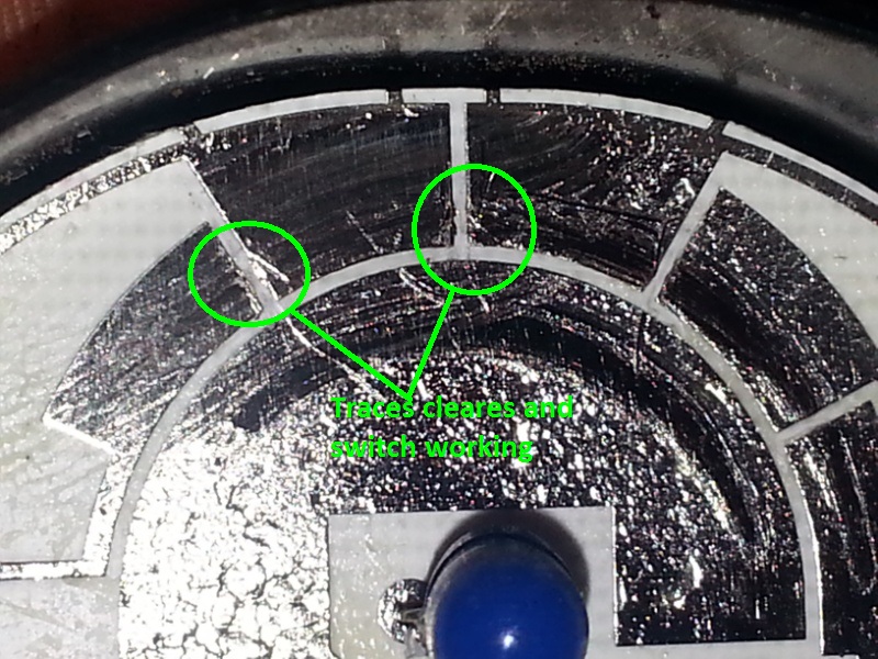

I found the traces in the switch were in short some positions and that was the reason for that the switch always remain in only one position.
the pics are in the reverse order but shows that was the problem.
9. solution traces cleared and save money.
8. solution traces cleared
7. Solution Traces cleared short removed
6. traces with short
5. traces with short
4. switch open 2
3. switch open
2. carefully push the locks to open slowly the switch

I assume this repair worked. Im glad it worked for you. Your explanation and photos illustrate your repair well. The switches are not expensive near me. We have members in areas that parts are expensive and the switches are a known weak spot. So thank you!
by Trail X » Mon Jun 29, 2015 10:58 am
Great job Jorge. I always love to see people finding the root cause of their problems! Congrats on a nice cheap fix.

Out of curiosity, how did you remove the shorted sections?

Jorge, great find! Was there any dietetic grease in there? If not did you happen to add some? The dark material between the traces is carbon and bits of metal cause from wear and arcing when switching. Dietetic grease should eliminate the problem by helping to lubricating the switch. Cheap GM! What would something like this cost in Mexico?
