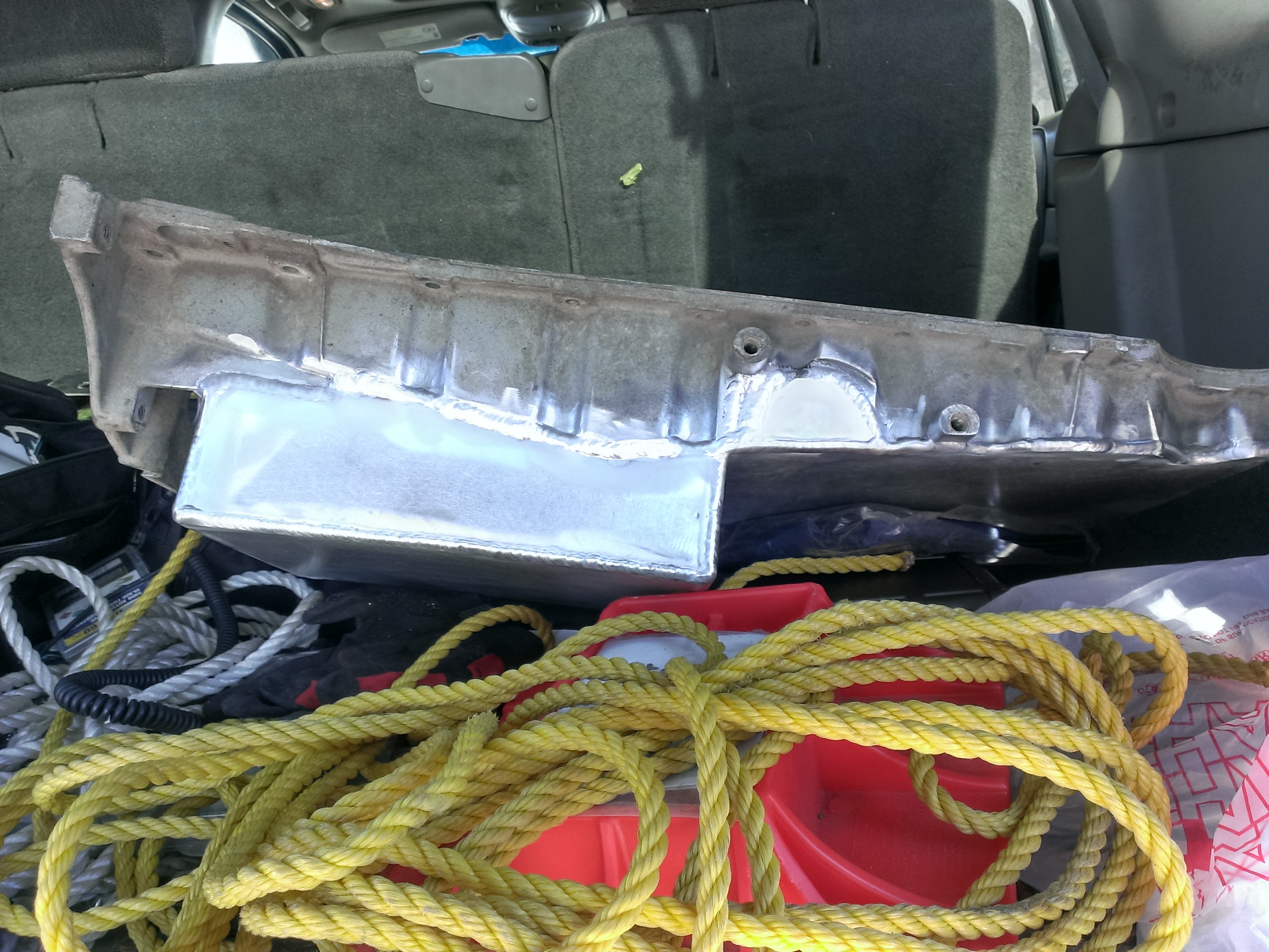

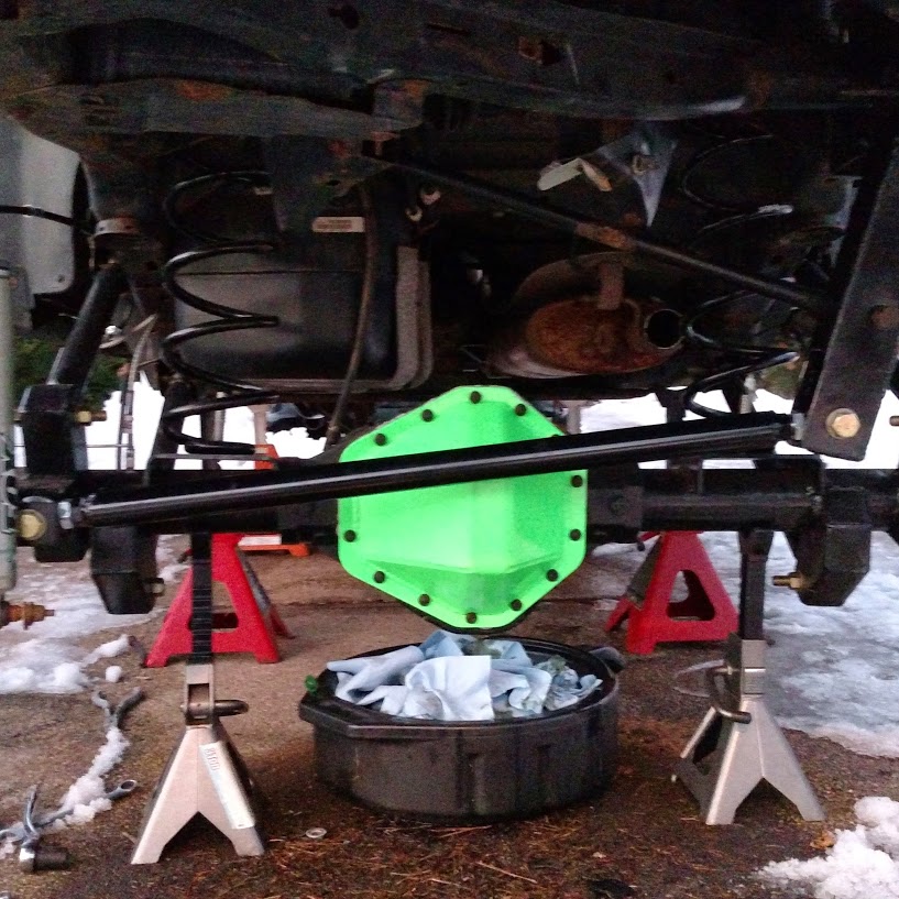

rear sump pan
then the front diff was put up in place to see where it would fit, the first of many many many times it would go in and come out

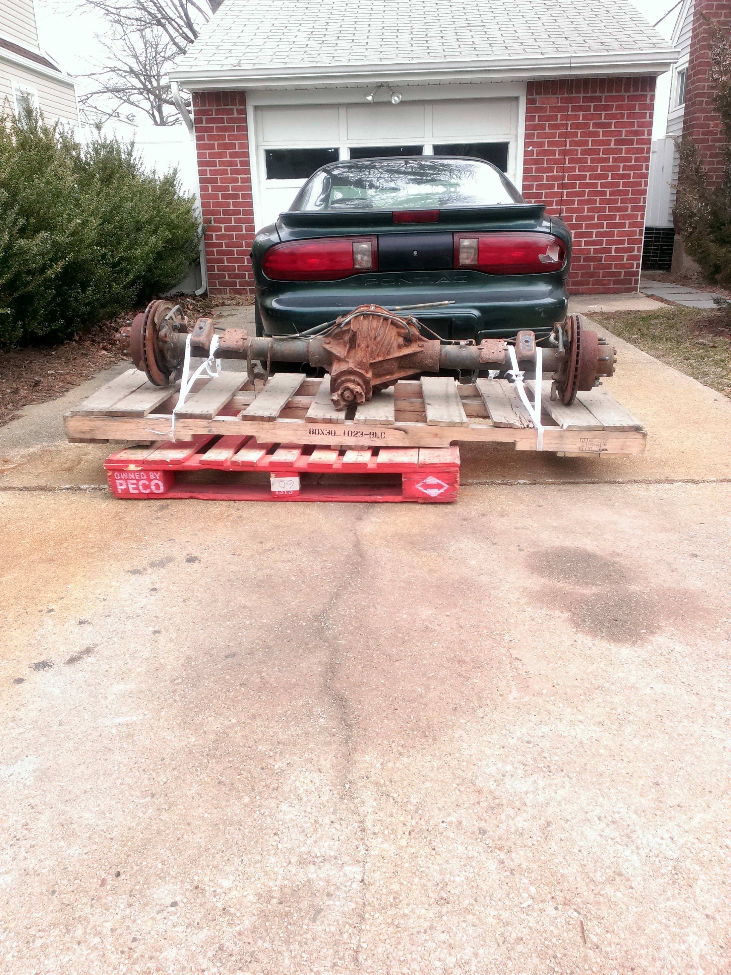

a mix of some of the parts going in this thing.
lower a arm heim joint misalignment spacer
2014-02-19 (1).jpg (17 KiB) Viewed 43163 times
uniball cup that'll replace the balljoint
14 bolt rear axle from a 2500HD silverado
37" humvee wheels and tires
2014-04-10 (1).jpg (12.9 KiB) Viewed 43163 times
misc heim joints

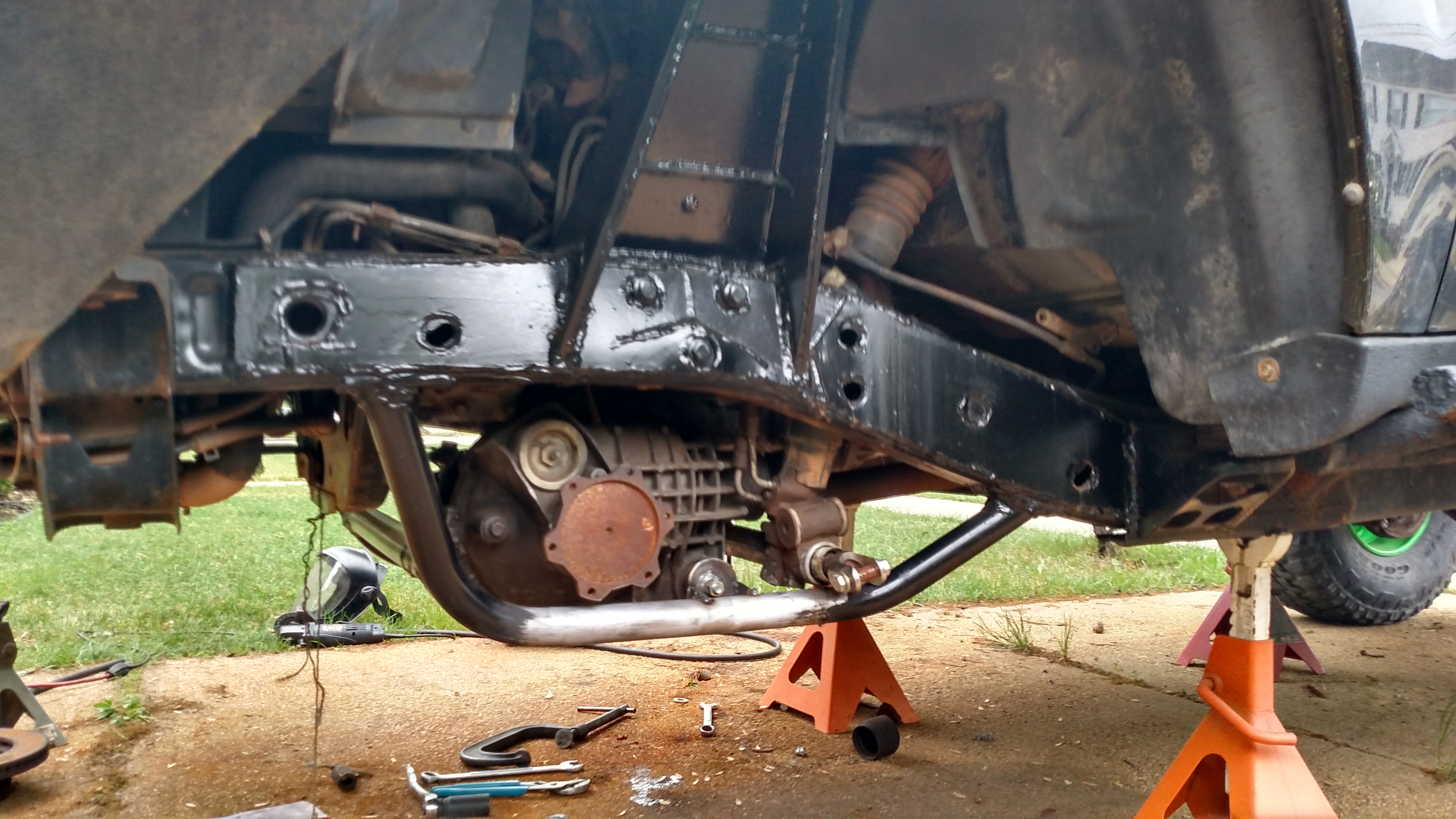

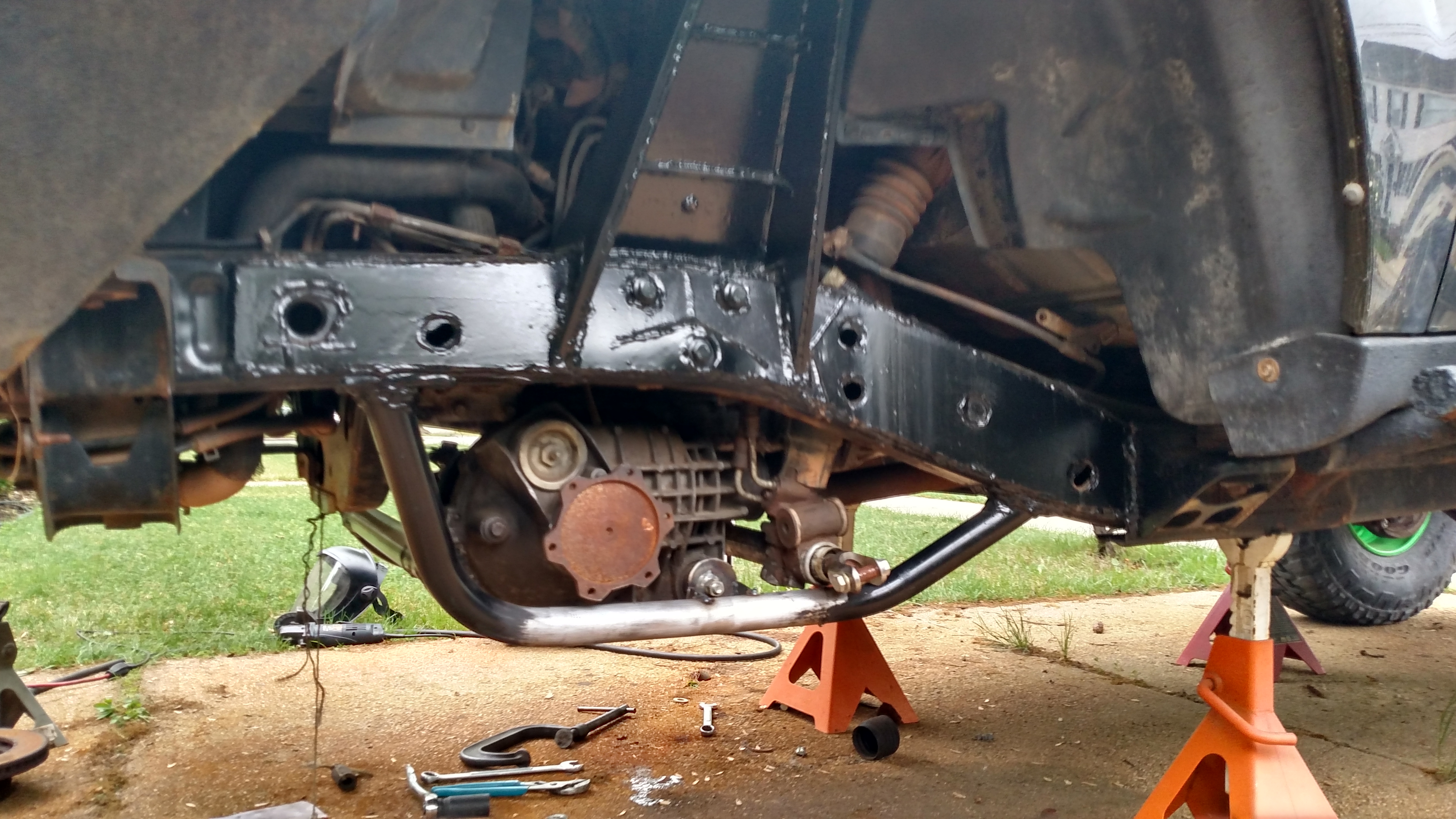

Eventually I got the wheels powdercoated, assembled them with James02, and aired them up without issue, tossed some airsoft beads in em for balance. Bent up some subframe tubes, made some diff brackets for the front diff and the rear axle too. Ended up using some brake lines from a 3500 silverado with a 6" lift and adapted them to the trailblazer lines.
big ole pinion
brackets and brackets
powdercoat
subframe tubes
subframe tubes

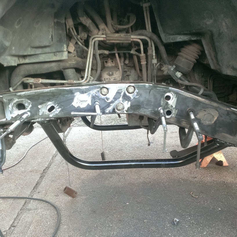

subframe tubes in
PHR bracket
PHR bracket

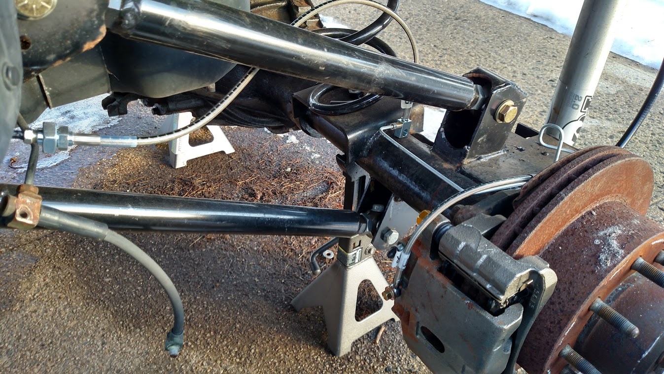

axle in and brake lines ran

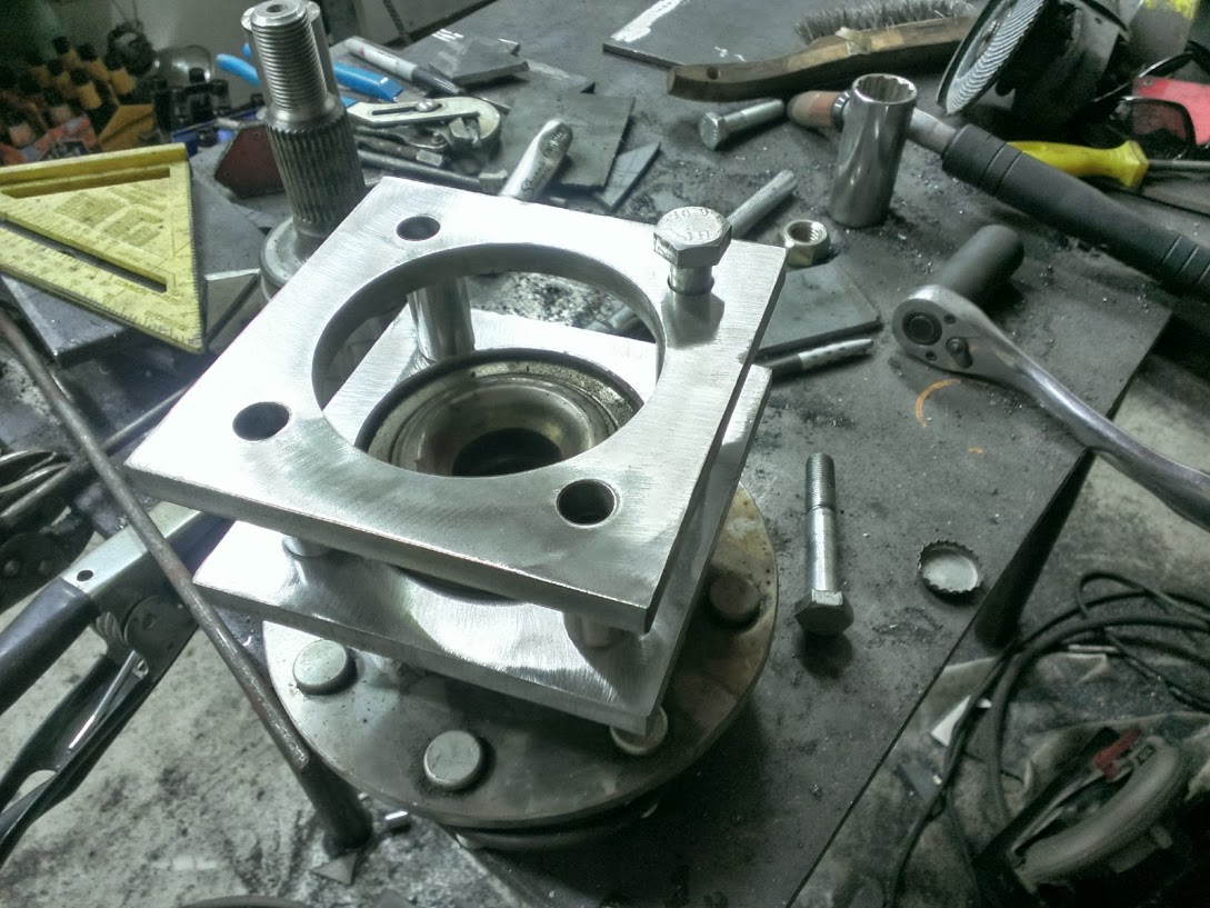

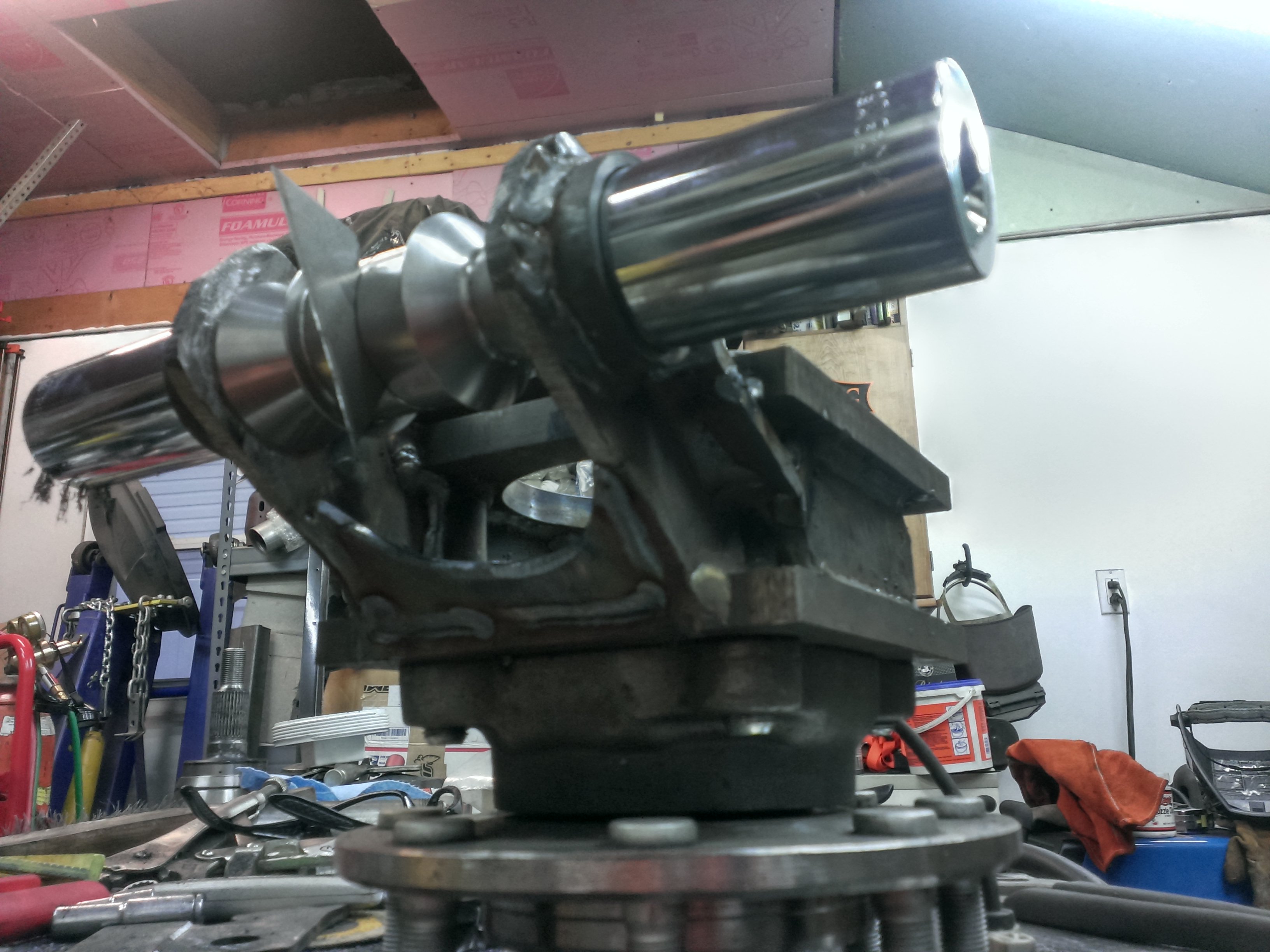

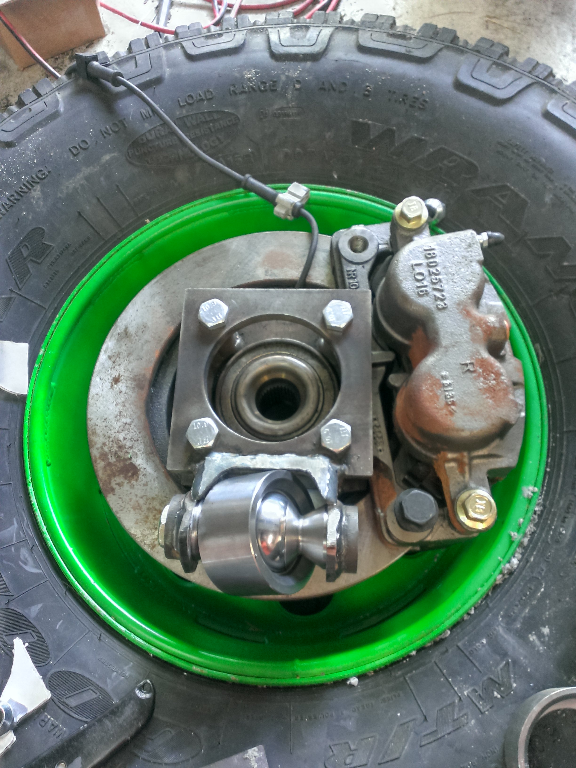

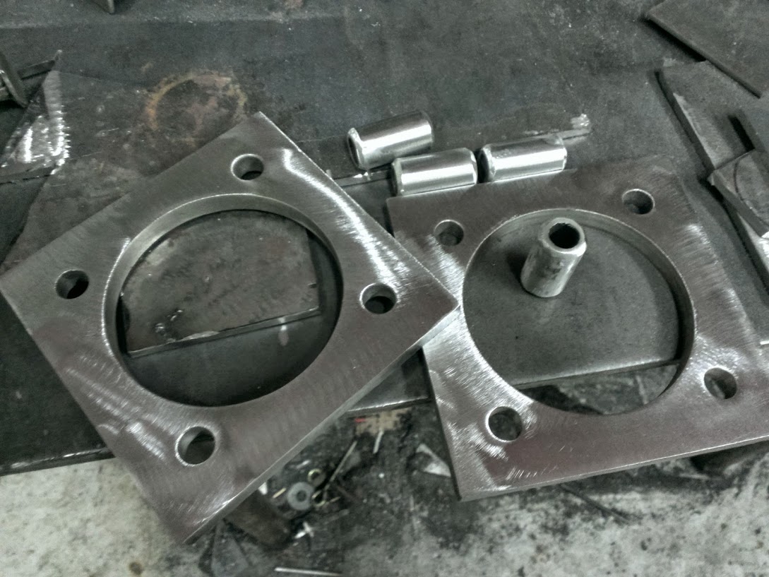

There wasn't anything I could find that would fit the design, so I ended up building my own spindles that let a 3500 hub bolt to it.
parts
bolted together
2014-09-26 (1).jpg (13.64 KiB) Viewed 43162 times
clearance

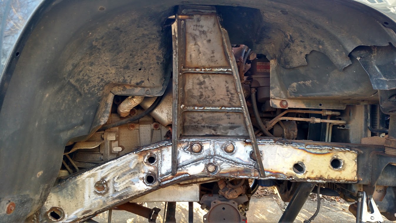

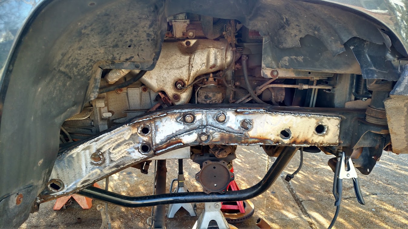

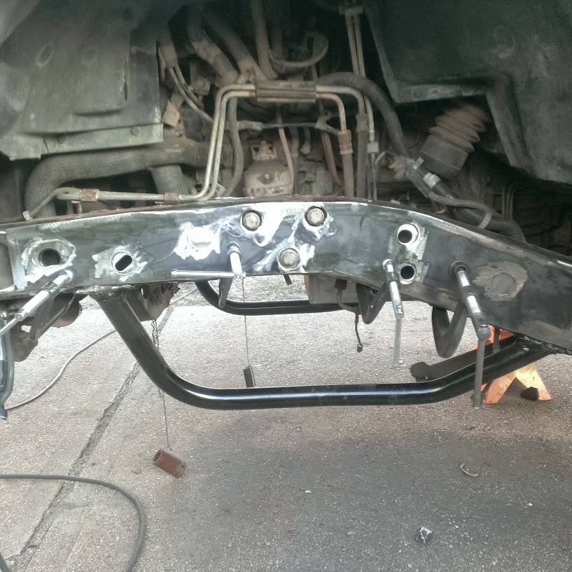

From there the frame needed plated and some shock towers needed to be built.
2015-01-02 (2).jpg (13.02 KiB) Viewed 43162 times
2014-12-31 (1).jpg (17.2 KiB) Viewed 43162 times

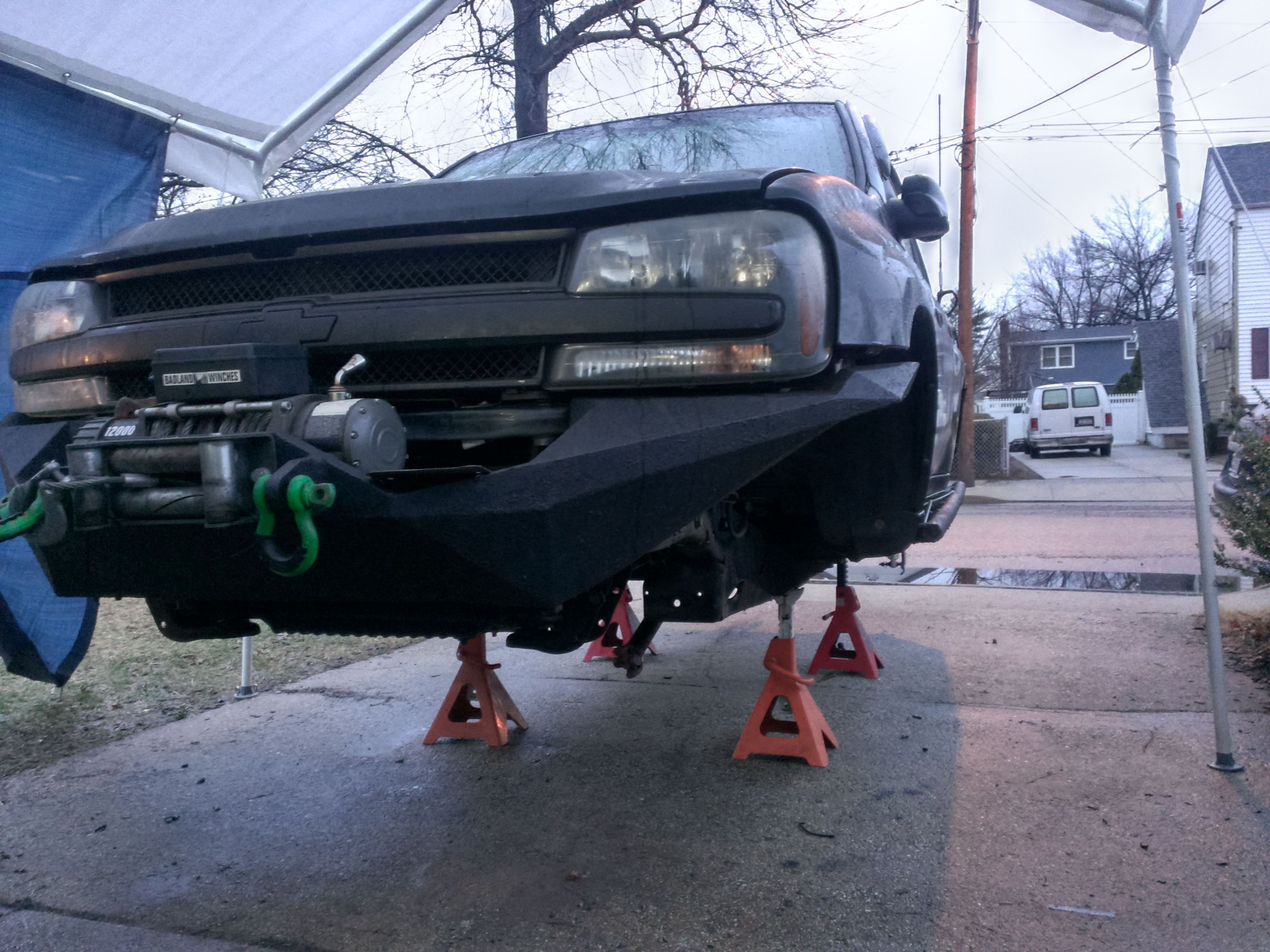

by v7guy » Tue May 19, 2015 1:52 am

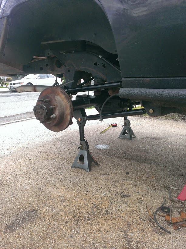

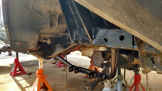

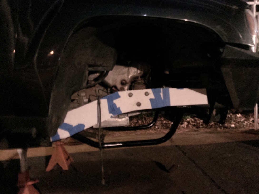

Front diff bolted in, steering rack roughly in place and a few misc pics

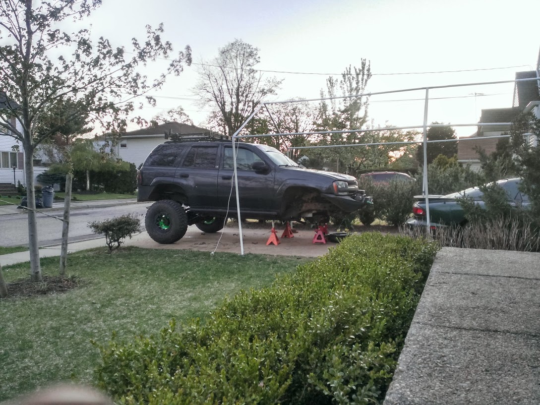

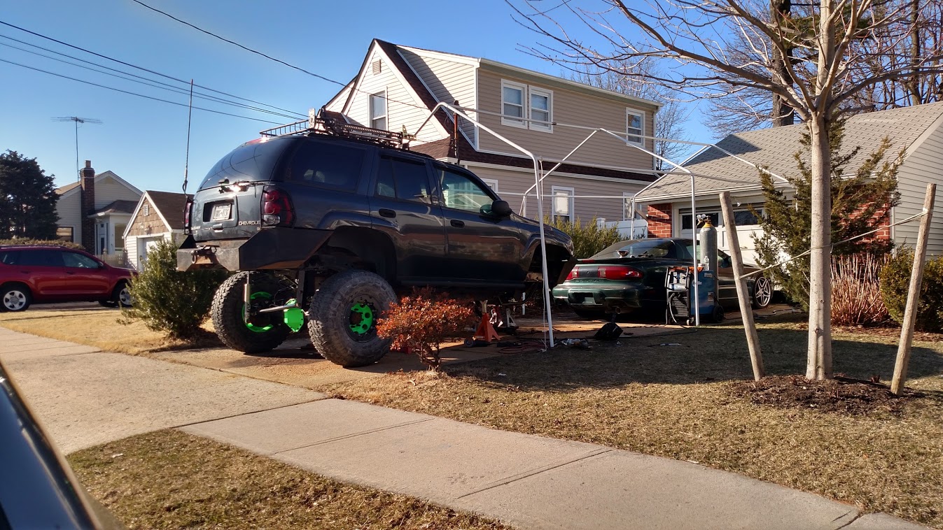

Is the final picture the planned resting height of this thing?
by v7guy » Tue May 19, 2015 3:35 pm
I've gotta find some springs to drop the ass end a bit or buy some coilovers... probably shoulda done coilovers from the get go. At the highest point (hi lift on the roof basket) it's about 7' 8", I think I can get it real close to 7'. There's already a few items I would do differently if I were to tackle this again. But that's kinda the case with any build I think.

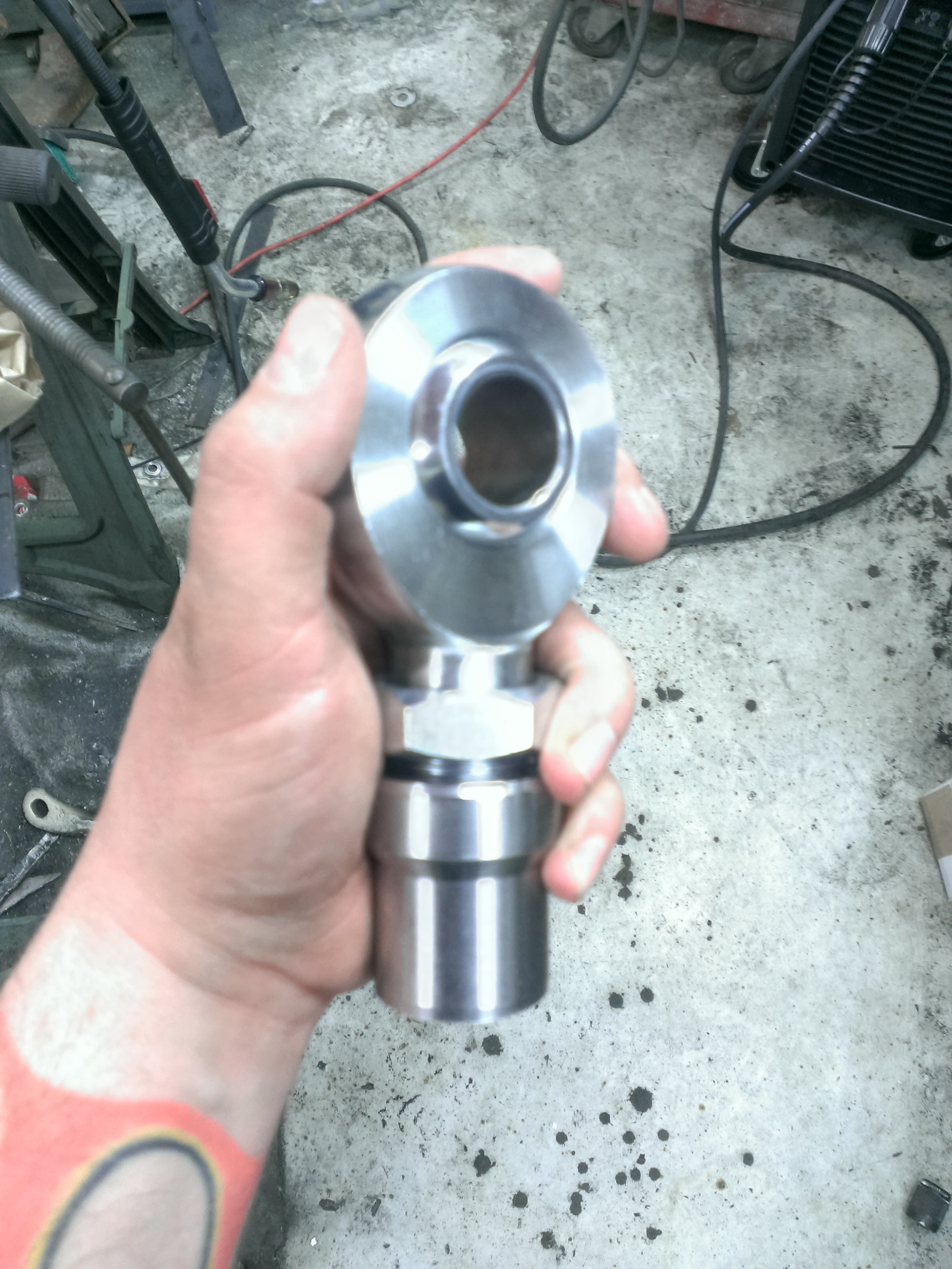

by v7guy » Tue May 26, 2015 10:34 pm
Got some time to start working on the upper A arm brackets, lil spacer put next to the misalignments to make sure it stays wide enough after welding. Also had an epiphany that I could use a hole saw to cut the rounded space for the rod end, dunno why it never occurred to me before. Looking forward to welding em on the frame tomorrow.
by Trail X » Tue May 26, 2015 10:51 pm
Nice stress transition with that hole saw cutout. Shouldn't see any stress concentrators there. Out of curiosity, what grade steel are you using? Assume you're using 70ksi welding wire?
