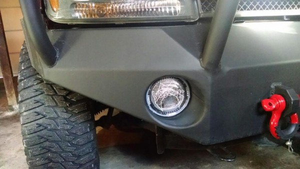

light wise, these have a very nice output and the covers change the beam patten very well.
They also fit exactly in the 5" bumper holes. These will work and look great as long as i don't get a bad center shadow from the recessed holes.
There are some issues with my install and these lights in general.
since the fit in the holes is so tight, i won't be able to remove or change the covers without pulling the light. this isn't a huge issue as i don't plan on changing the lens often.
the bigger issue is the mounting. the lenses only have 3 tabs so you can't have the covers face the right way and under mount them. this isn't just an issue with the logo being upside down, the lens changes the beam patten so they should be mounted correctly. i will have to see what i can fab up for the mounting bracket.

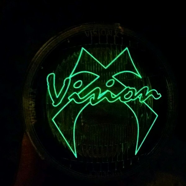

the glowing logo on the lights looks kinda cool. not really my thing but not a deal breaker

They look good. Looks like you got them oriented the correct way. Is the glowing logo something on the cover? Do you have to use the cover? I'd like to see some comparison shots with the various covers in place. Glad they fit.

I don't think these will be going in the bumper holes. I will likely be mounting these on the top of the bumper. There are a few reasons for this..
1. there is a pretty decent shadow cast in the center of the vehicle from the recessed mounting.
2. These are nice lights and I can see getting different covers and don't want to have to remove the lights to swap them
3. mounting will be easier on top of the bumper due to the required orientation.
4. I can get some standard lights to fill the recessed bumper holes that will look good without loosing some of the key features of the light cannons.
The right tool for the right job, and these are too good to hide in a hole.
