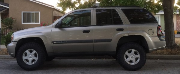

I basically want the truck to sit level. I will be towing a 8x16 enclosed trailer a few times a year across the western states. here is how it sits now

by nvrs » Thu Jul 31, 2014 6:13 pm
The lift is done with the 2" spacer and z71's. I think I'm going to leave the 2" spacer as there is no gear in the back yet and I am thinking that it will settle out.

by Trail X » Fri Aug 01, 2014 10:51 am
Looks good Lonny, that's how they SHOULD have come from the factory.

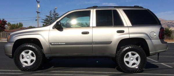

by nvrs » Sat Aug 02, 2014 1:17 am
Picked it up today... Still need to put the longer rear shocks on but it came out ok...

by nvrs » Sat Aug 02, 2014 8:39 pm
Looks like I may take the 2" block out completely... Seems like it just sits way too high in the back.

by Trail X » Sun Aug 03, 2014 2:15 pm
Looks good to me Lonny, no need to remove that block.
by nvrs » Sun Aug 03, 2014 7:25 pm
I'm just not sure... while driving, I seem to be looking at the ground. Here is the back measurement pic. 8-5/16" in the rear and 6" in the front. I may change to a 1" block or no block.

by ErikSS » Sun Aug 03, 2014 7:46 pm
I feel that for those of us who tow, having a little rake is a good thing. That way the truck sits level while towing.
How many miles did you have on the lifted truck when you took those pics? Often the springs "settle" in and your height changes a little. I've seen it take a couple hundred miles.
by nvrs » Sun Aug 03, 2014 8:08 pm
There is about 20 miles since the lift... I will be towing quite a lot with it. I have a week or so to drive it until the tranny cooler kit gets here so I will re-measure before I take it back in to put on the rear shocks(still running the stock length since the billsteins were too long or to short) and cooler.

by TBYODA » Sun Aug 03, 2014 9:37 pm
I have Z71 and 2" spacer also and measure 8" from top of tire to fender. Up front 6.5" I've had my lift on since March and the Z71 were used so I am sure they have settled.
