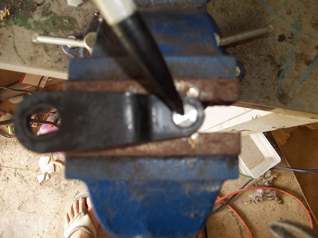

Once I removed the arm, I needed to grind the head off the back of the old stud so I could punch it out.
Once I ground the head off, I punched the stud out of the arm.
Once the stud is removed, re-attach the arm.
The instructions say to flip the arm and have the "ground" side to face the tranny pan. I tried doing that but my arm only goes on one way else it won't re-connect back to the cable. This was the only incorrect part of the instructions at least for my 2006 model.
