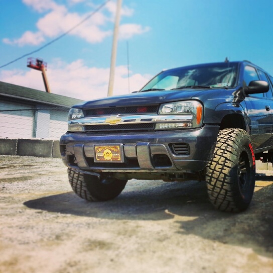

Current pic

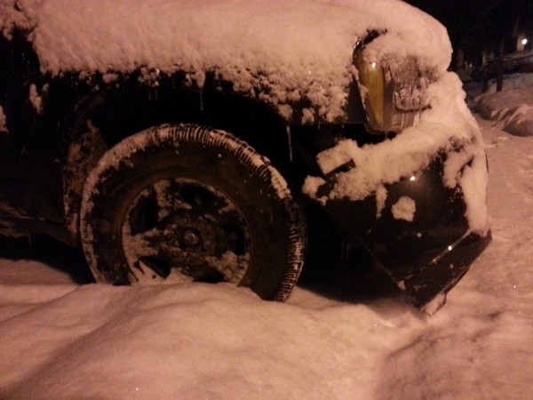

My most recent picture and why I decided to do some upgrades. Long day at work driving to my girl friends house, I started down a slight grade into her neighborhood at 5mph. By the time I got to the bottom (a T intersection) I was doing 25 and had 3 choices a parked car, a house, or a curb with a knee wall. So I picked the curb and spent the the hour pulling my tb off a wall and changing my flat in the snow. Luckily the week prior I had the spare down to change the vent purge valve, so I didnt have to deal with the spare being stuck while in the snow. So me being the type of person I am, you cant replace stock parts with stock parts. So I have spent the last 2 months researching different things on here and other sites and my journey has begun.

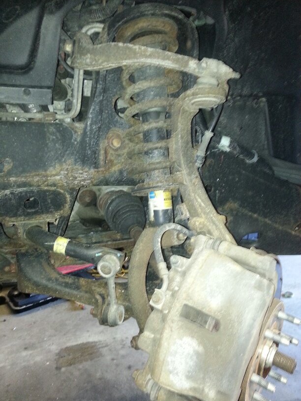

I didnt realize how much work was ahead of me at this time
Factory height
Ball joint time

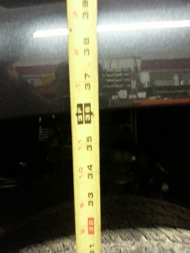

Factory ft height

Ft fender height with 3" body

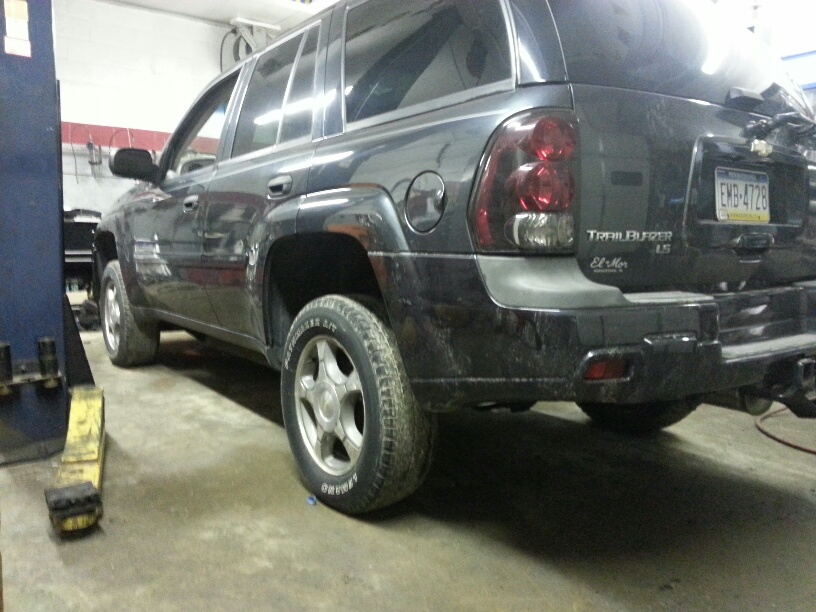

Friday night done work at 5pm time to get my 35s on
I dont think the epa would like the rubber burning

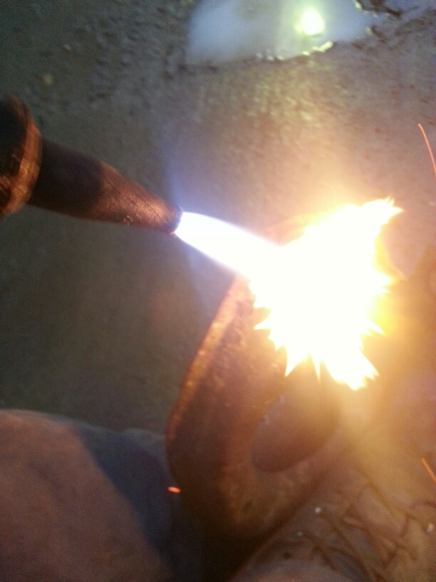

Had to burn my old bushings out for my poly bushings
Getting to work on my suspension
