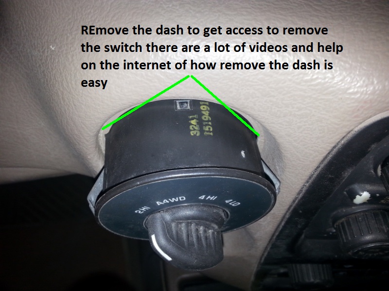

Then i decide to tear down the main panel To remove the 4x4 switch And try to fix it to save money.

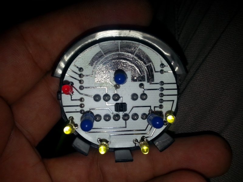

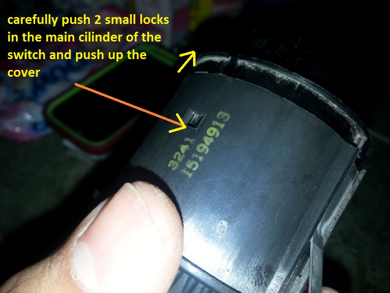

When finally I get the switch I proceed to remove and open the switch to see the problem.

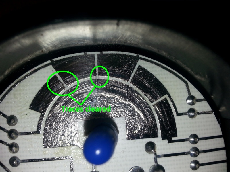

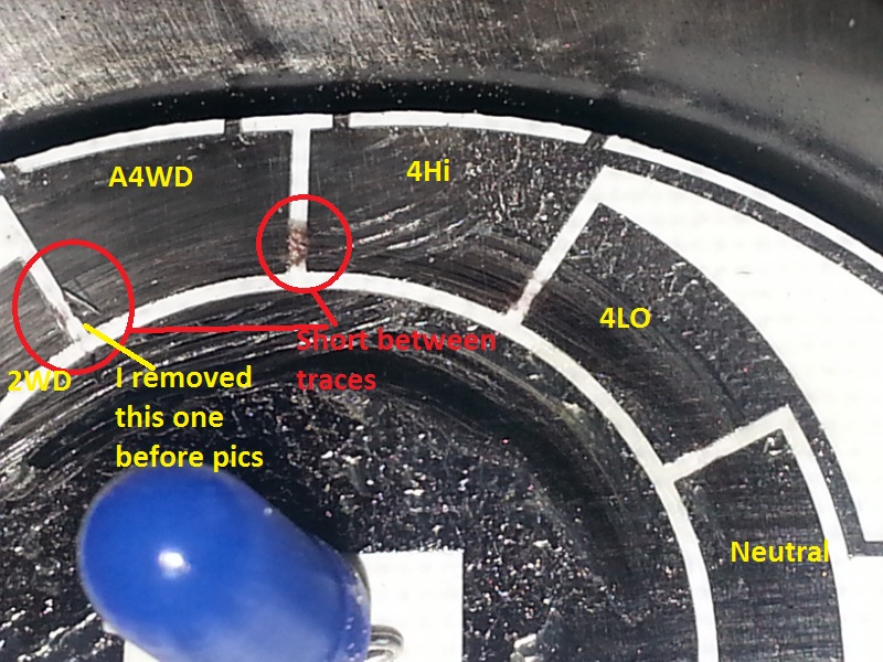

I found the traces in the switch were in short some positions and that was the reason for that the switch always remain in only one position.
the pics are in the reverse order but shows that was the problem.
