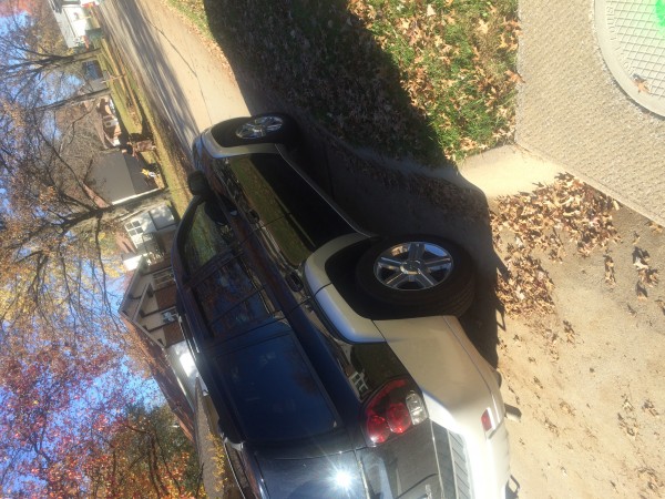

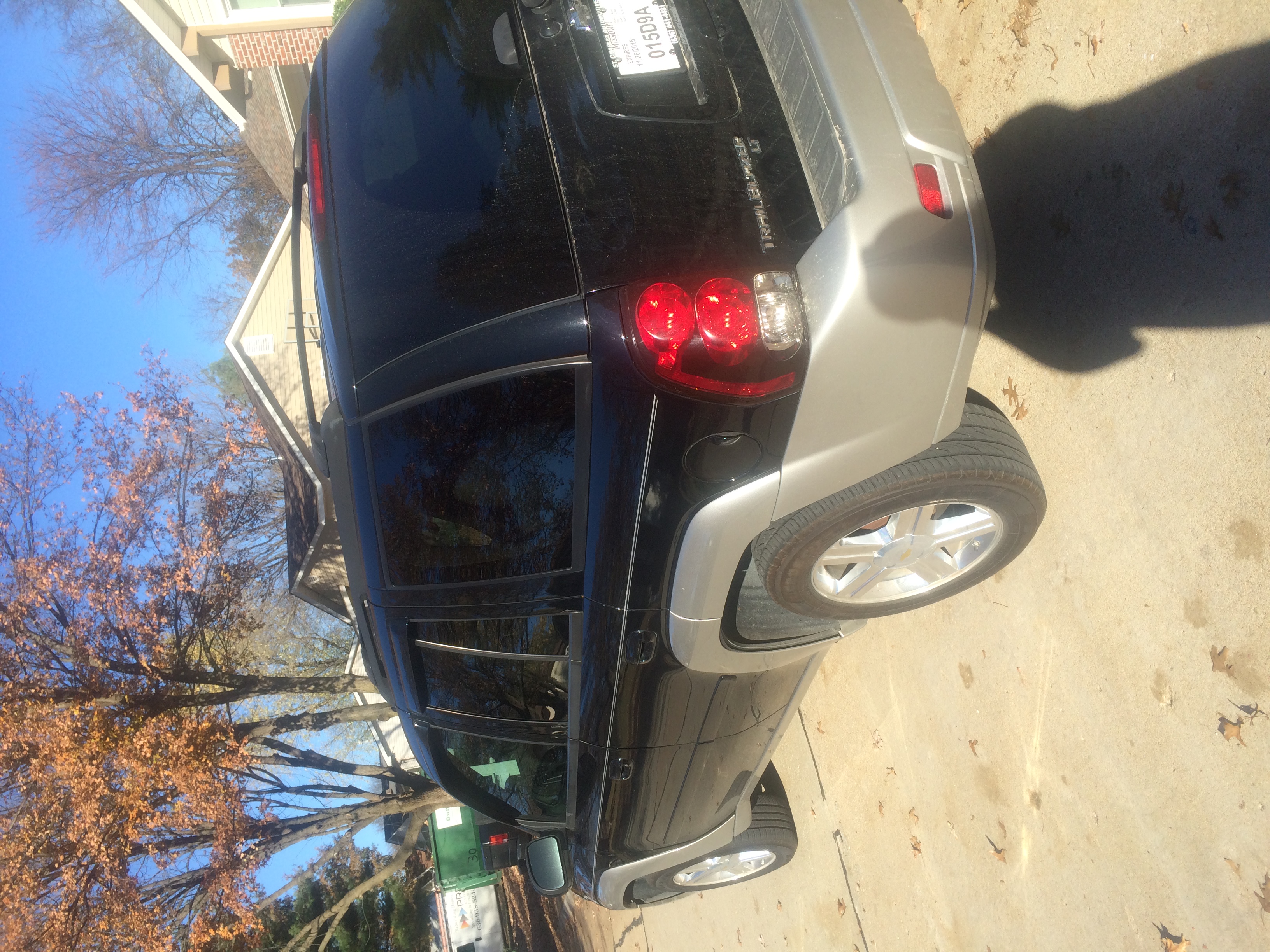

So, I've been looking around to find anyone who has done this and or know about doing it and have had no luck. So I have an 08 Trailblazer. It's black in color with the silver trim at the wheel wells and bottoms of the doors as well as the front and rear bumper covers. I will attach pics. What I am wondering is if it is possible to remove all the silver trim along the wheel wells and under the doors? Is it all adhesive only? I was looking in the wheel well and it looks as if it's held on at the bottom with clips along the inside of the wheel well. I also saw that the trim is removable. So it's not just painted silver :lol: also I do know that I will have to paint or replace the bumpers with black ones :roll:
What I am looking for: An all black trailblazer.
Does anyone know anyone or know of a thread that this was covered in or have personal experience with this? Thanks:)

Generally speaking, after the clips are removed GM uses double sided tape to attach the trim pieces to the body. Typically guys use some fishing line to cut through the glue between the body and trim (in a sawing/pulling motion, occasionally a plastic scraper is needed to get it started... Fishing line and plastic scraper keep you from damaging the paint) and then something like goo gone or another adhesive remover to peel off the remaining adhesive left on the body. It's easier to do on a hot summer day when it's softer, but you can have success with a heat gun or hair dryer too.
To get the bulk of what's left after the trim is removed use a finger or thumb to push on it and roll it up off the body, a glove can help keep you from getting blisters if your hands are callused up good.

Im not for sure about removal of the wheel well trims, but the rocker covers are held on by a couple screws in the fender wells, and push pins on the bottom side, if you look up underneath you will see the holes for them. Remove the screws, then pop the pins on the underside, and the covers should come off.. i would recommend painting your self, even if its with the dupont rattle can paint. the paint code in on the rpo code list in your glove box. Get the code and your local autopart stores usually have some dupont paints that are a match to that code.. Ive body matched my rockers from the cheap gray plastic ones.. yours will be easier since they are smooth from being painted already. i also agree with jr on your bumper covers, paint them yourself too since yours will be more expensive than most being they the LT style bumpers..
