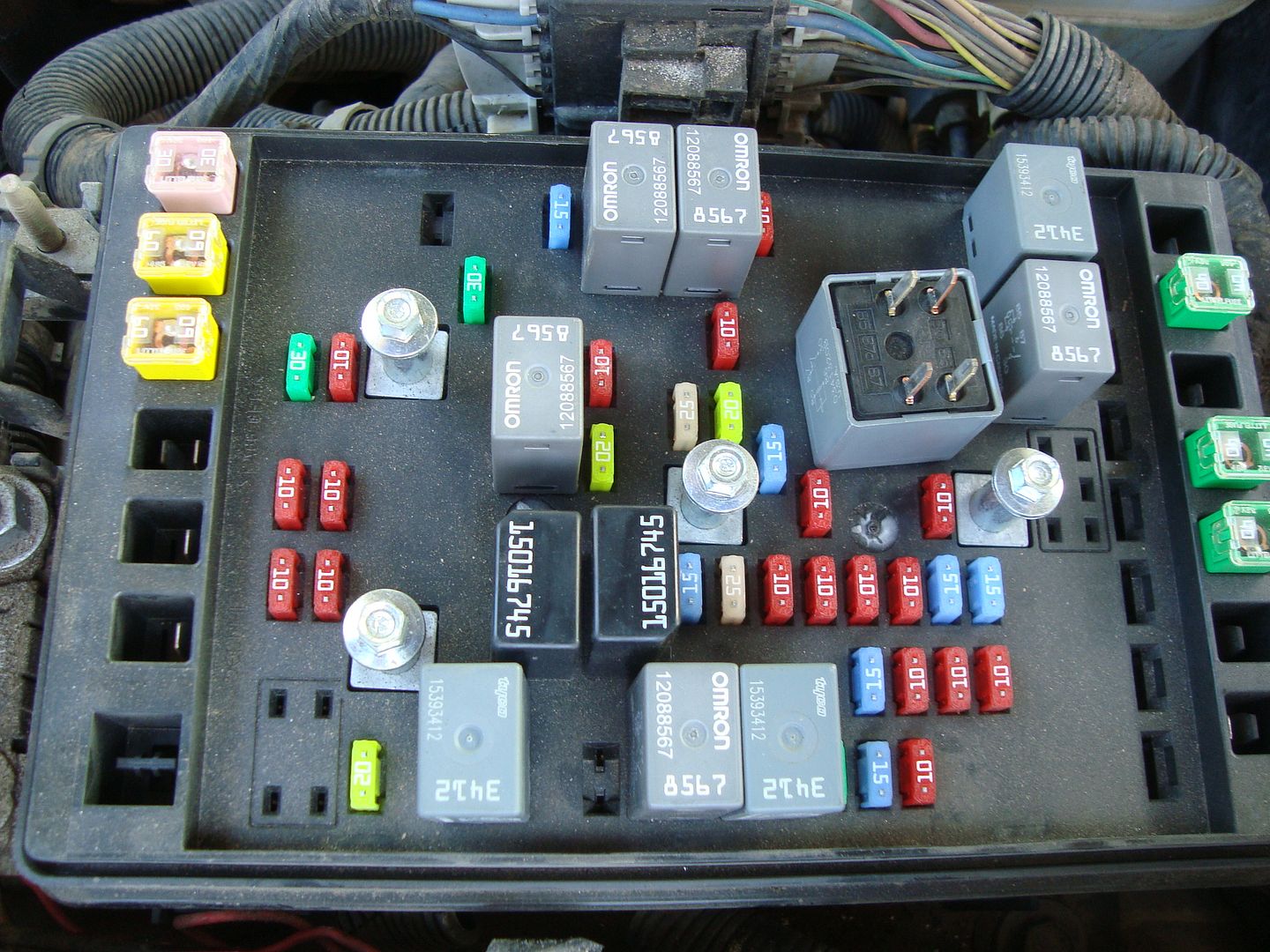

I remove the relay for the starter as opposed to disconnecting the battery. There's plenty of info out there as to why it's not good to disconnect the battery to our platform. Here's the best(only) video on that topic

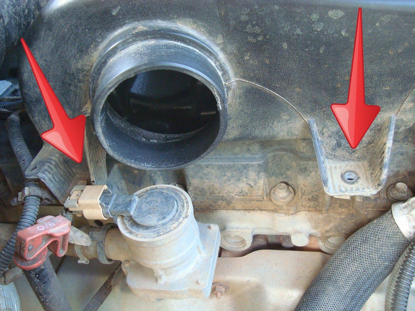

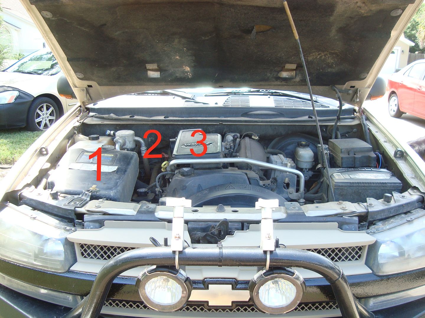

Remove Air box(1), intake tube(2), and intake resonator (3). (my intake tube had been removed prior to this picture, but thats where it should be)
The intake resonator is only held on by these two 10mm bolts and the hoseclamp from the throttlebody connection

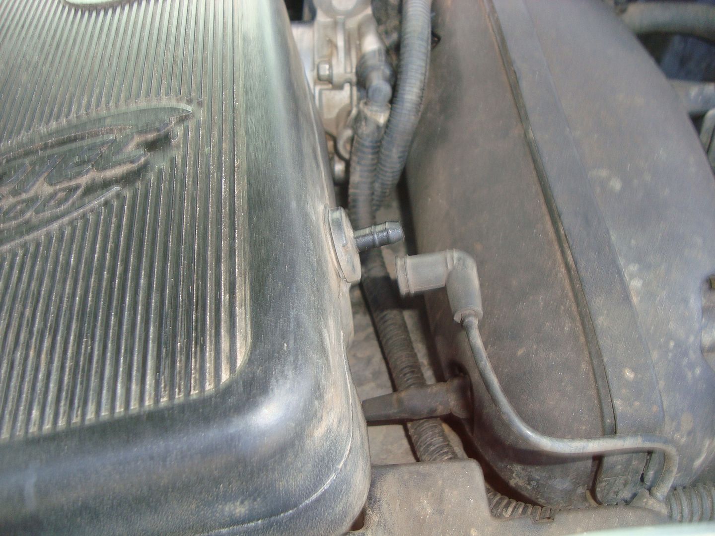

unplug this vacuum hose to the FPR (fuel pressure regulator) [Edited by Roadie]

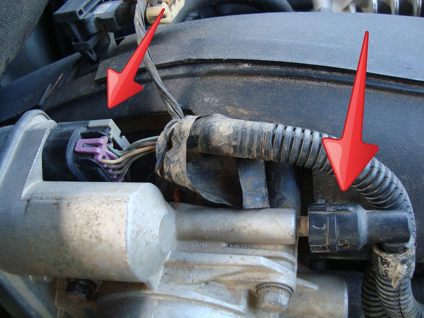

Disconnect the two connections to the throttle body

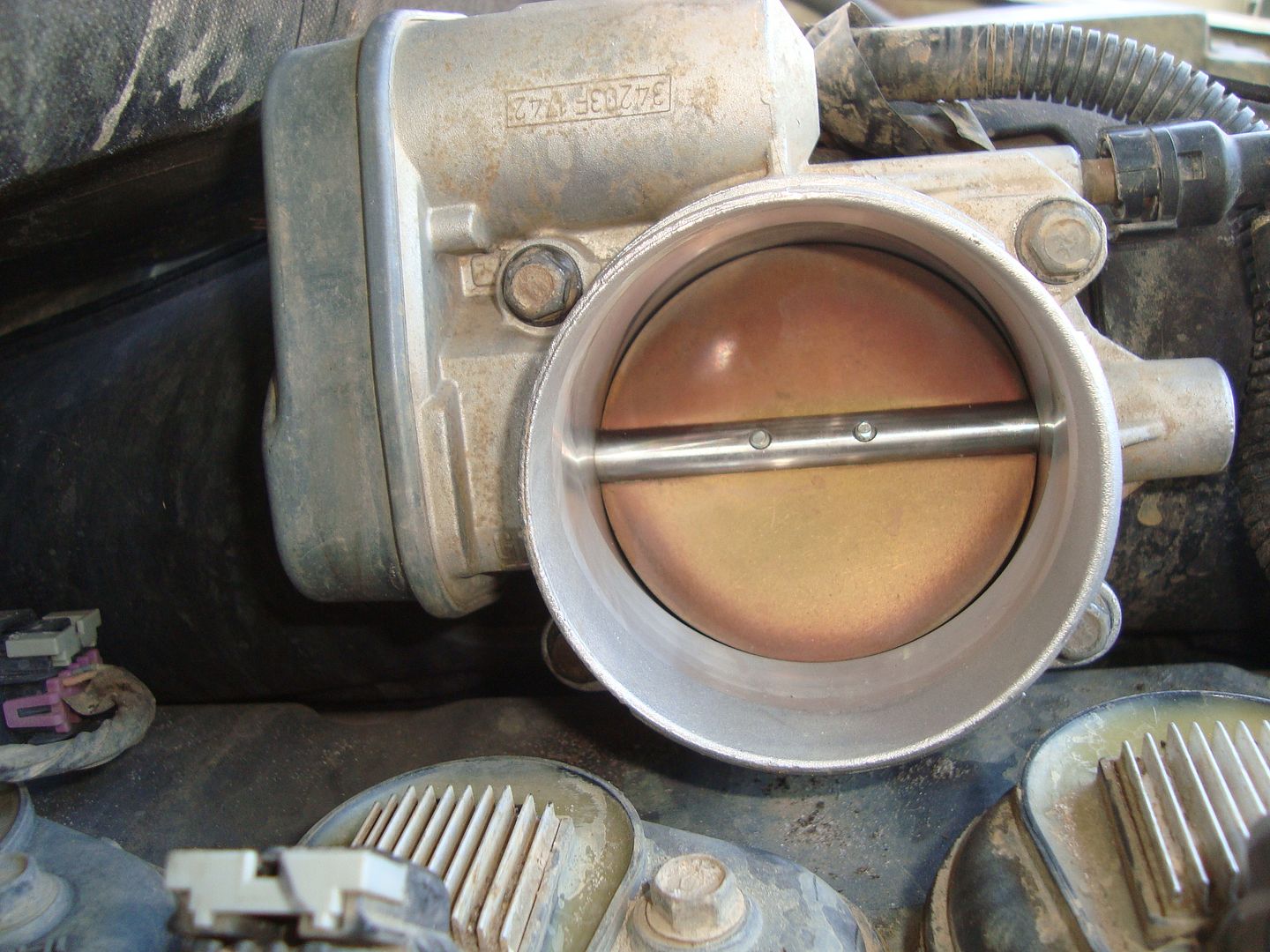

Proceed to use your throttle body cleaner to blast away all the gunkyness. Make sure you move the butterfly valve while you do this, to ensure total coverage. Ensure you use "throttle body" cleaner, not carb cleaner. The chemicals are harsher in carb cleaner and could damage the throttle body, or so my research says.

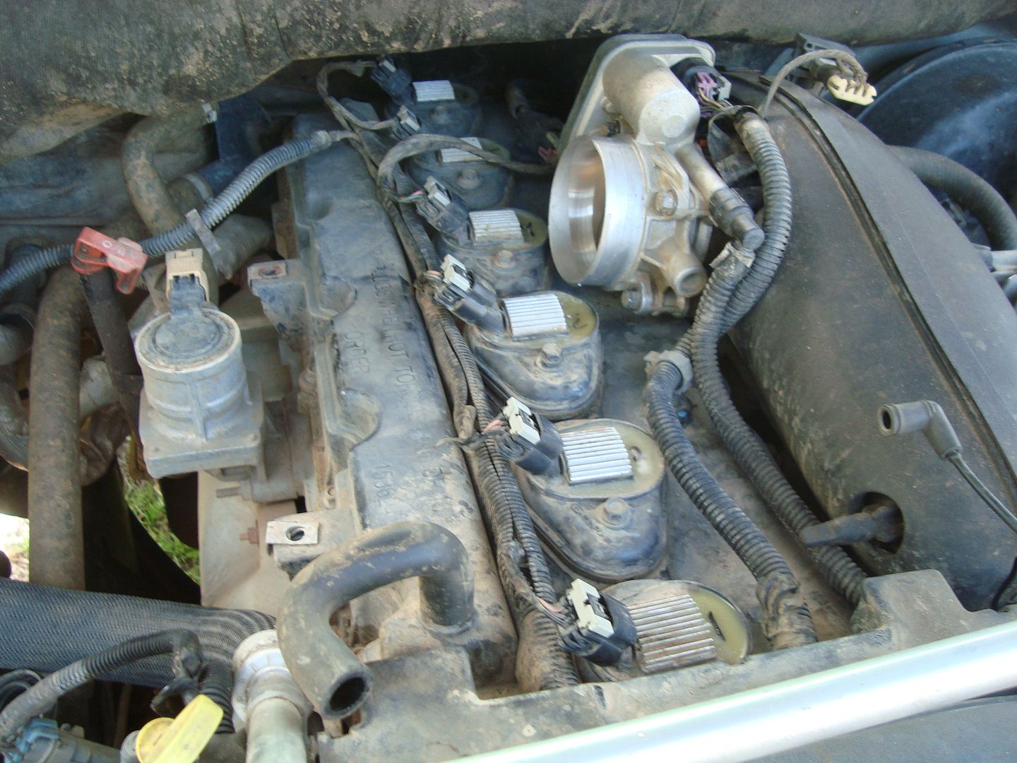

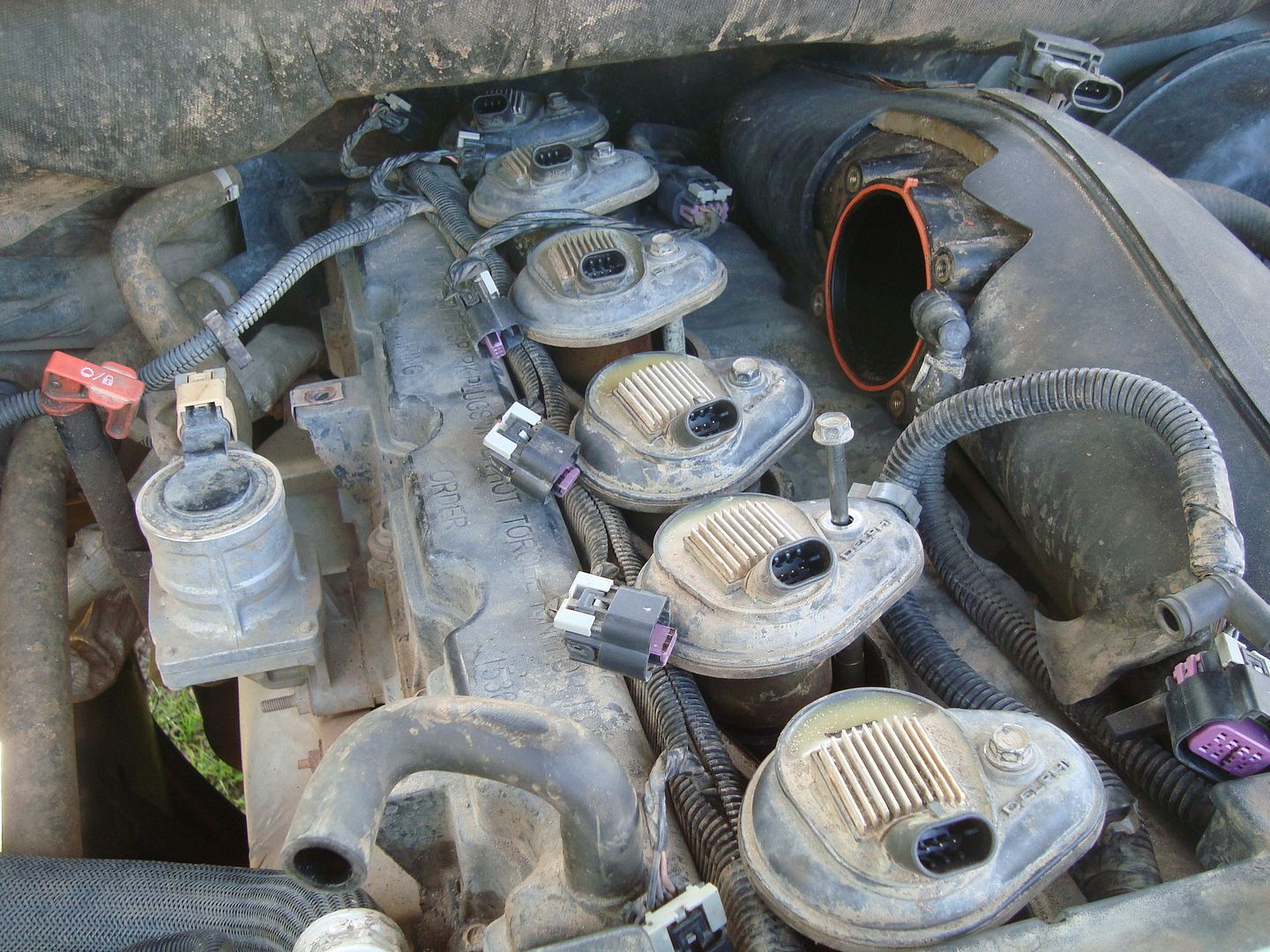

Once the throttle body is cleaned, set it aside. Now we begin the coil back removal. Each cylinder has it's own coil pack that is held in by one 10mm bolt. Unplug each pack then remove the bolt, and pull up gently on the coil pack; the bottom is the boot for the spark plug. You should hear a the "poopity ploop" of the boot unseating from the plug. The #5 and #6 cylinders can be kind of a bitch so make sure no kids or holy men are around.

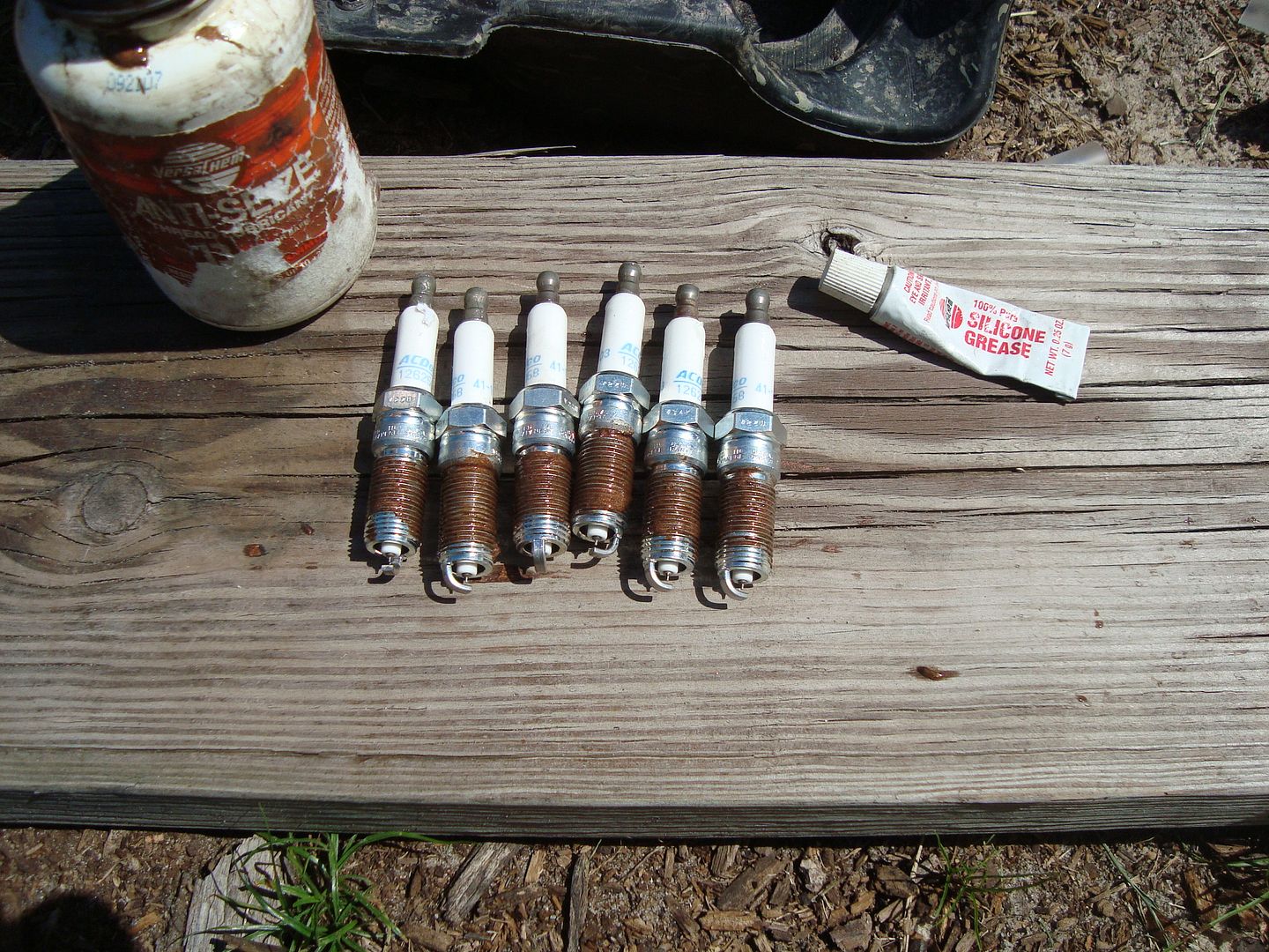

Remove each spark plug with the 5/8" sparkplug socket. Apply anti seize to the threads of the new plugs and silicone grease to the otherside
Install new spark plugs and torque to 13ft lbs. Assembly is reverse procedure. Ensure you reinstall any relays or fuses that you pull.
Take old spark plugs and do what you wish to/with them. Make a necklace, shoot them, weld them somewhere as decorations, etc. The options are endless.
