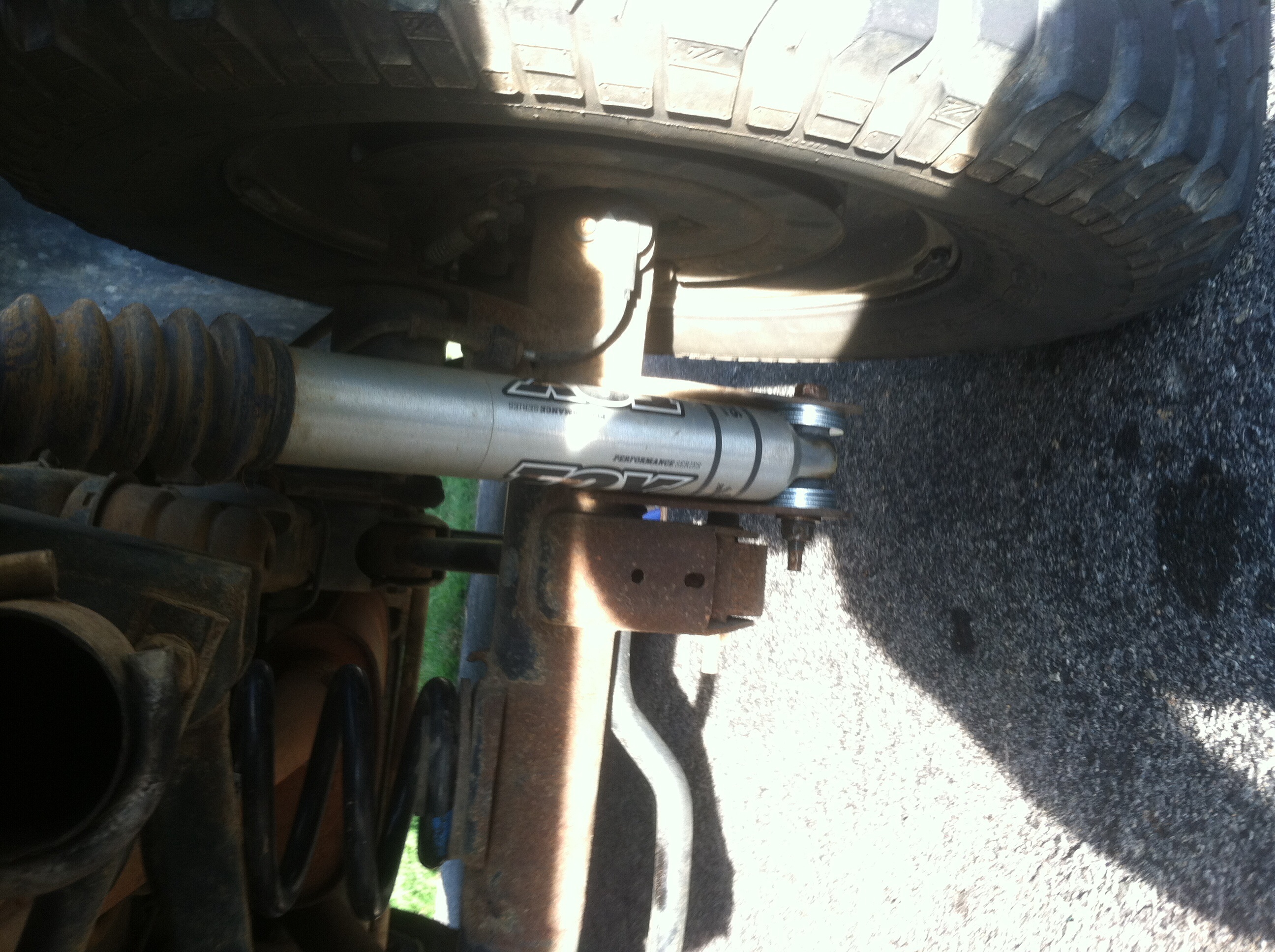

Any thoughts?
It will be used with radflo front and MarkMC on rear (stock springs)

Use washers bro, recently found my rear shock had traveled to one side and almost ruined it. It's worth the $6.

Required a 1/2" bolt also?
Does that require drilling out the mount?

I used a 1/2" bolt with mine plus a boat load of washers, no drilling.

I reused the stock bolts/washers on my skyjackers 8030's.

What is length of 1/2 bolt? Like, I assume the carriage aspect of the bolt is X and the threads are Y?
I live in the middle of nowhere so seeing if I can order it vs. several 50 mile round trips to hardware store.

I re-used my stock bolt with my skyjackers. Either way your stock bolt should be the right length if you go the 1/2" bolt route. The easiest thing to do might be to go outside and measure your stock bolt.
