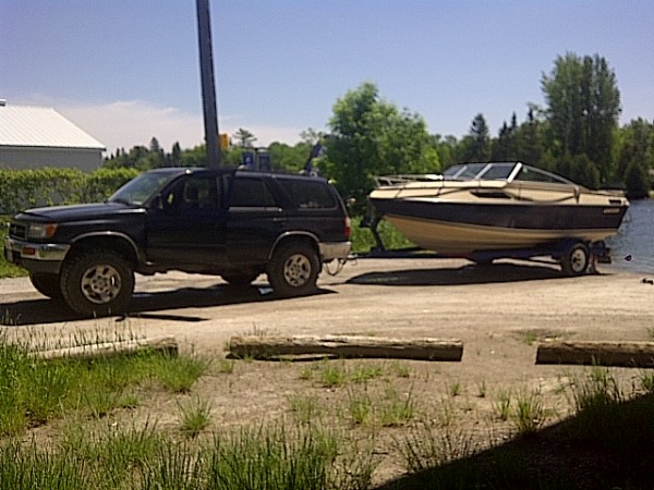

by SmokeyMcBlazer » Wed Jun 04, 2014 9:07 pm
Not really sure the weight of the boat but I never pull it at highway speeds anyway. Just around between some local lakes. This is the boat.

by DirtyBacon04 » Thu Jun 05, 2014 2:23 pm
Towing 101: Know the weight of what you're towing.

Though it may be true that I don't know the weight of my boat, I do know that the trailblazer has a 1400lb higher maximum towing capacity then my old 4runner and my old 4runner hardly noticed it back there.
So, back to the cooler. What I take from James' post is shop around and get the cheapest one I can find?
