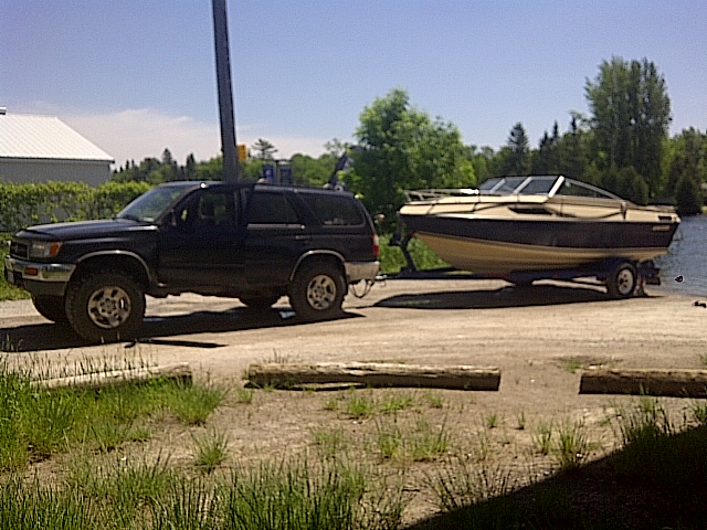

How heavy is your boat? That will tell you a lot about which gears will be ok. I have towed stuff with my 3.42s on 32s, and it sucked, but in D3 and driving 65 it didn't overheat. D3 is kinda a temporary solution to sucky gearing.
by SmokeyMcBlazer » Wed Jun 04, 2014 9:07 pm
Not really sure the weight of the boat but I never pull it at highway speeds anyway. Just around between some local lakes. This is the boat.

by DirtyBacon04 » Thu Jun 05, 2014 2:23 pm
Towing 101: Know the weight of what you're towing.
by TBYODA » Thu Jun 05, 2014 6:11 pm
DirtyBacon04 wrote:Towing 101: Know the weight of what you're towing.
Why, does that matter?!
by SmokeyMcBlazer » Thu Jun 05, 2014 6:26 pm
Though it may be true that I don't know the weight of my boat, I do know that the trailblazer has a 1400lb higher maximum towing capacity then my old 4runner and my old 4runner hardly noticed it back there.
So, back to the cooler. What I take from James' post is shop around and get the cheapest one I can find?
