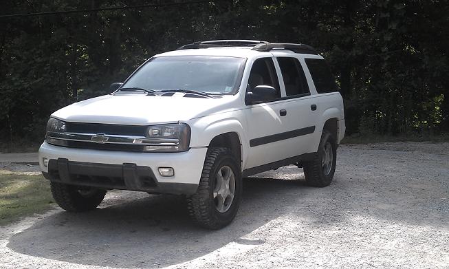

Today's drive to work was a very pleasant improvement from yesterday's. With Dogs all around, the tendency to wander in the ruts seems to have been 90 to 100% eliminated. I'll know for sure when I drag my boat to Enid lake again, as there are some really good ruts on the way there.
Here's a pic of the truck with the new tires. I love the basic black and white.
The EXT with new tires all around.
