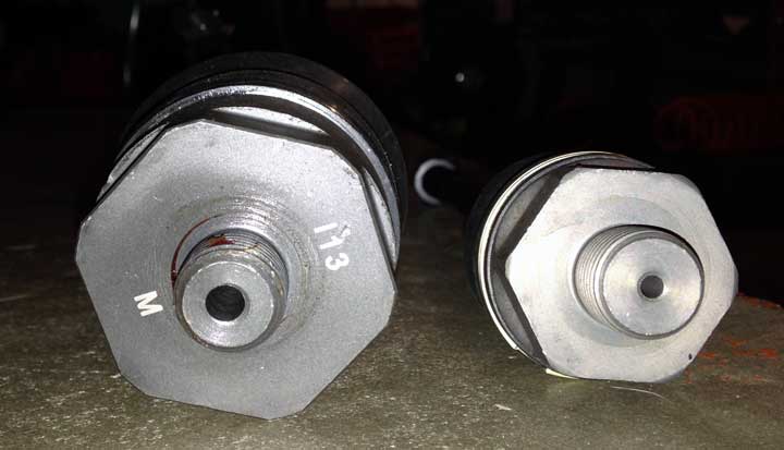

While this doesn't change the fact, I got my hands on an HD tie rod end to show you the difference.
BOOM :awesome:
The Fabtechs are surprisingly really big in comparison. Even when compared to the OEM ones.
by ErikSS » Fri Feb 07, 2014 10:42 am
Thanks for the comparison Mike. I didn't realize how different the diameter was until you posted the pic of it against your rack. Have you decided to try Moogs? Rough Country sleeves?
