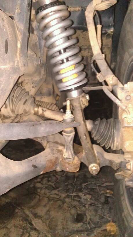

by ErikSS » Sun Nov 24, 2013 9:38 pm
I had marks 3".... And seriously collapsed springs. All I can tell you is that the Radflo at factory preset was the same as my 3" lift and collapsed springs. Sorry the information is really useless. I threaded mine down almost to the bottom. 3 1/4" of thread above my collar. I didn't gain any vehicle height after 3" so I stopped.

by HARDTRAILZ » Mon Nov 25, 2013 12:33 am
ErikSS wrote:I had marks 3".... And seriously collapsed springs. All I can tell you is that the Radflo at factory preset was the same as my 3" lift and collapsed springs. Sorry the information is really useless. I threaded mine down almost to the bottom. 3 1/4" of thread above my collar. I didn't gain any vehicle height after 3" so I stopped.
So when you stopped gaining vehicle height...how much lift was there? Are you as tall as you were before the spring collapse?
You have 3.25 inch thread left or you have 0.75 inch thread left?
by ErikSS » Mon Nov 25, 2013 7:28 am
I havnt found my tape measure pictures from when I first lifted... But I believe I'm about an inch taller than I was. I didn't have the bumper then either. I have 3.25" above my colar. I can't get an accurate reading below but its about 0.75". So I have 0.75" more adjustment. After a weekend of bouncing around they have settled in about 0.25".
When shipped the colar was at 1.125" from the top and I lowered it to 3.25". So I gained around 3" of lift for 2" of adjustment.

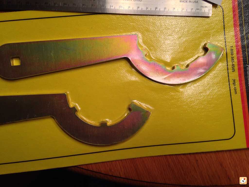

by TBYODA » Mon Nov 25, 2013 12:22 pm
I got mine today. If any one cares they are 18 3/4" from end to end and the upper spanner fits them. :mechanic:
