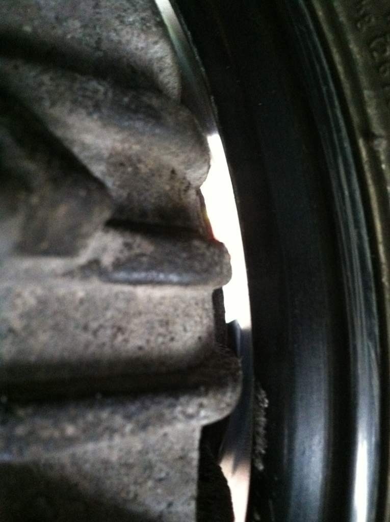

Brake swap
Stock
Swap--to ext front rotors
Drilled and slotted rotors w/ ceramic pads (eBay)$150ish
Caliper bridges (rock-auto)$25ish ea

by Bcchevy » Mon Aug 05, 2013 9:20 pm
Only allowed 3 pics pr post...
Bridges
Wheel space
Tire wheel combo
16x8 4"bs
Lt305/70r16
Mud star
