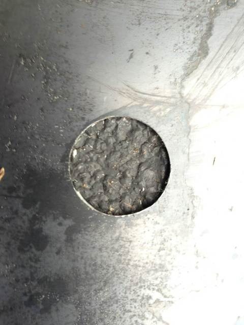

Drilled, I still have to make bigger hole for the oil plug. Got to pick up this up 1 1/2 drill bit or maybe try this one since it is cheaper. Step Drill
Once drilled I am going build up around the hole a little and put cover over for protection, again simple. I will post up more picture when done.
