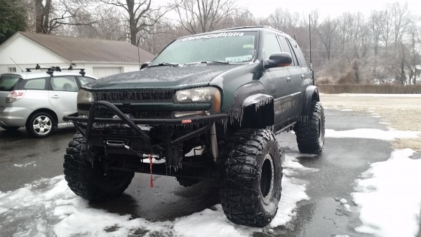

by dirty anton » Tue Nov 30, 2010 12:15 am
year make model: 2002 chevy trailblazer
drivetrain: 4.2 l i 6, replaced motor 5 years ago with new,used(30,000)miles /new beefed up trans ,reluctor ring for vss,transgo shift kit,corvette servo,over size trans pan, cooler ,temp sender gauge/231c tc case (manual)/tom woods drive shafts:

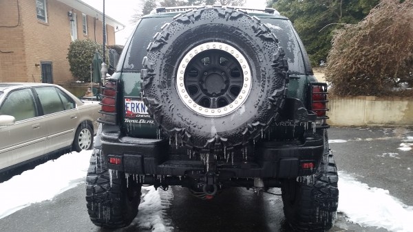

suspension mods:custom leaf spring lift sas/ford dana 60 front 4.88 gears/chevy 14 bolt full floater rear 4.88 gears/both detroit lockers (auto),purple cranium diff protectors/rancho shocks/PSC ps pump res and cooler/redneck ram assist 1.75/crossover steering/off road design offset draglink/lots and lots of fabricating!/37by13.5 nitto mud grapplers/17in raceline beed locks
ext mods:tube bumper with winch plate. Warn zeon winch and skid/welded reciever tire-gas can mount/flexi flares/tail light protectors/fire stick antenna/hood struts/neilageinc.com rock sliders,extended breather hose's(trans,tc/diffs)
umm...low range rock lights/oil-trans-tc-gas-pinion skids.

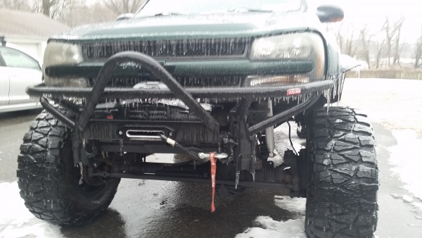

How it sits today without 3in body lift

by dirty anton » Wed Dec 01, 2010 12:53 pm
bartons bumper!!!
with added lights
(13.78 KiB) Downloaded 1830 times
just put on
(11.61 KiB) Downloaded 1830 times

by dirty anton » Sun Jan 09, 2011 3:09 pm
a few more pics
new rear july 10
(50.79 KiB) Downloaded 1486 times
cb
(50.13 KiB) Downloaded 1486 times
front view on the trail
(80.78 KiB) Downloaded 1486 times
