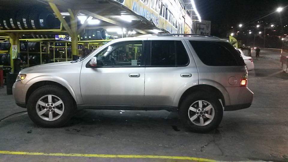

Test fitting.
Tallest GM front springs & Bilstiens and Z71 springs on the rear.
A lot of cutting and banging on the inside of the front fenders.
97x 5.3 LH6 ŘWD
SPRING LIFT ONLY ON 33"
Z71 springs!

Nice work! Tight squeeze on the Saab, but looks good!
