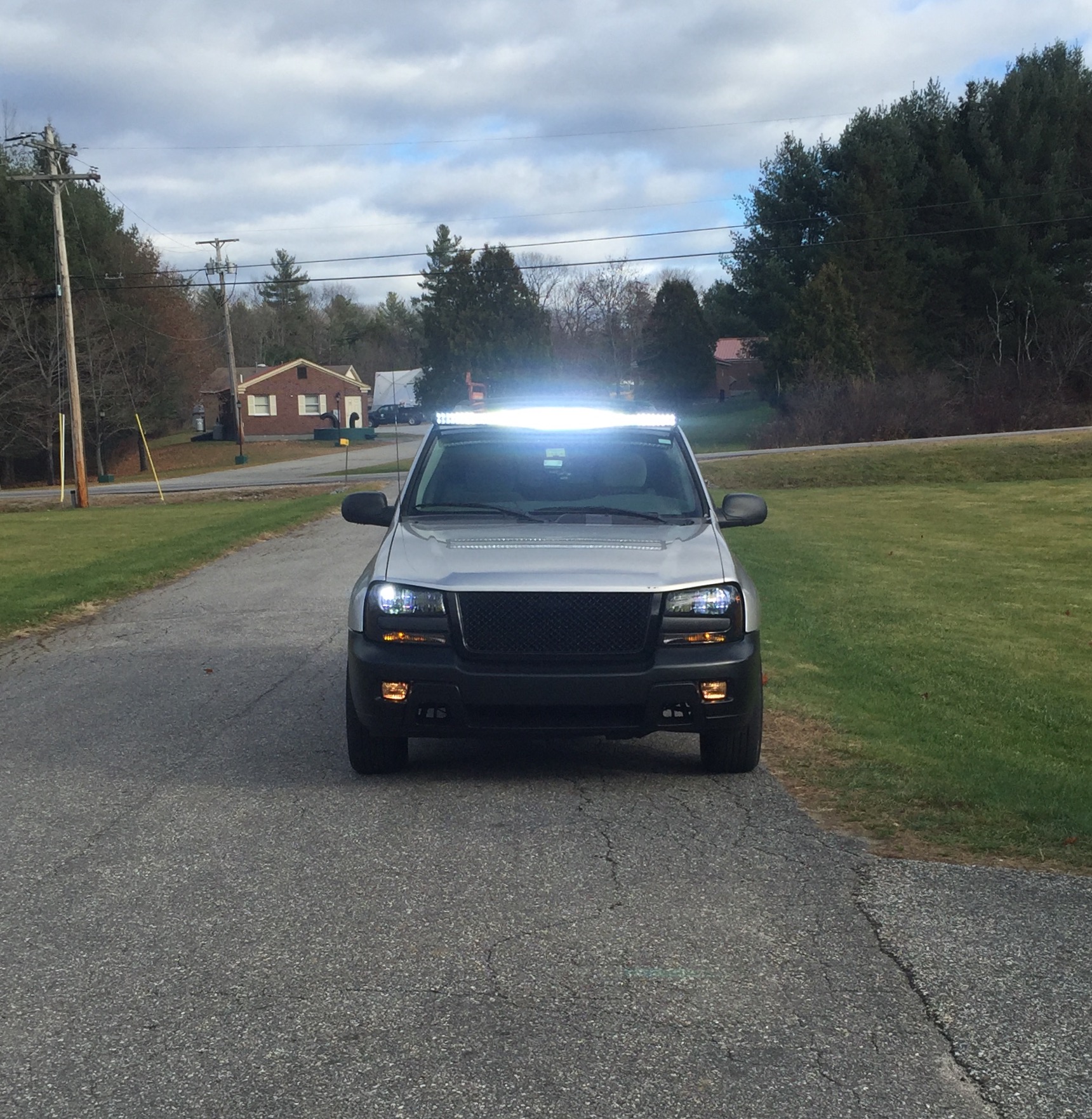

... But instead I bought these brackets and a 50" light bar chazpages wrote:got my bar mounted up, its sick! Ridiculously bright...
However, this thing HOWLS like a mofo haha. So look up "lightbar whistle fixes" and go with one of those.
Note: The Howl/whistle is NOT from the mount, its from the lightbar. Pretty common issue with led lightbar users.
I'll personally be going with some tubing shoved in between the fins of the bar, and I'll report back about my success.

I had the same problem.. But the louder my music gets the sound just seems to go away. Your light bar looks awesome man and looks very bright! Hows the glare on the windshield?

I did it the exact same way. Doesn't pinch the wire or compromise the weather striping. Only hard part will be getting wire through the firewall for the switch (not for me though, my firewall has many wires passed through it.. Like throwin a hot dog down a hall way chazpages wrote:bump! So I needed to take the kid to the snow, and hadn't ordered the wind/noise isolators yet...so I jammed a bunch of rubber tubing in between the fins to help with whistle/noise for our trip. They worked pretty well, but it still makes noise sometimes depending on the direction of wind while driving.
I'll report back once I have the official wind/noise vibration dampners installed.
I DID confirm that some/most/all? of the noise is from vibrations-I drove around 40mph and put my hand on the bar and could feel the bottom fins vibrating(which is why I chose to jam rubber tubing in between the fins for the time being). I don't yet know how much noise just comes from wind. I'll find out once the dampners are installed.
