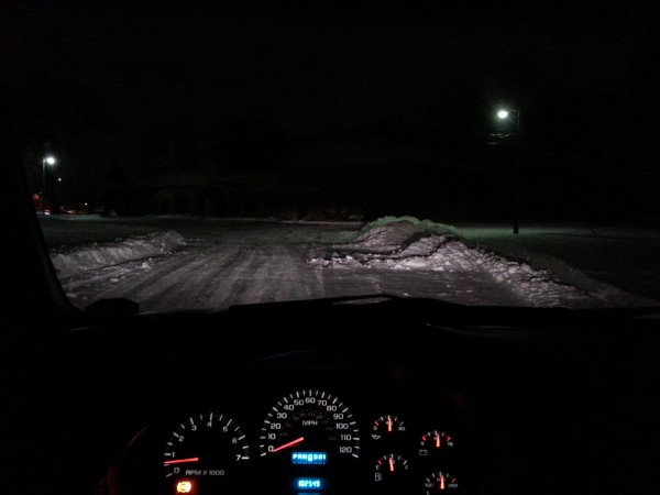

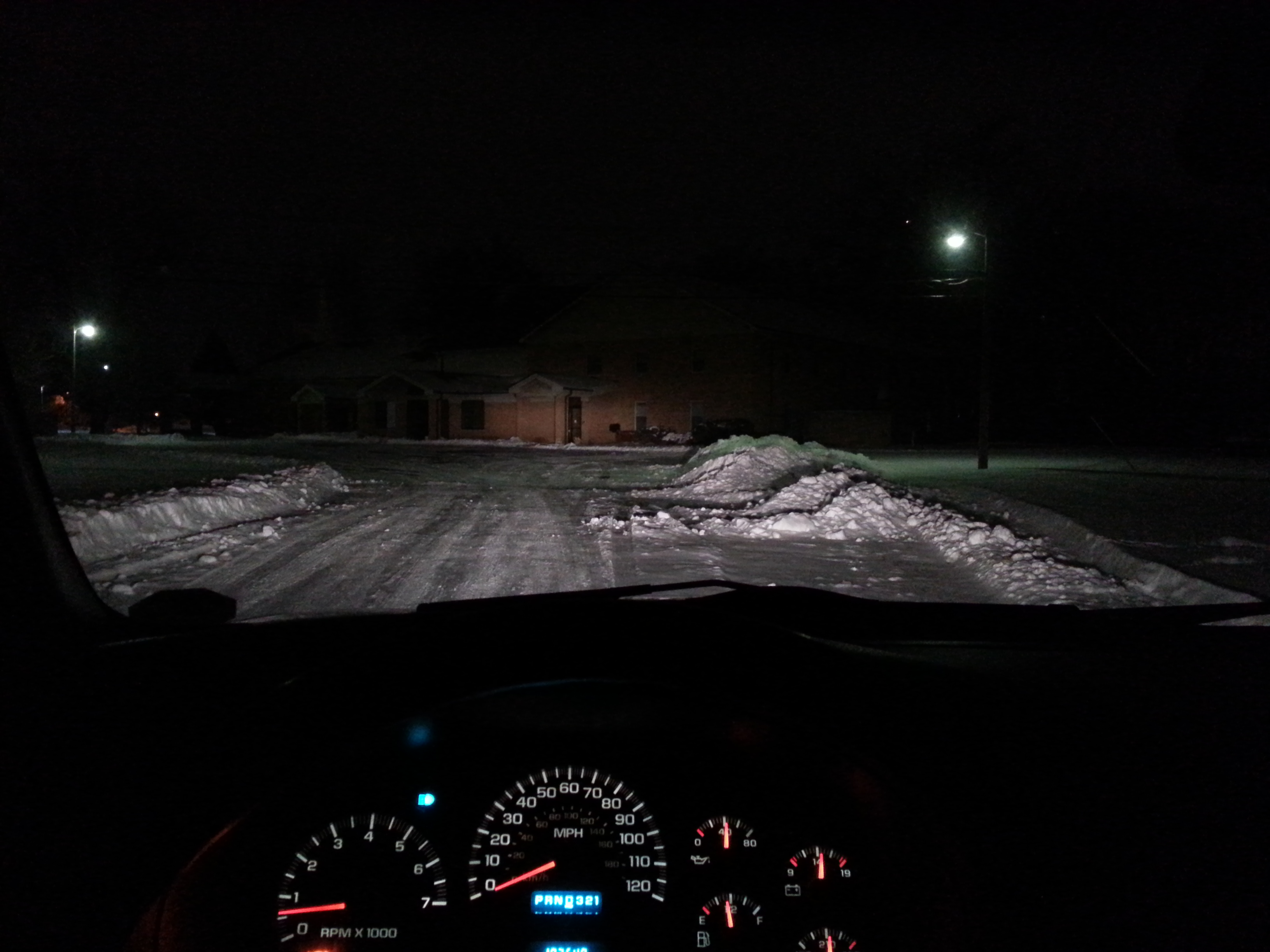

Low Beams Only
- low
Low & High Beams (quad headlight mod)
- high
Low & High Beams AND LIGHT BAR
- full
