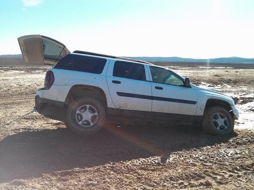

Here's a video I made today of me trying out the hub winch (a work in progress).
Overall, I would say it worked as expected.
To eliminate traction, I jacked up the rear diff with a floor jack that was sitting on a sheet of steel so it could slide backwards with the vehicle. By the way, that's what's making the grinding noises you hear in the video.
On the very first attempt, the rear of the truck slipped sideways rather quickly and the strap started to roll off the end of the spool. To fix this, I made a "guide" for the winch strap by using a small ratchet strap between it and the trailer hitch. This was a crude but very effective means of keeping the vehicle lined up with the winch strap so that it spooled neatly.
Some work stuff is going to keep me from developing this any further for a few weeks, but my restless brain will be OK knowing that this project is working out so far.
