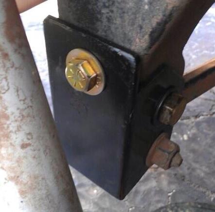

by TBYODA » Wed Sep 03, 2014 3:54 pm
Does anyone think we need two top bolts to hold it to the mount?
by Moots1288 » Wed Sep 03, 2014 4:01 pm
TBYODA wrote:Does anyone think we need two top bolts to hold it to the mount?
no it holds in just find with the top and side bolt. And being sandwiched with the old mount.
by ErikSS » Wed Sep 03, 2014 8:27 pm
Robert, did you mean 2 bolts holding it sandwiched? Because that thought has crossed my mind. It's also crossed my mind to have more than one hole that you can mount the bar into, allowing some adjustability. For exampe, a location intended for guys with 2" lift blocks and stock springs. Then the location we are using as it's so common. Perhaps an additional location for people who go further yet with the Skyjacker springs.
I am Not an engineer. This would possibly take me some time to figure out. Is there interest in that kind of change, or is the majority happy with the bracket the way it is?
by TBYODA » Wed Sep 03, 2014 8:51 pm
I am taking about the top bolt as shown here, may a longer bracket going up the mount.
by Moots1288 » Thu Sep 04, 2014 12:27 am
I don't see a need for the bracket to be longer, and putting another bolt in there. It'll also be a little difficult if I recall to get a nut up in there and work.
Sent from my SPH-L720 using Tapatalk
by TBYODA » Thu Sep 04, 2014 12:54 am
Good point

by v7guy » Sat Sep 06, 2014 12:24 pm
I think ideally you'd have two horizontal bolts and drill the stock mount for a second bolt, I don't know if it's even feasible though to get a drill up in there. With that said, Mark's design has seemed to hold up just fine as is.
If anybody is worried about it, there wouldn't be much work involved in just burning the extension into stock bracket.
