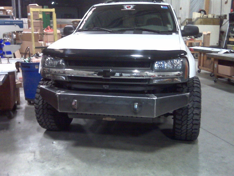

HARDTRAILZ wrote:I see what you mean. I am thinking that at only six inches deep, the hi lift may show behind the bumper some, but it prolly wouldnt hurt. The center is 40 inches and a small hilift is 48 so it would have to go into one of the wing areas, but I can lay my hilift on the top of the bumper once its on for a visual.
It's just an idea that's all. Might be a good spot for something else, what I'm not sure yet. Just curious how much room could be utilized for something.
Mike could always make a bumper to do what fits him or someone else maybe. ;)

I had thought of enclosing the wings and hingings the tops like tool boxes. Tools in one side and shackles and straps in the other....
by bartonmd » Thu May 13, 2010 3:28 pm
HARDTRAILZ wrote:I had thought of enclosing the wings and hingings the tops like tool boxes. Tools in one side and shackles and straps in the other....
That's a better thing to do to a rear bumper, I think... More load carrying capacity back there, and would help distribute weight better...

by bartonmd » Thu May 13, 2010 3:38 pm
irishboy02 wrote: +1
Our fronts are already to heavy as is IMO
Any input on my hilift mount idea?
You'll see it in the pictures from the back side of the bumper... 4-5" is taken up by the frame rails... Leaves you 2.5-3.5" to play with... MAYBE the shaft part could be stored in there, but definately not the actual jack mechanism...

No no, i think you mis-read what i was talking about. I believe what your design is doing is allowing a cut through for the d-shackle mounts, no?
The piece of steel that is protruding from the bumper that the shackle mounts through, prior to the shackle should have enough room to maybe mount a threaded bolt sticking upward, where this can stick through the hilift holes and just bolt in. Maybe. Idk just a thought but im reaallyyy liking this bumper

by Trail X » Thu May 13, 2010 3:55 pm
Top of the bumper would be a cool place to have a couple shoulder studs sticking up to mount the hilift...
Inside the bumper doesn't sound very easy to access... and are there any gains to mounting it inside the bumper vs. on top of the bumper?

by bartonmd » Thu May 13, 2010 10:27 pm
Done! Left the office at 9PM...
Exactly as we suspected... It wouldn't look right with a taller bumper, but this bumper is about the height that a non-body-lifted TB would take...
After looking at it, we may end up doing 2" tall filler pieces along both sides, and he may end up doing an SS grill, so the grill will go down 2" farther, like the newer LT versions...
by HARDTRAILZ » Thu May 13, 2010 11:06 pm
Painted with cheap spray paint just to coat it. Will get some more mods and a real finish soon.
by HARDTRAILZ » Thu May 13, 2010 11:16 pm
I do have to give a huge THANKS to Mike for this. I pretty much only bought material, so cost was incrediblefor us to give it a try.
And the turn-around time was incredible...from a PM Monday asking about getting me some steel to designing and having a bumper built and on my truck on Thursday. I dont think anyone has a non-factory bumper that can compare. I could not have ordered one and had it delivered and on by now.

really well done. I do want to give my 2 cents. is there a way to make the center part of the bumper not so big. It just seems a tad over kill. Could it be possible to have the bumper start that big at the body, and have it narrow out a bit towards the front of the bumper. It would probably improve aerodynamics a bit too. It just seems a bit overly boxy to me. But for a super strong simple design, its freakin bad ass!

by HARDTRAILZ » Fri May 14, 2010 12:14 am
Zero wrote:really well done. I do want to give my 2 cents. is there a way to make the center part of the bumper not so big. It just seems a tad over kill. Could it be possible to have the bumper start that big at the body, and have it narrow out a bit towards the front of the bumper. It would probably improve aerodynamics a bit too. It just seems a bit overly boxy to me. But for a super strong simple design, its freakin bad ass!
Not really understanding...You mean have the top plate at an angle? It is only 8 inches tall and the frame is 6...

by HARDTRAILZ » Fri May 14, 2010 12:48 am
Zero wrote:ya i didnt think it would come out that clear. I wish i could draw it out.
http://www.monsterbumpers.com/images/pr ... C08574.jpg
if you look at that bumper....all the plates taper a bit making the front of the bumper (the part you would bump stuff with) more narrow then the back of the bumper (where it bolts to, and meets the body of the truck).
hopefully now you guys can see what I mean by a less boxy look.
pushes it out further and hurts approach angle. I barely lost any if i did.
by irishboy02 » Fri May 14, 2010 1:43 am
Cant really tell how much room were working with on the top there. Is there enough to bolt down a winch plate? Or inside with the farelead in the middle of the d-shackles? Or is that front cross bar right up against it?
Also maybe a small cutout on either side for a 4" offroad light?

by Regulator1175 » Fri May 14, 2010 1:54 am
I think something like that one pictured above would work out well for the Envoys since our center grill drops down lower then the lights.
I would love to see if it was possible to cut out a couple of holes for some additional light. For instance, I enjoy having the cornering lights on the Envoy, and I would love to be able to incorporate them into the design.
