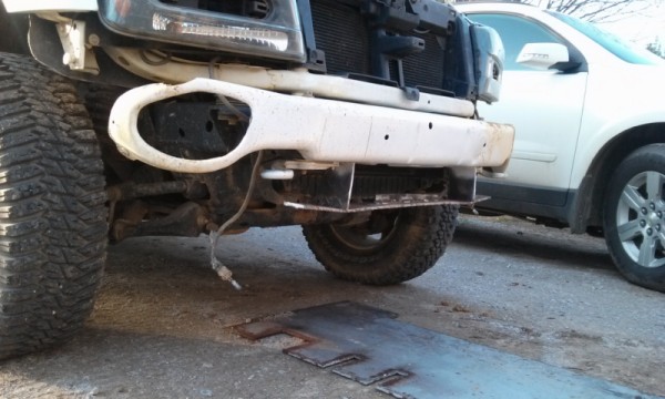

Recycled 1/4 inch plate.
Bridge is welded to bumper, hidden by bumper cover.

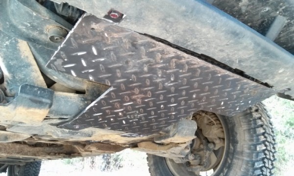

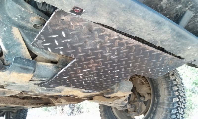

Plate is bolted to bridge at front, MDB oil pan skid at rear.

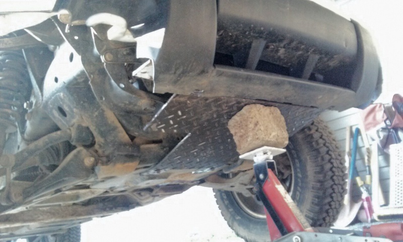

BWGuy wrote:Actually, the jack and the block were just a simulated obstacle to test the strength of the skid. I was aiming for something that would support the weight of the front end, static anyways. I reckon I might spray it black at some point, but except for that or any repairs that might be needed at some point, it's done.
Btw... the welding was done with a Lincoln Electric Weld Pack 140 HD, and I gotta say that thing is the cat's pajamas!
