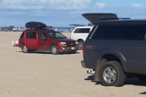

by Gdavid » Fri Nov 20, 2020 1:37 pm
Looking like the Griswalds at the beach
Outgunned
