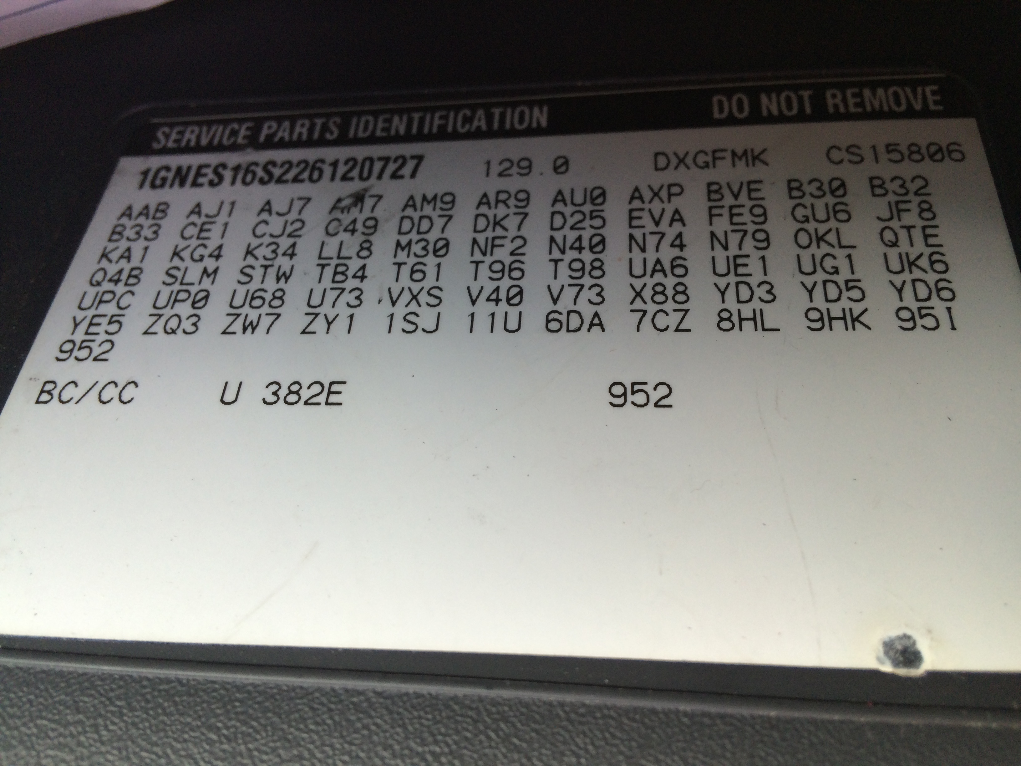

by navigator » Wed Sep 30, 2015 1:09 pm
Look and see if you have a g80 RPO code in your glovebox. If so you already have a locker. It is reported to be on the weak side but will likely work for what you have in mind.

by robmcbryde » Wed Sep 30, 2015 2:38 pm

by robmcbryde » Wed Sep 30, 2015 3:43 pm

by navigator » Wed Sep 30, 2015 4:01 pm
So no g80 locker and you have the less desreable 3.42 gears. Any chance it is a v8?

by TBYODA » Wed Sep 30, 2015 8:09 pm
Rob you have EXT wheelbase by the 129.0 on the RPO sticker. Which means you have a 8.6" rear already. You could do two things buy new 4.10 gears and a locker or just a locker. Summit racing has what you need.
