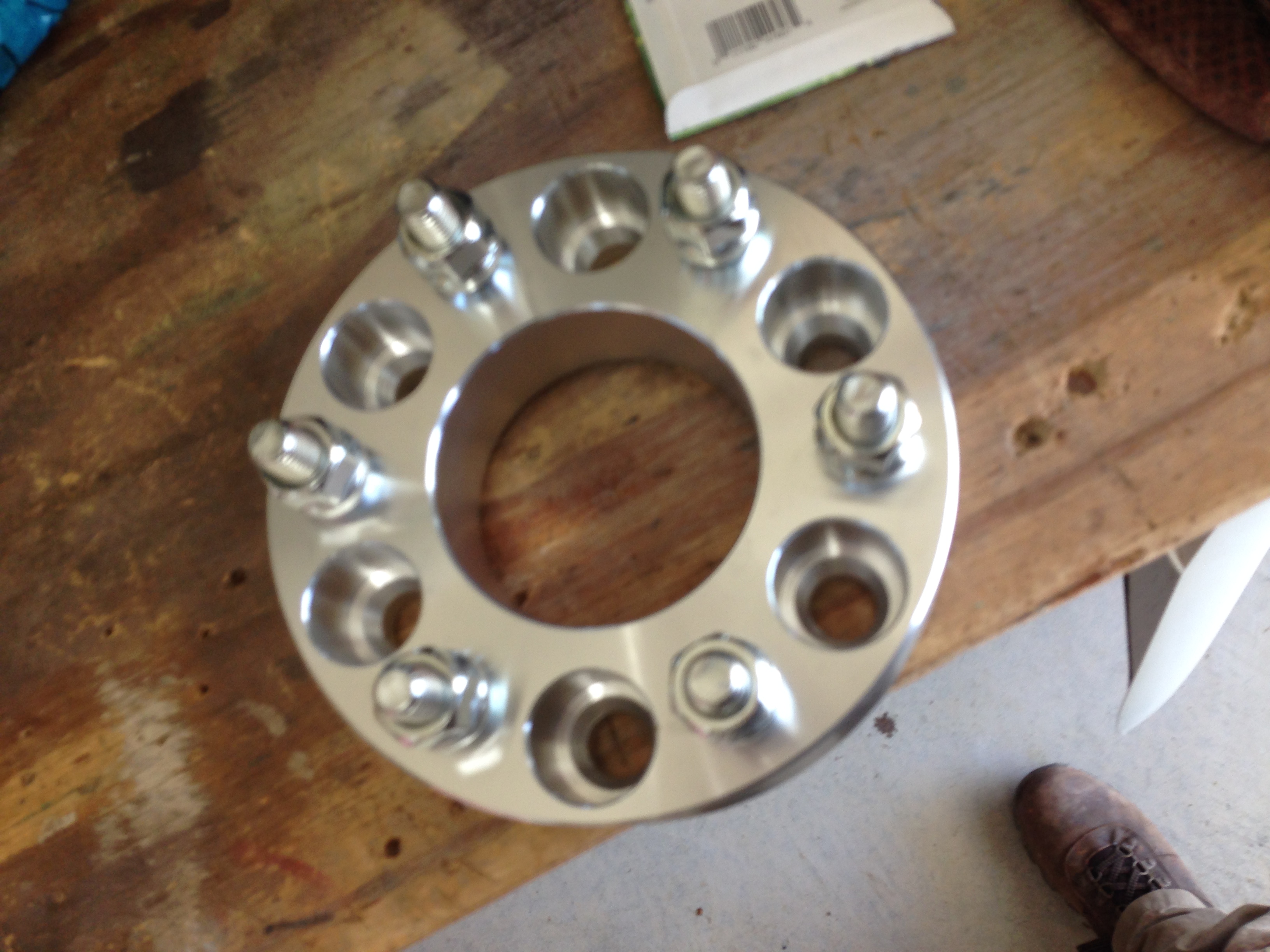

Got my spacers today, install tonight after church then the tires this weekend

by Fisker » Thu Apr 14, 2016 8:48 am
I got my spacers in last night, driving to school today I noticed my steering wheel shaking a bit around 60-75mp. I know there is a post somewhere on her about someone having the same problem and they fixed it. If you know where that post is or have advice on how to fix it I would appreciate it

by Jrgunn5150 » Fri Apr 15, 2016 6:44 pm
My advice is, pull the tires and make sure the spacer's are properly, completely torqued, then reinstall your wheels and make sure they are on properly as well.
by Fisker » Fri Apr 15, 2016 8:58 pm
Thanks, I asked the shop I went too for tires to take em off and reinstall them and they did it for free. 85% less shaky. I think the other portion is the new tires. They are more aggressive than the performance tires I had on before. And 2.2 inches bigger and bouncier. ( basically rides more like a truck) this will take getting used too
