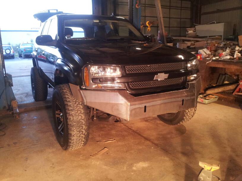

Image[img]http://img.tapatalk.com/d/13/06/09/arupy6aj.pg[/img]
by ErikSS » Sat Jun 08, 2013 1:04 pm
I'm getting there!
by bartonmd » Sat Jun 08, 2013 2:13 pm
Lookin' good!
That hoop should have had ~3" or so on each end to cut off for it to be the right height? I assume you tacked it up on the vehicle, before you welded it on? If you didn't, and you end up thinking it's too high, you can just cut it off, grind the bumper smooth, and put it where you want it. This is obviously best done before the shorter, smaller pieces of tube are welded onto the back side.
BTW, you'll want to go over that with a flap disc when you're done, or your grinder marks on the seams will show up.

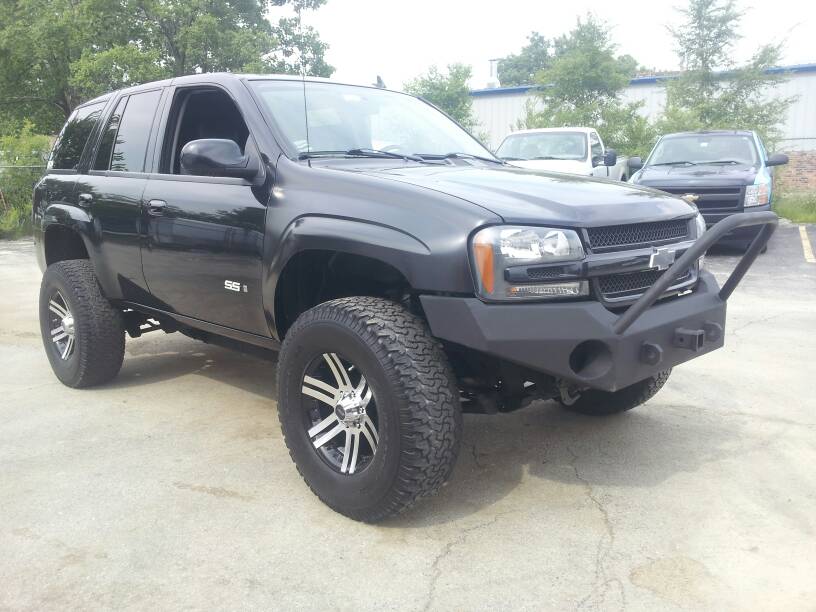

by ErikSS » Sat Jun 08, 2013 8:50 pm
As it sits...

by Trail X » Tue Jun 11, 2013 6:39 pm
Except for the stinger, I am a fan. I'd love to tear up a dirt road sideways in that thing.
