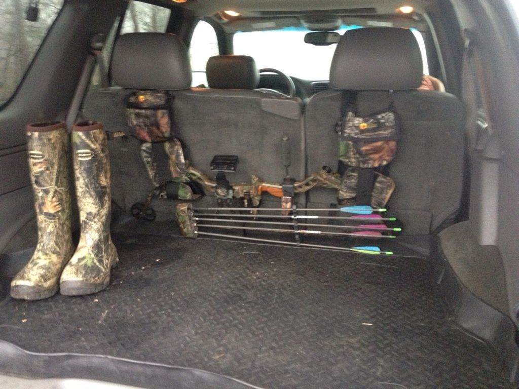

Does anybody have any ideas on how to hang or mount a bow in my cargo area? i cant really think of anything. lol

Put it on the floor in it's case? But seriously, Bass Pro and others have those over the seat sling type mounts for bows and long arms.

BTW this is the only thing i have found so far to hold my bow in the back. and is half assed!! :( ugh
That's why i like the case on the floor. Does it swing at all? I wouldn't like my sight box slamming into the seat like that.

As for my bow. i drive pretty normal and it doesnt really swing to much. Im thinking about using two poll that expand in the back windows and some vel-cro straps to hold it. But idk where i could find some expanding polls. But that would work for guns and a bow or anything else really as long as it holds pretty well.
