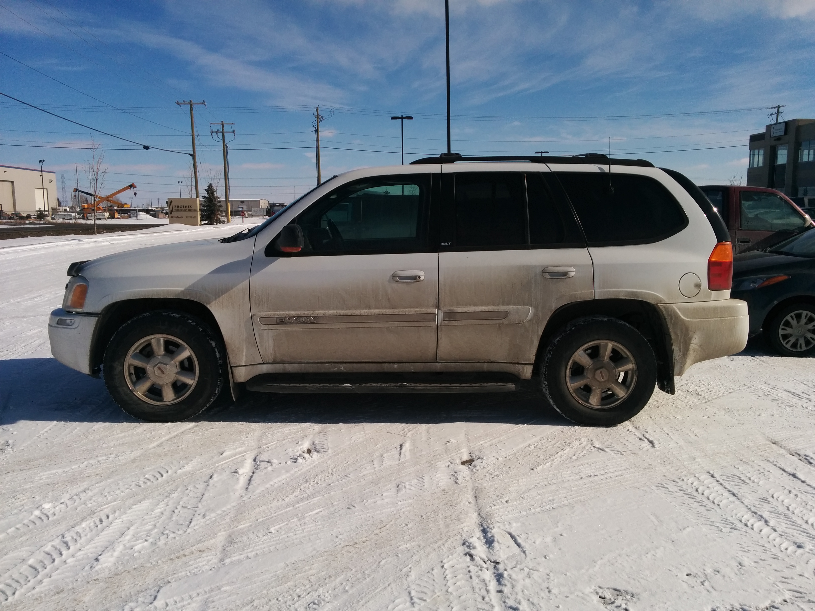

Hello there. I have been lurking for some time now, and doing a lot of research. This forum is a great resource. I thought it would be a good idea to post about my Envoy, future plans, and concerns.
Currently Stock:
-2002 GMC Envoy SLT with (2HI, A4WD, 4HI, 4LO)

Current stock Envoy.

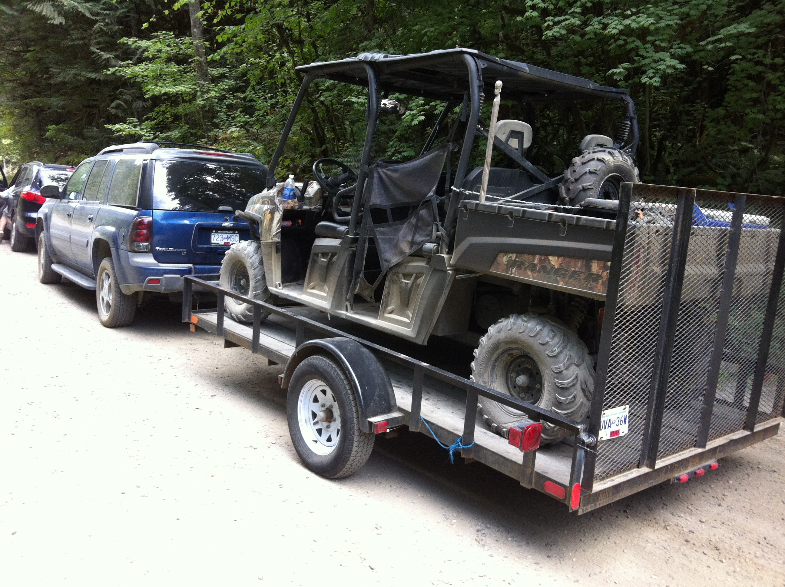

It looks like you have a nice starting point for your build. You have one of the better gear ratios, with 3.42 being the worst, and 4.10 the best factory options. If you go with Tahoe/Yukon rear springs, you'll gain an inch or so lift from them, even without a lift block, and since they are progressive rate, you should still be OK for towing. I fitted them to my 05 EXT TB, along with a 1" rear Liftmeister block and 2.5" front lift, and have no problems towing a flatbed trailer and Polaris Crew model atv, which probably weigh similar to your trailer.
By the way, you don't use a button for the G80 locker, it is self activating, by sensing wheel spin. Works great in mine.

Brad, are you running wheel spacers? It doesn't look like it in that picture you posted. Do you have any thoughts on towing while running wheel spacers and the extra wear that might have on the bearings?

by BC backroader » Tue Feb 28, 2017 6:47 pm
No wheel spacers yet, though I plan to get them. I don't think they'll have a huge effect on bearing life, but can't say for sure. Not having the spacers limited my choice in tires, which I changed shortly after the above photo, from the stock 245/65/R17 to taller 245/75/R17, which just barely clear the upper ball joint bracket, the limiting factor of tire size on our trucks, unless you get the spacers.
