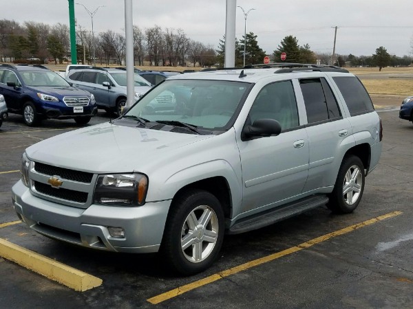

Hello everyone.
We sold our 2003 2WD EXT in 2012. Recently I got bit by the bug for an off road capable daily driver and thought how much we loved that truck. I ended up finding an 08 4WD with only 51k miles and jumped at it. As of Saturday, I am back to TB ownership.
Originally I wanted the 5.3, but know that the 4200 Atlas is so smooth and has plenty of power for daily driving, although I will probably make some changes because that is who I am!!
I found this site when the bug hit to get some ideas of what can be done, and have made a small and growing list of mods:
Lift (either body/suspension or both) with 32" or 33" tires
Cat back exhaust
Kooks header and cat (this will be a little while, need to save up)
Cold air intake
Fabbed front and rear bumpers
Safari rack
Rock sliders instead of running boards
If anyone has any thoughts, opinions, recommendations; I would appreciate it.

by BC backroader » Mon Jan 23, 2017 11:25 pm
Welcome, ksucatz, sounds like a solid platform to start from. The 4.2 doesn't gain a lot from intake and exhaust work, so you might want to put that money into re-gearing for the bigger tires, if you have the 3.42 gearset, which is the most common in our trucks. If you lucked out and have the 3.73 or 4.10 gears, you get to save that money, too. Looking forward to your progress with the new toy.
by rScherzer » Tue Jan 24, 2017 10:51 am
I noticed a little better performance with the ECM flashed and the cat gutted. I would take that over spending a ton of money on the intake and header. Plus the stock intake works pretty good for keeping all the water/snow/dust/bugs/ and small children out of the engine. If I was going to invest in a header I would take the next step and put a turbo on it as well. Mark Mc has a 3" suspension lift that is really good and the price is cheap. Like BC Backroader has mentioned about gears. Check your RPO/SPID label in the glove box. your looking for G80 that is the locking rear diff, and GT5 is 4.10 gears. I believe GU ot GT4 is 3.73. There is a thread on here that breaks down all the RPO's for the gear sets.
Your going to need spacers if you want to run that big of a tire with those wheels or you can get adapters and change the lug pattern to a more common 6x5.5 That makes it so much easier to pick a wheel combination that will work.

by HawkeyeC25 » Tue Jan 24, 2017 10:59 pm
Nice looking rig! Looks like you have solid plans! I agree with these guys on the spending money in the right place... headers, cats, and full exhaust will cost you about the same as a new set of gears and probably a locker. Which will get you a lot farther as far as putting power to the ground. Keep us posted on what you have to work with!
