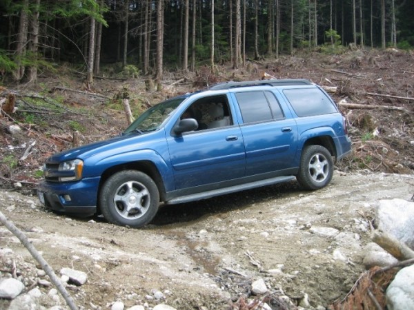

The test run today to check out the repairs and lift went very well. Though the BDS5500/Z71 combo is stiffer than the stock setup, it's just right for my taste, giving firm cornering at speed on the highway, yet not too much jounce in the potholes and washboard common on the logging roads I love. In places where I had been bumping and scraping the skid plates, running boards, and frame before, I was able to drive through with no touching at all; perfect!
before the lift
After the lift

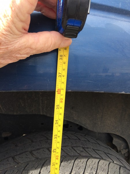

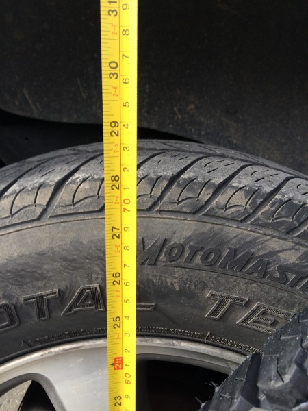

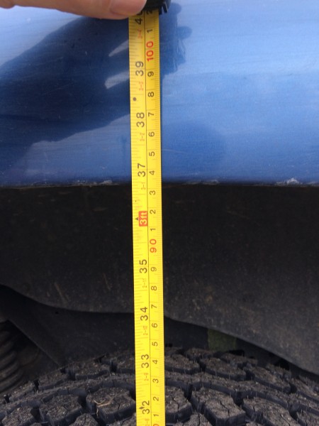

I finally got the AT tires I've wanted for the truck since I bought it about 18 months ago. Canadian Tire had a very good sale price on their Motomaster Total Terrain AT2s, 245/70/17, at $142.49 each, $660 CDN with all taxes and enviro fees in, for the set of 4. I had a local shop install and balance for 1/2 what Canadian tire quoted. I gained between 3/4" and 1" of ground clearance, and of course much improved traction on the trails than the all seasons that were on the truck when I bought it. A bonus benefit is that the Cobra cable chains for my GMC 3500 now fit the TB as well, though I have to cinch them up to the very last catch to get them tight enough.
My impression so far is that they hum a little at low speed, but are no louder than the old Hankook all seasons at highway speed. I'll update info after I get them out in the wet, in snow, and on the logging roads. I'm sure they'll do much better than what was on there before.
New ride height
Old ride height
New all terrains
Old all seasons
new & old side-by-side
