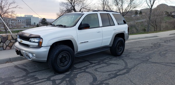

I bought the Spohn Adjustable Panhard Bar. I'll be installing that this weekend. Get them rear wheels recentered.
Also...Somehow I glazed the brakes when I installed the wheels and spacers. So, now I will be doing the bigger brake bracket/disc upgrade next.
Adjustable Panhard Bar Not installed in this picture.

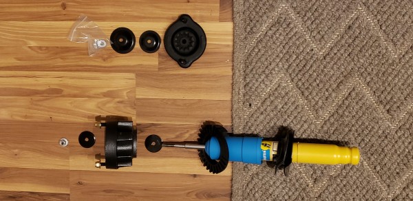

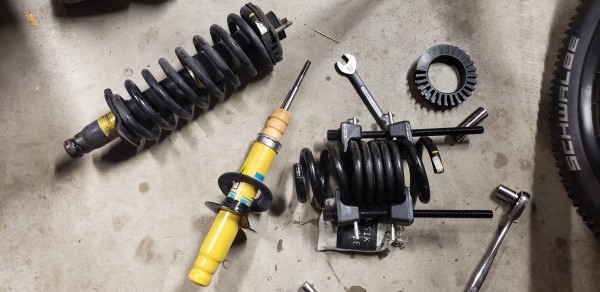

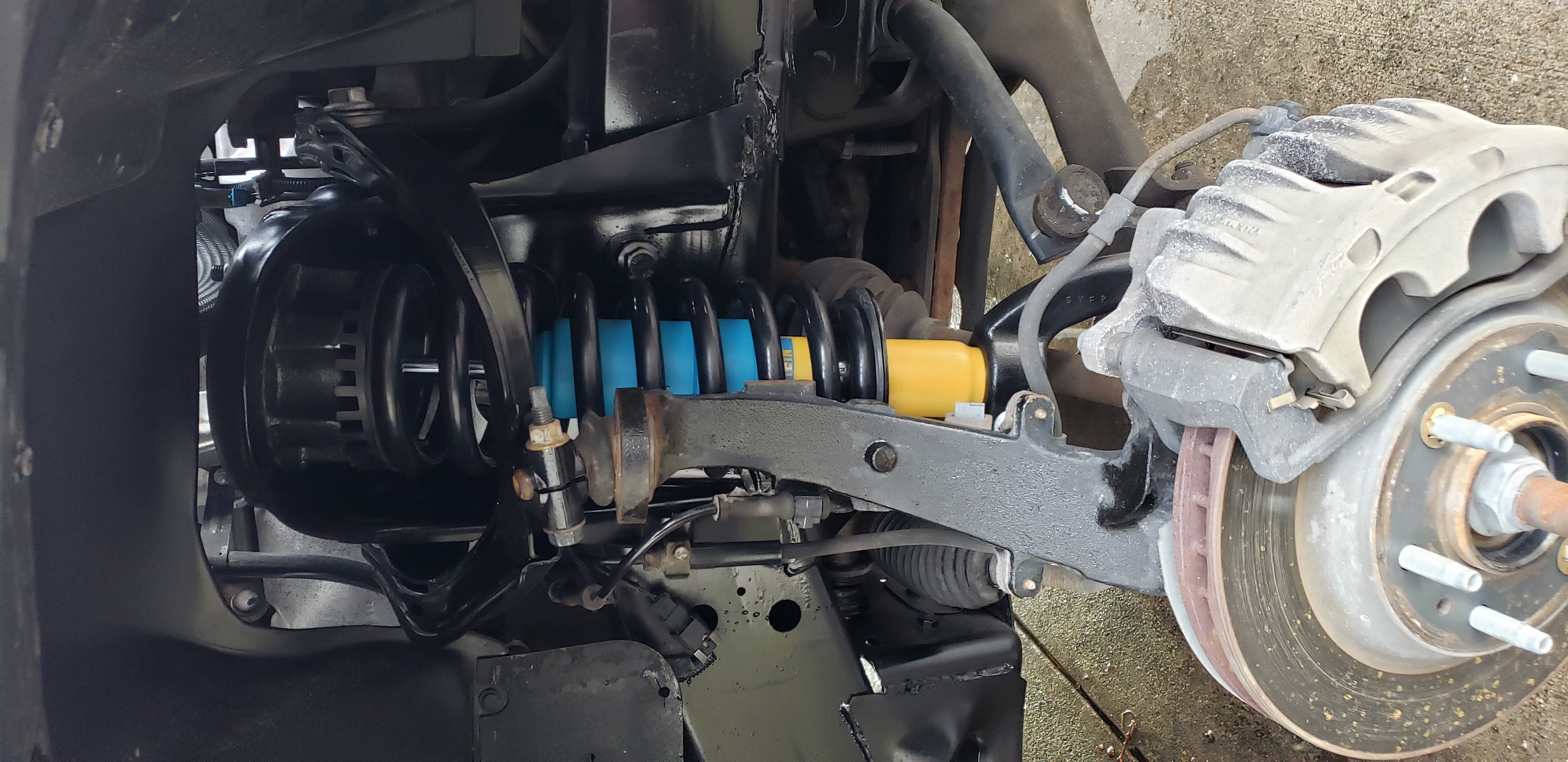

Here are some progress pictures of the front lift installation and UCA flip/swap.
Used everything on the left. Nothing on the right.
I compressed that spring waaaayyyyyy too much. Not necessary and maybe not safe.
All done.

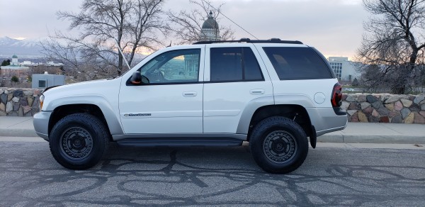

Progress pictures.
Lift, Spacers, and Tires installed. Little high in the back.

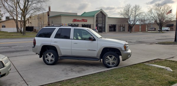

Completely Stock. No Mods.
