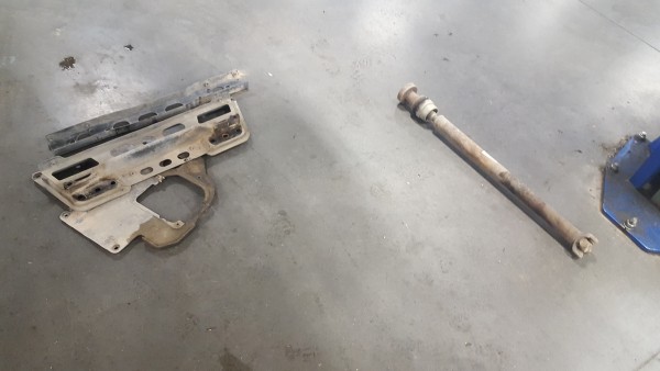

Front lower Air deflector/ chin spoiler ripped off!

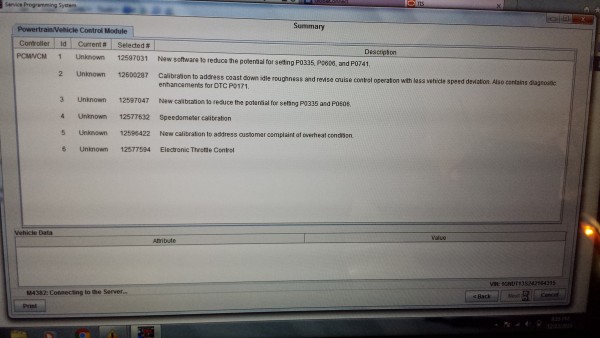

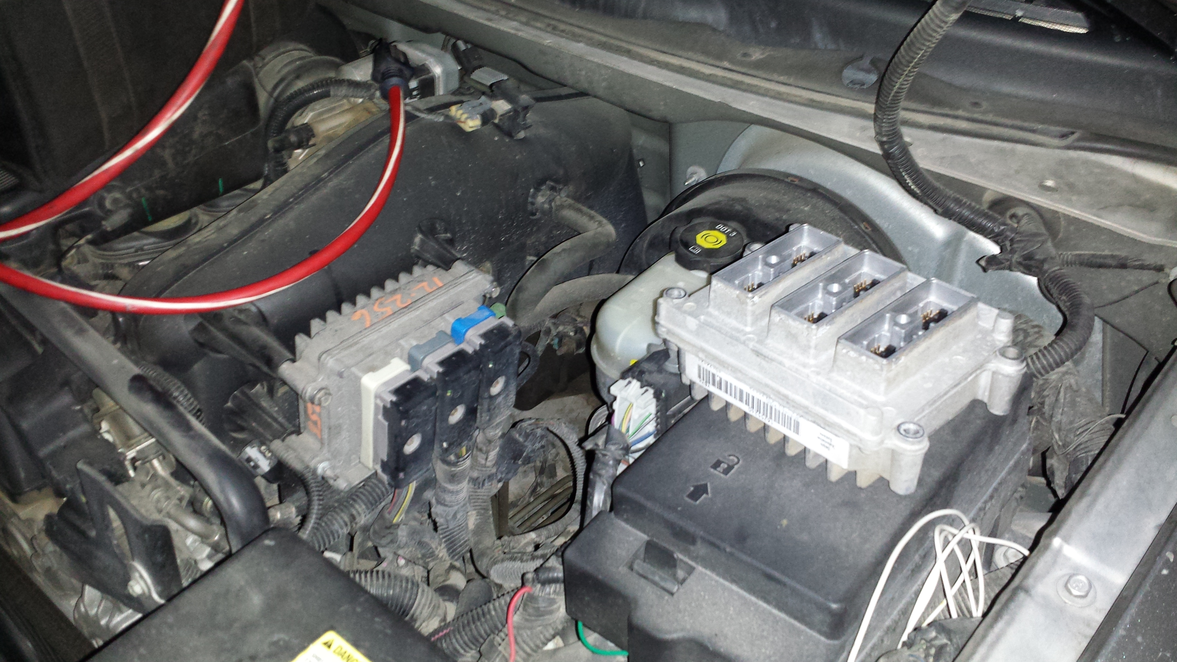

Earlier this week I picked up a scrap yard PCM so I could have mine sent out to be programmed. I plan on putting 4.10 gears in latter so I had flashed my PCM with a vin that had 4.10 calibrations. I flashed the second (scarp yard PCM) to my T.B. so I could continue driving while waiting for the other. I had the catalytic codes disable. I had gutted the cat a few months ago after the O2 reported a 420 code. Today to PCM showed up. I installed it and now I will sit and wait til 5'O clock to go drive it!
***Update*** PCM was a fail. The reason is mine got mixed up on a order with someone else. The tuner guy said he only flashed my vin back to stock but retained the 4.10 calibrations. The SES (Check engine light) came back on for a P0420 code. I contacted PCM of NC and they Fixed the problem. I had also found out that I had flashed a different calibration to emissions into my ECM. It was looking for Secondary air system and VVT. I spent a few days looking for a VIN that had the same emissions calibrations RPOs EVA, FE9, NF7 and GT5 (4.10. I found one on a scrap vehicle on ebay! I'll share it here for any of you that may want to go this direction and have to pass smog. (You can also have the tuner guys turn all that stuff off, so I have been told) The vin is for a 2002 Trailblazer with GT5 and previously mentions emissions cals. 1GNDT13SX22176855. From what I have gathered you program this vin in and then have the tuner people force in your vin#. The calibrations for the GT5 stay and everything looks legit.
***Update#2*** PCM showed up, road test to find shifting feels a touch firmer. Perfect for me as I drive on ice covered roads and tow. I don't need a 2nd gear shift and then spin out on the ice! The tune for the engine feels good. the speedometer is off by a lot. (3.73 gears but programmed for 4.10) That's the next project. Fuel economy has dropped from 16ish mpg to 14ish. Its been snowing so a lot of that is due to driving in 4wd for days on end. No check engine light and I/M flags all passed. Emissions tested the vehicle (because it was due) Passed with flying colors.

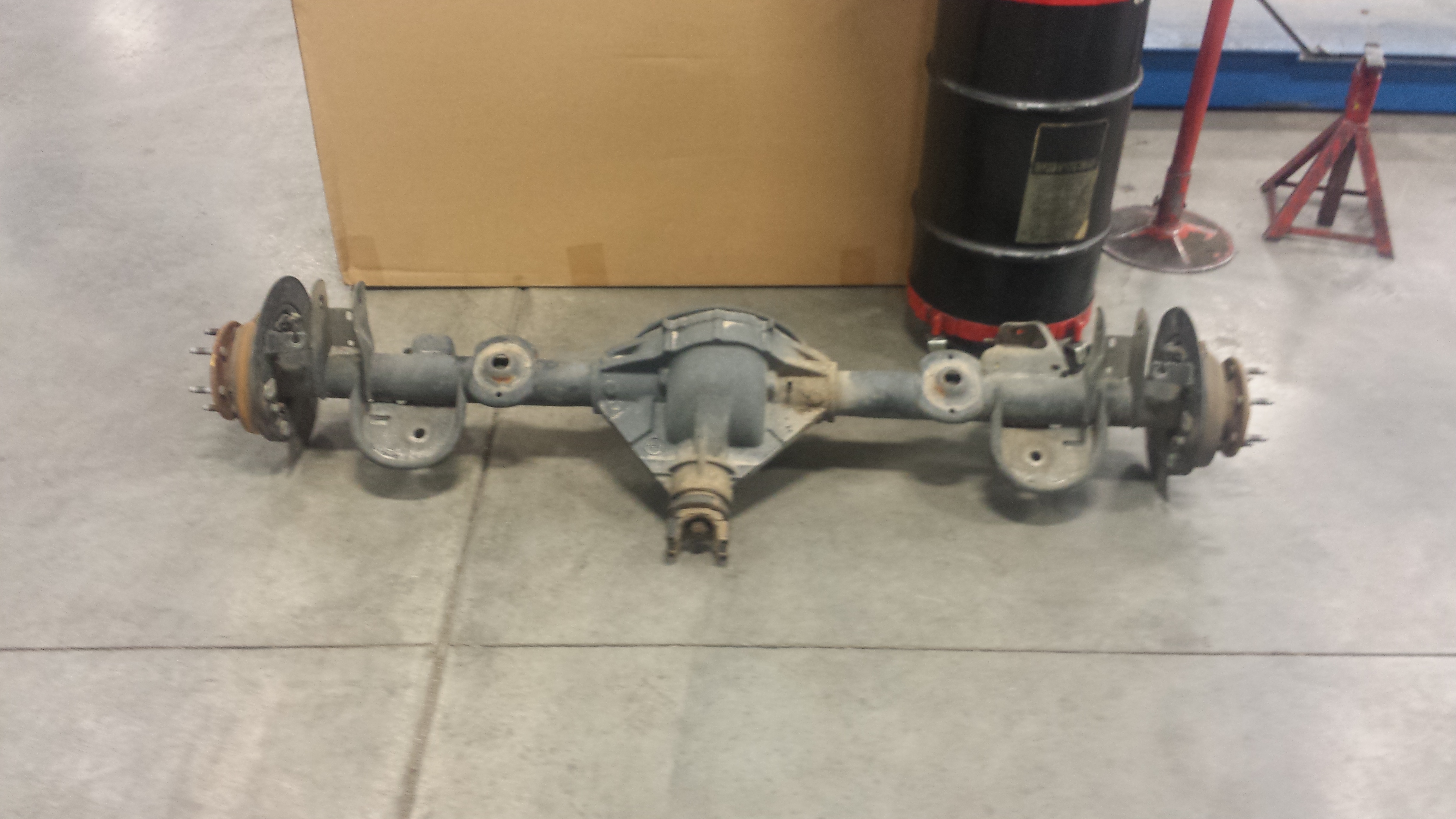

by rScherzer » Fri Dec 30, 2016 7:37 pm

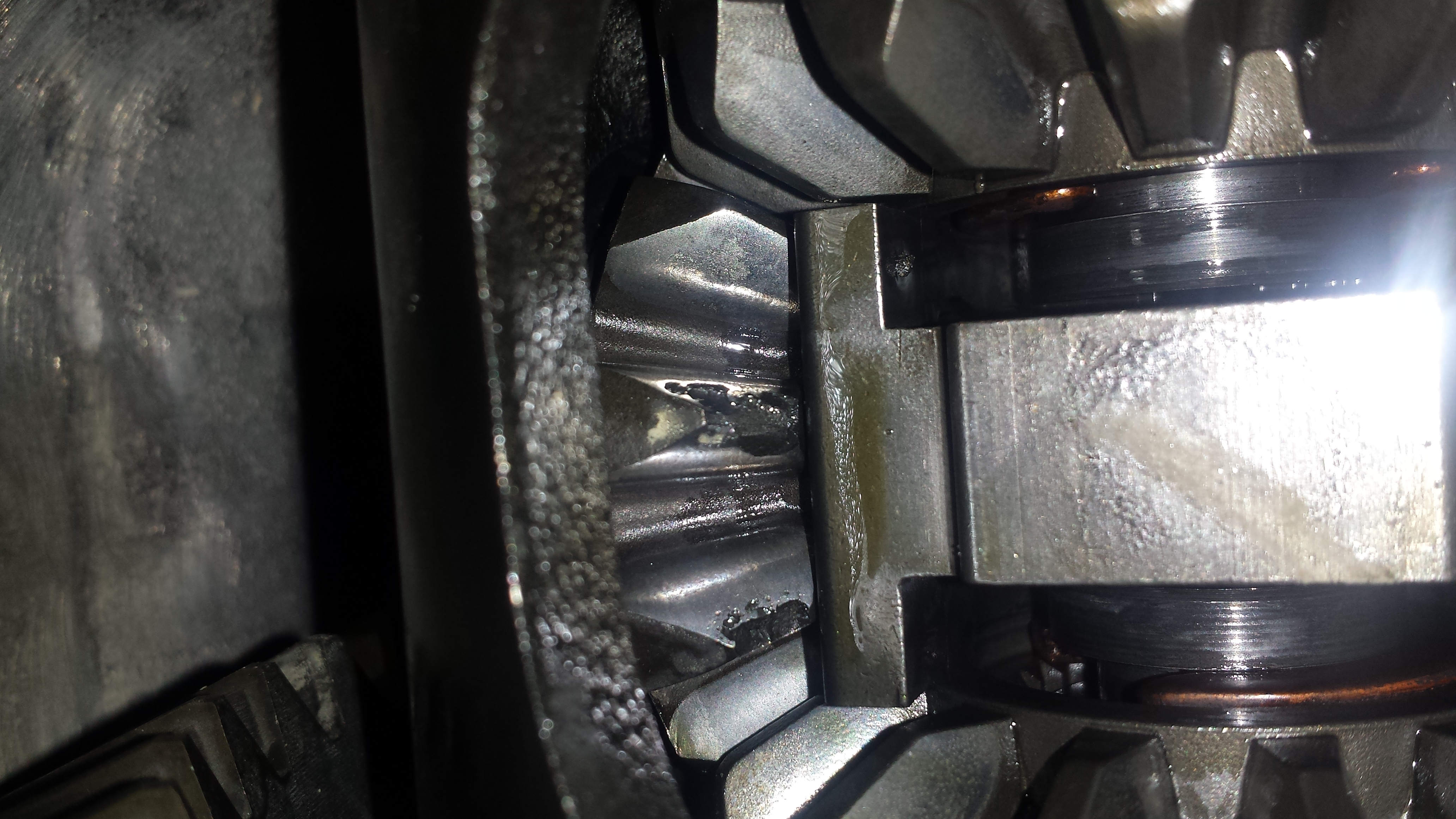

So I found a used rear diff with 4.10 gears and G80 locker for $175.00USD. I had to jump on it felt like a good deal. It showed up today so i did a little inspection on it. Found a little bit of chipping on the spider gear but nothing that will hurt it for normal service. Now all I need to do is save a few doll hairs for the front.
I would also like to put a few reasons why I felt I needed or wanted to go to a 4.10 gear ratio.
1st With the over sized tires I wanted a little more go power out of the hole. Not that I'm a drag racer or any thing its just nice.
2nd Occasionally I pull a trailer for a friend, (not heavy), but later on I plan on buying a trailer that is going to be quite heavy (5k-6k) empty. So the 4.10 gears will help with that.
3rd I didn't have a locking rear diff so every now and then I would get stuck where the G80 would have pushed me over-threw what ever I was doing.
4 th why are you still reading this....I'm married I could come up with a ton of reasons that don't realy matter!
Chipped spider gear. Not going to hurt or affect operation
140k miles from a scrap yard.

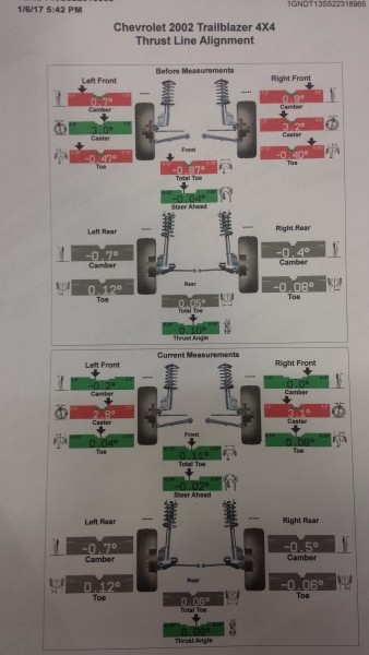

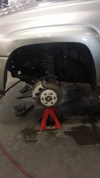

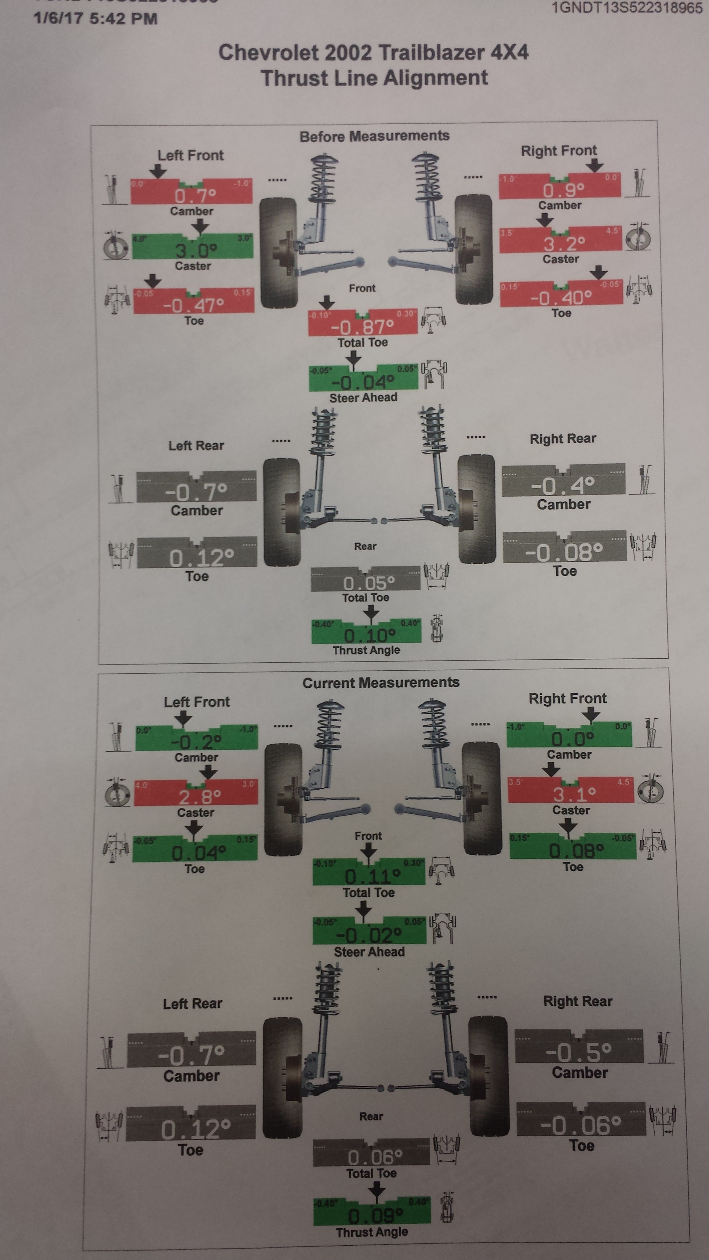

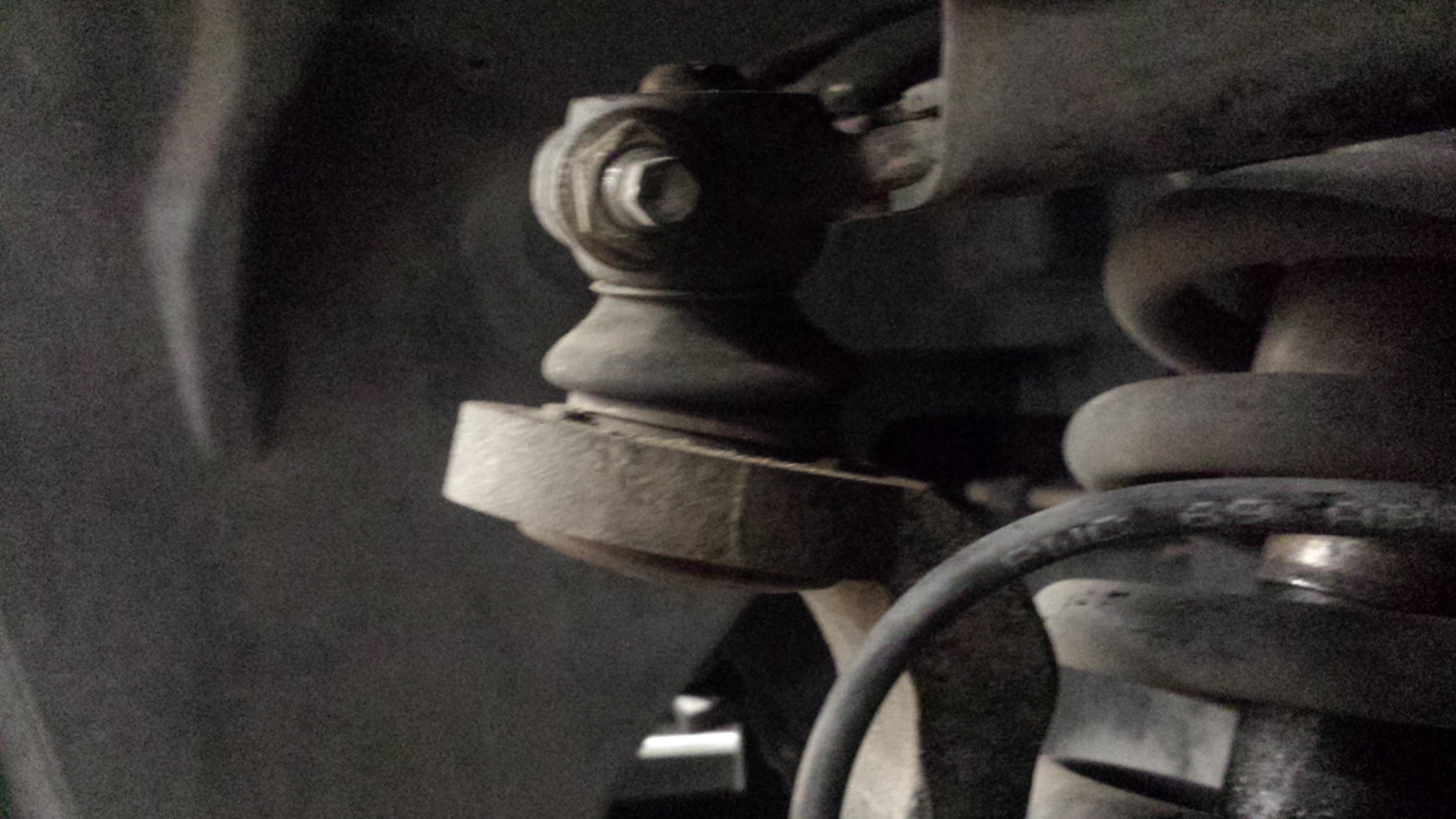

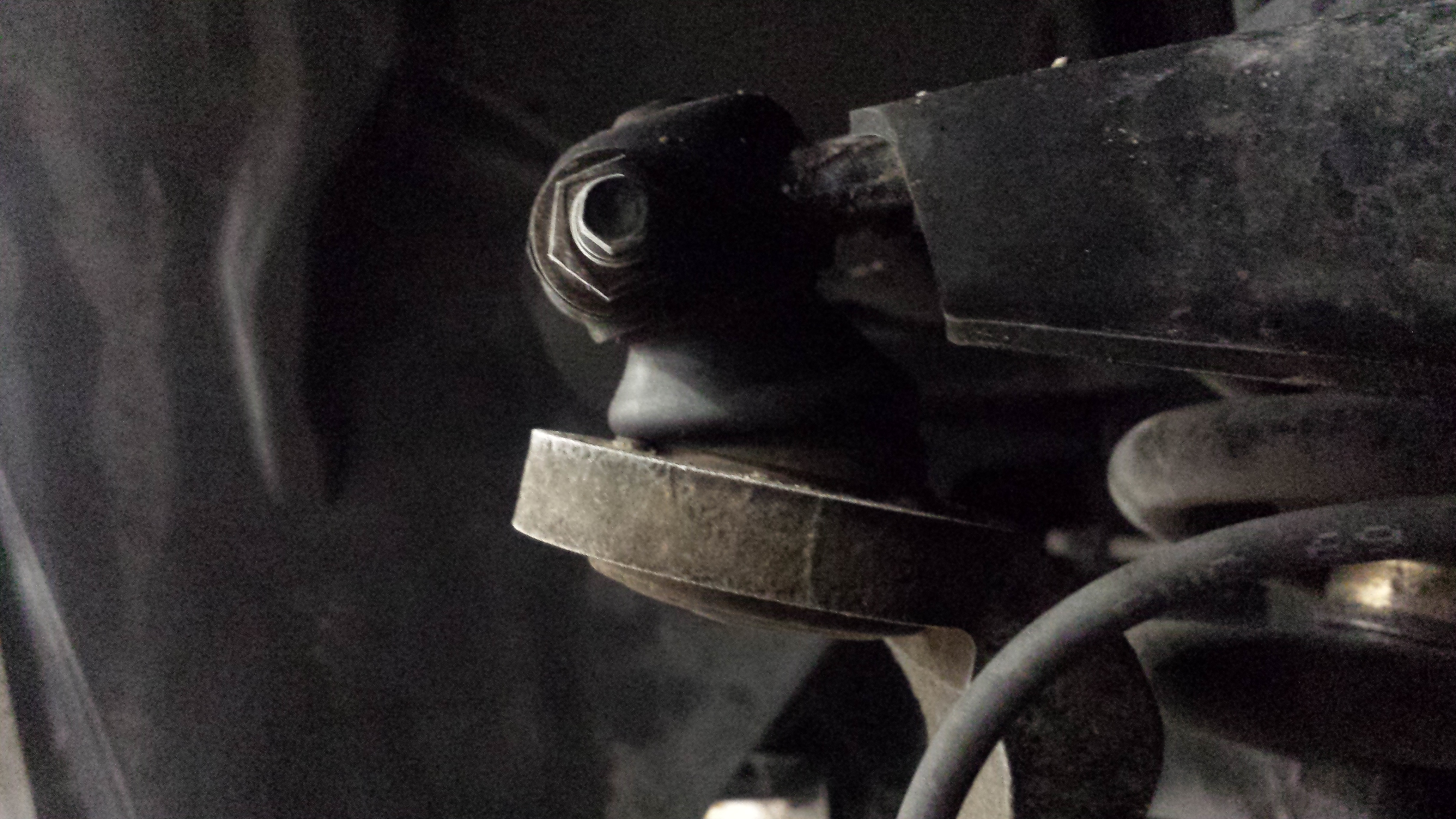

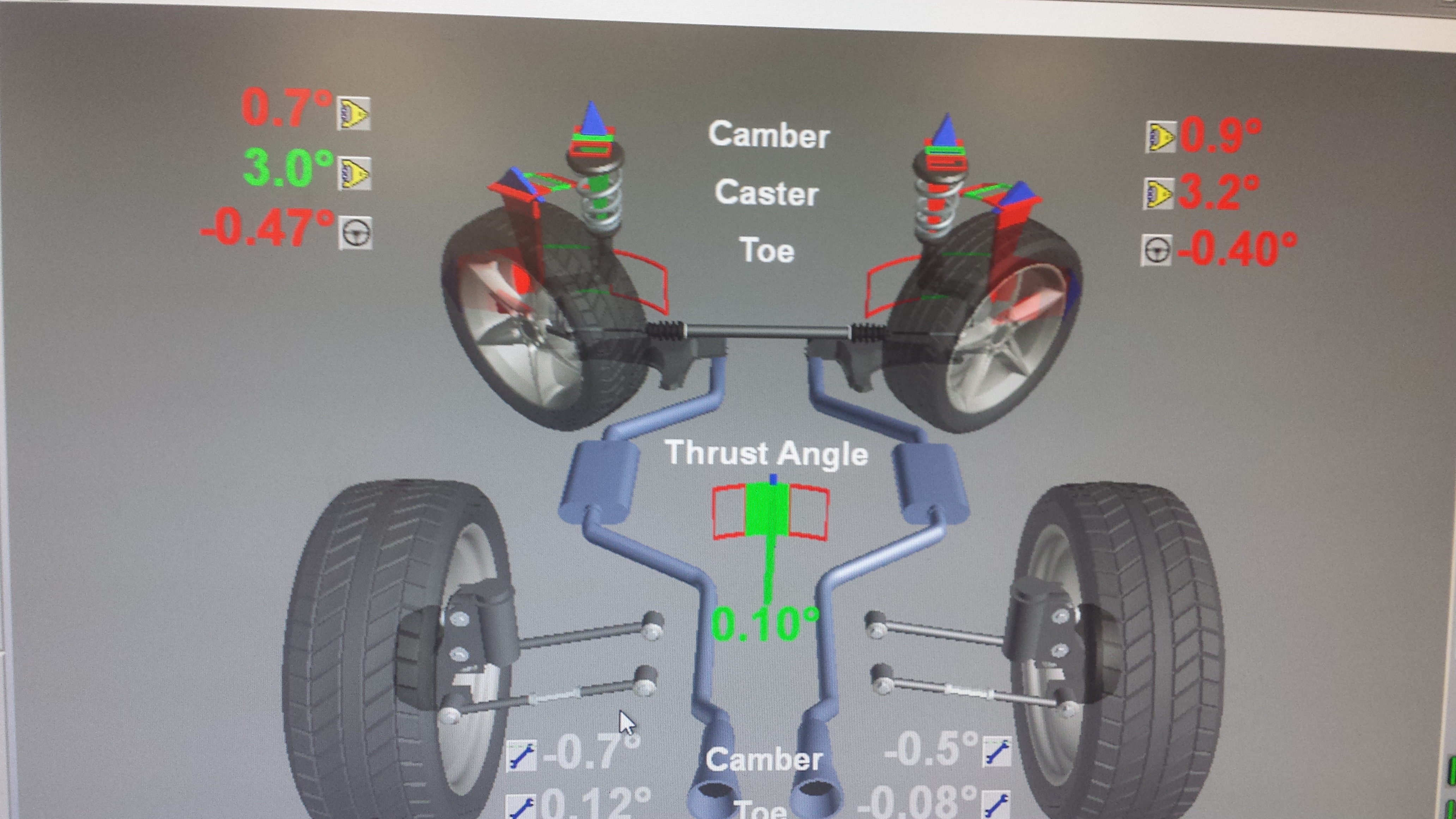

The upper ball joint is at a funky angle with the control arm in the stock location. A lot of members on here have flipped theirs so I wanted to also.
The job was not hard at all put the front end on jack stands. 21mm open end wrench 15mm socket and wrench, and two zip ties. Look at the wheel adapter, it was -6 F out when I pulled it in the shop. Thats frost forming on it!
Upper control arms flipped. Here is what the ball joint looks like now!
I had already set the alignment the night before but I knew this would make things all over the pace
A little adjusting to get it just where I wanted it. It looked good. The drive home was fantastic for a lifted Trailblazer. I did forget to mention that the front shocks blow out today when I lifted it to remove the tires. :wallbash: I guess I'll add that to the list of stuff that needs to be fixed or replaced.

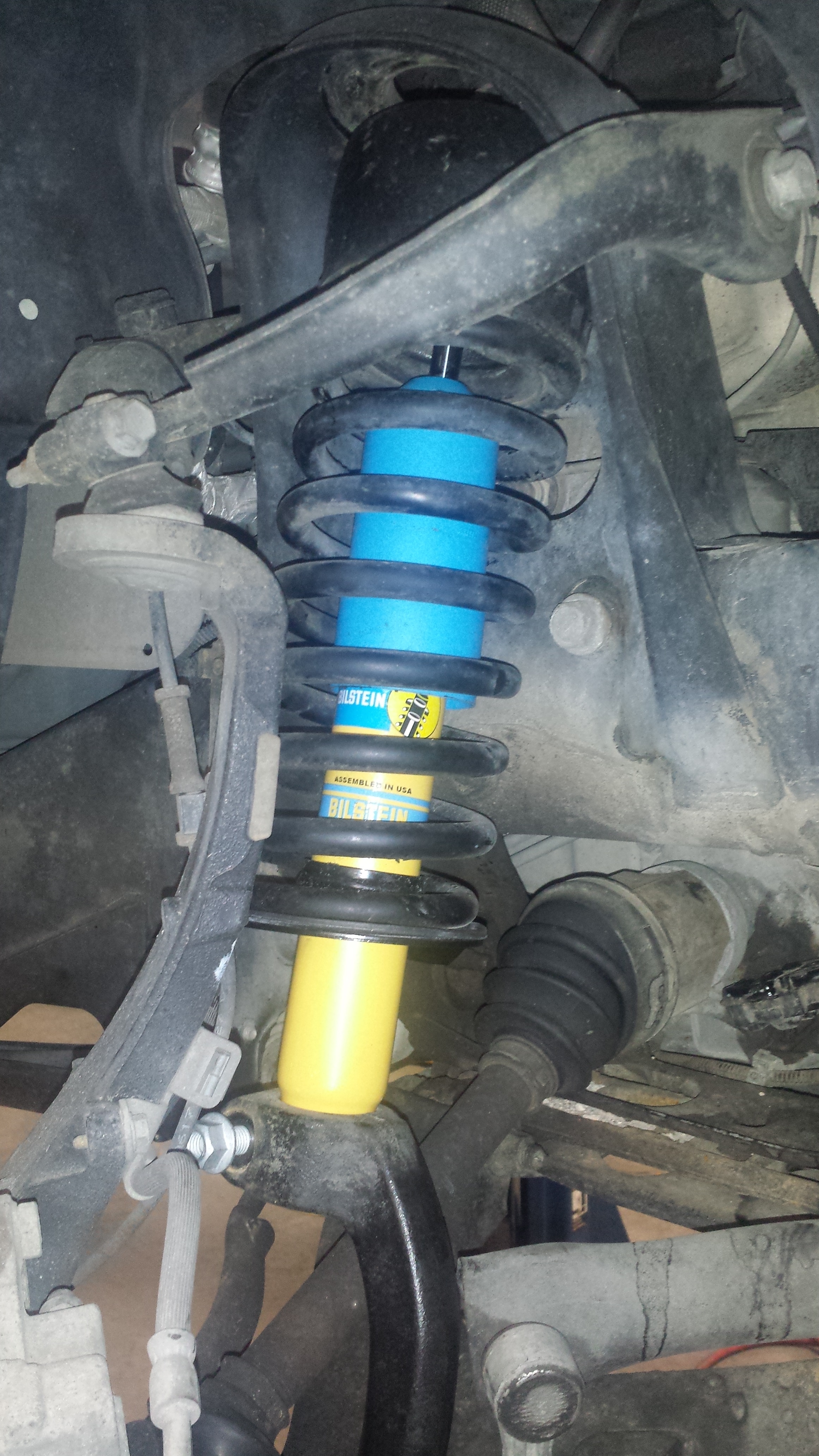

by rScherzer » Sat Jan 28, 2017 7:01 pm

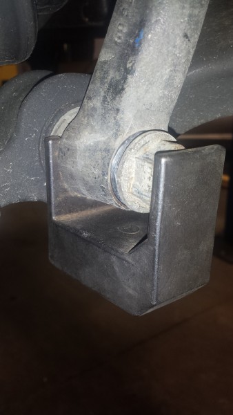

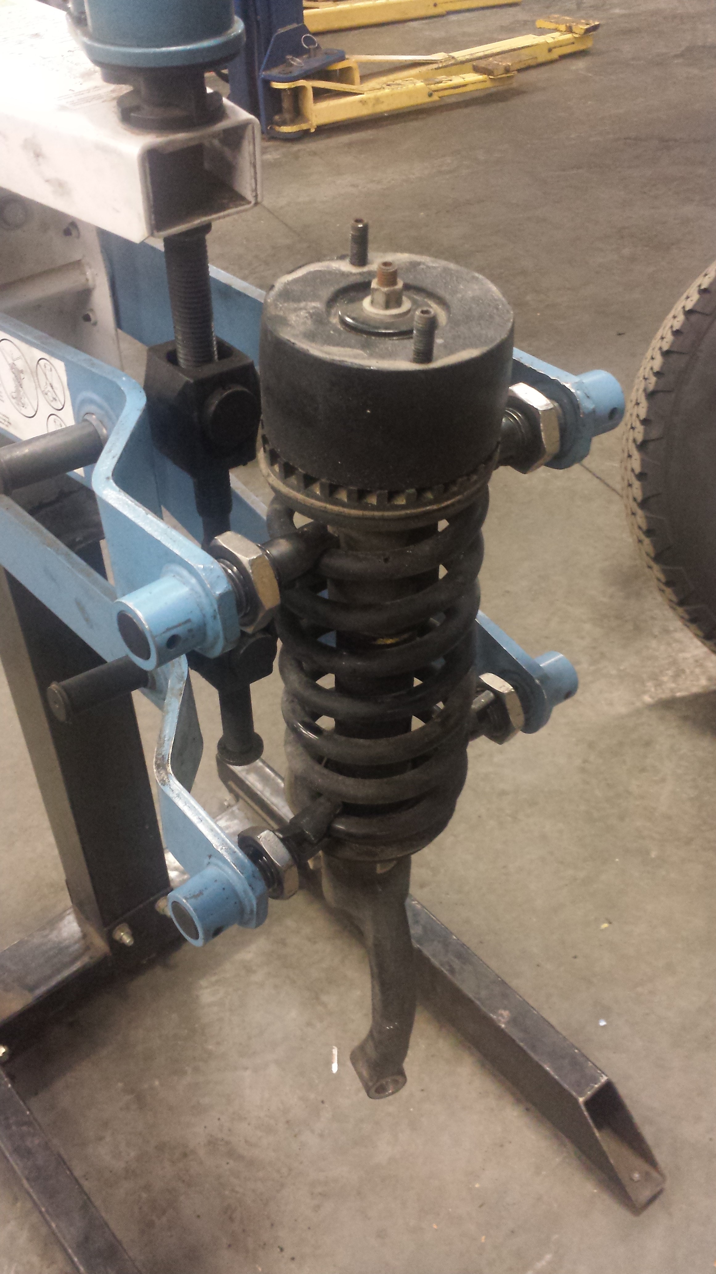

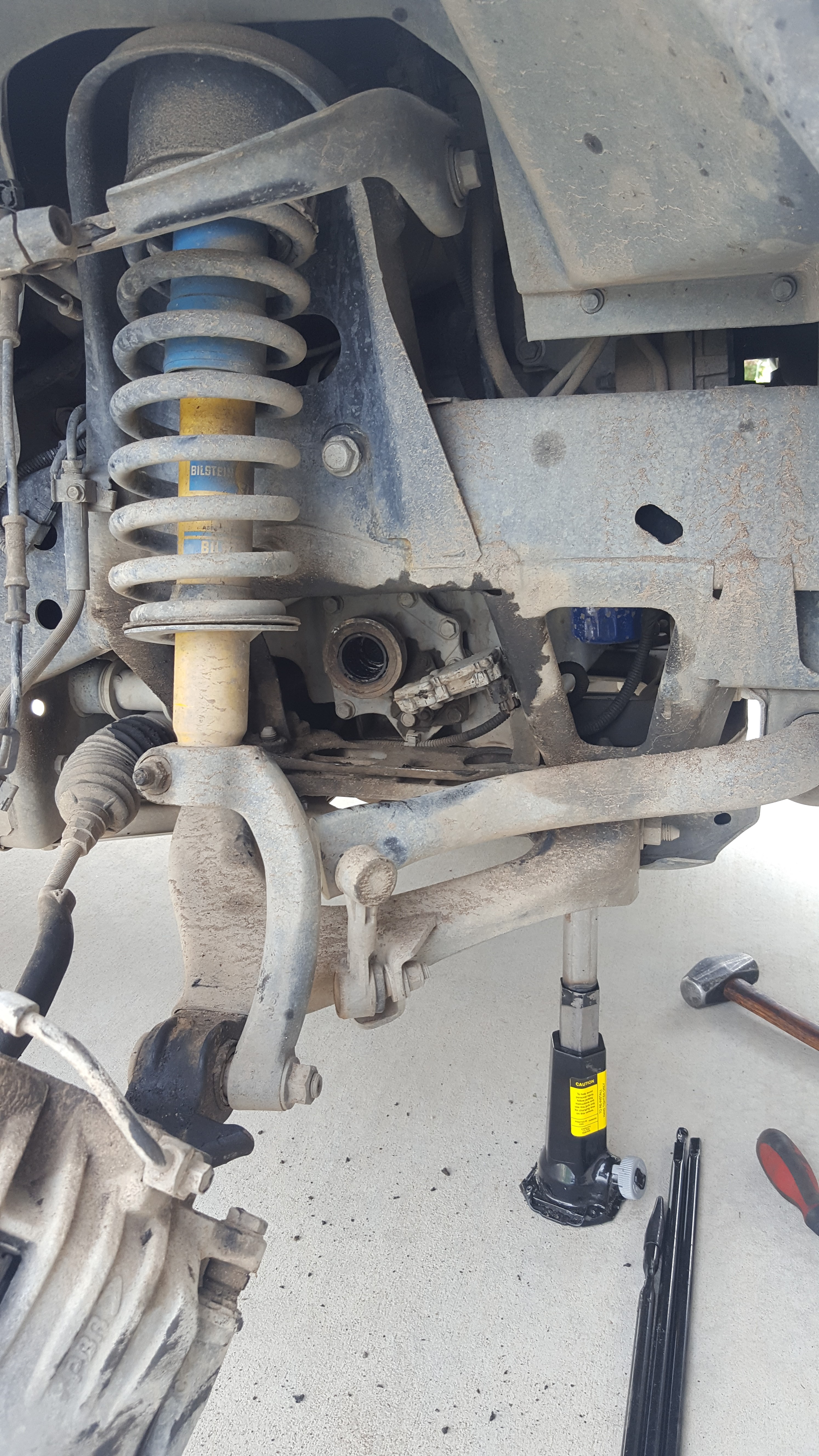

So today the TB went under the knife again. I should have just put the HD Bilstein shocks in the front when I did the lift. :wallbash: But I like to do things, then do them agian.,,,, and again some times the hard way, or cheap way. Any way New front Bilstein shocks up front :excited:
The extreme cold weather and high miles was all she could take, Leaked all the good stuff out!
GM special tool to help pop that lower part off.
Spring compressors make this a walk in the park!
Shocks is in and looks good!

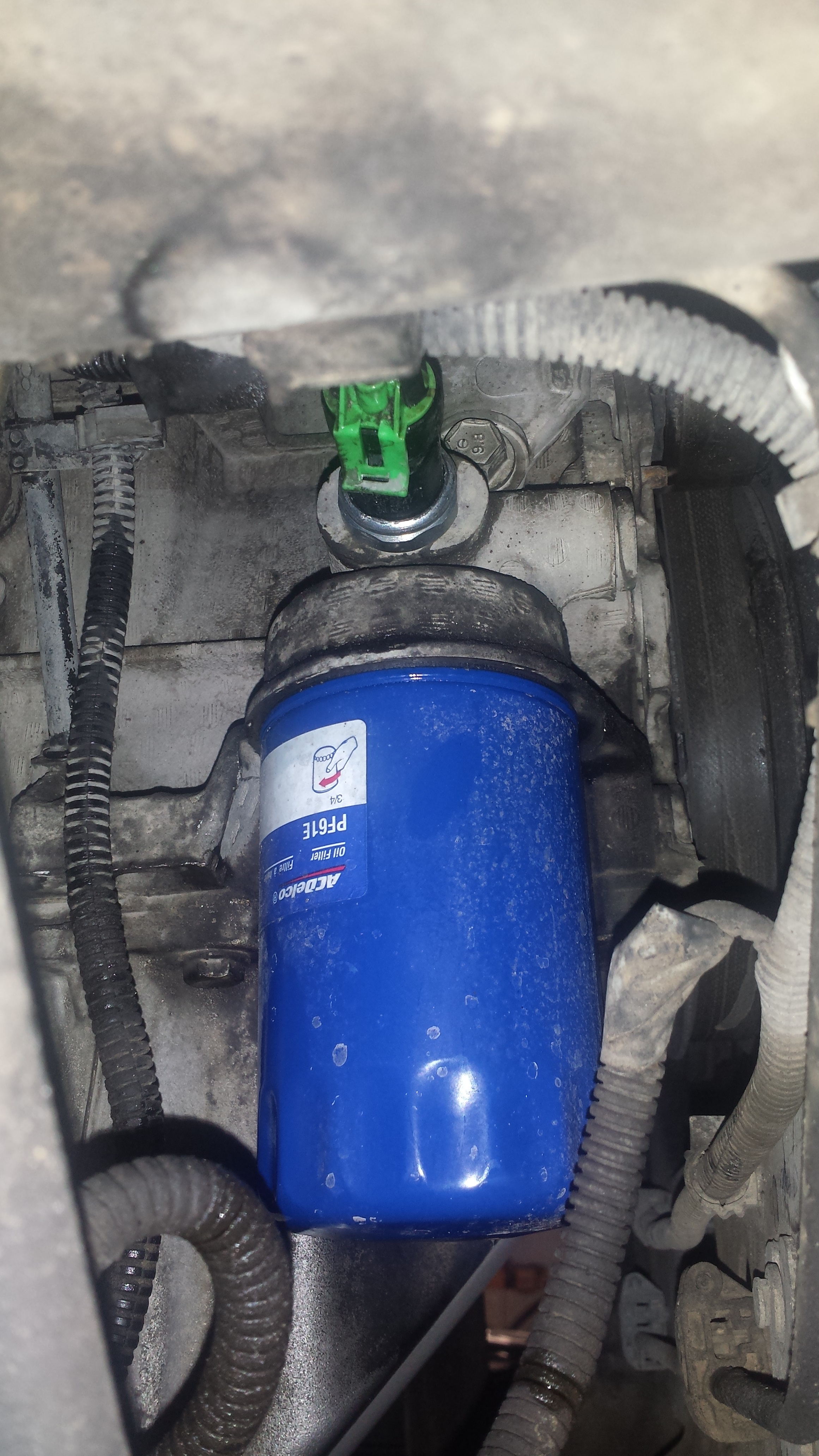

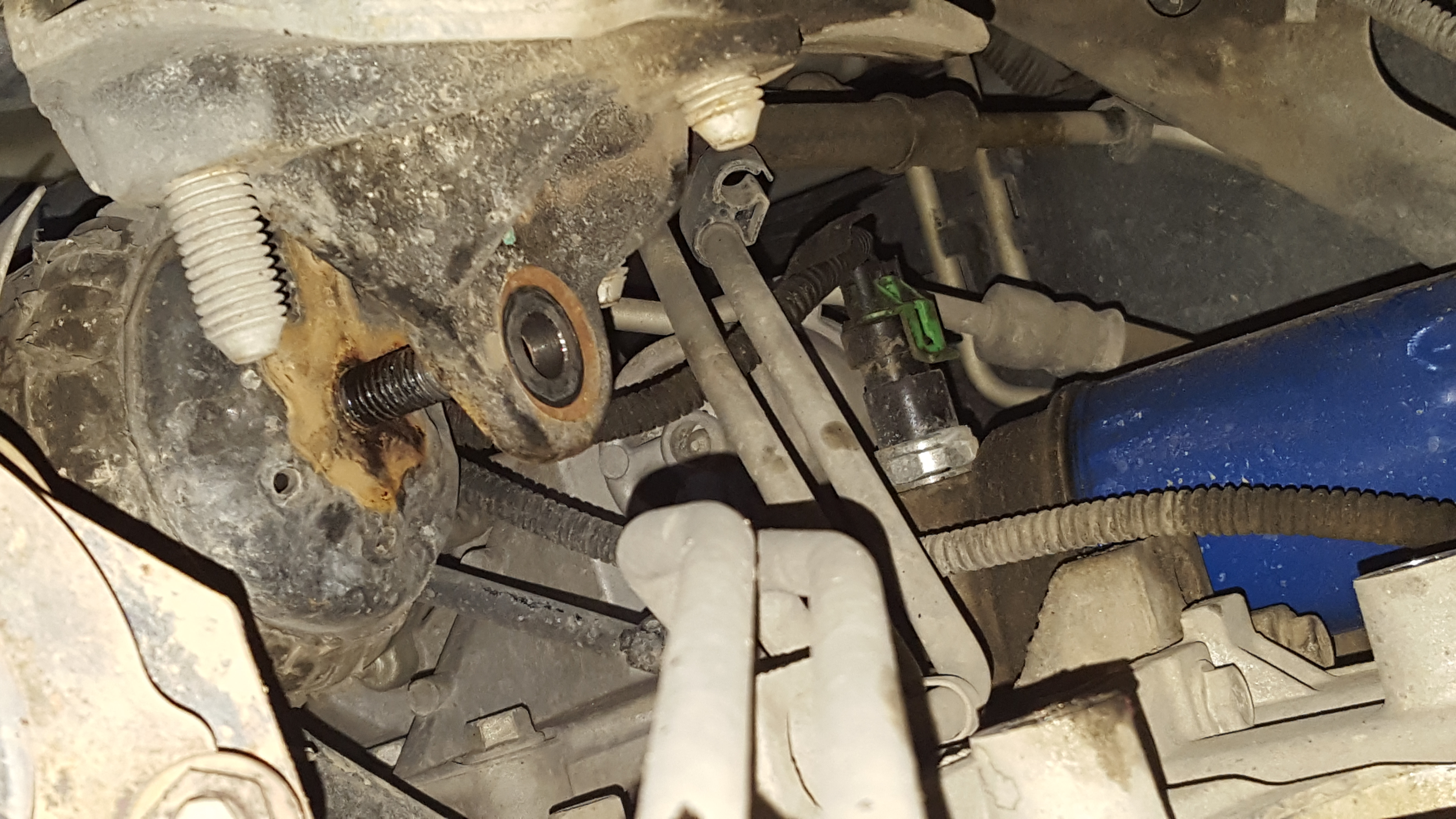

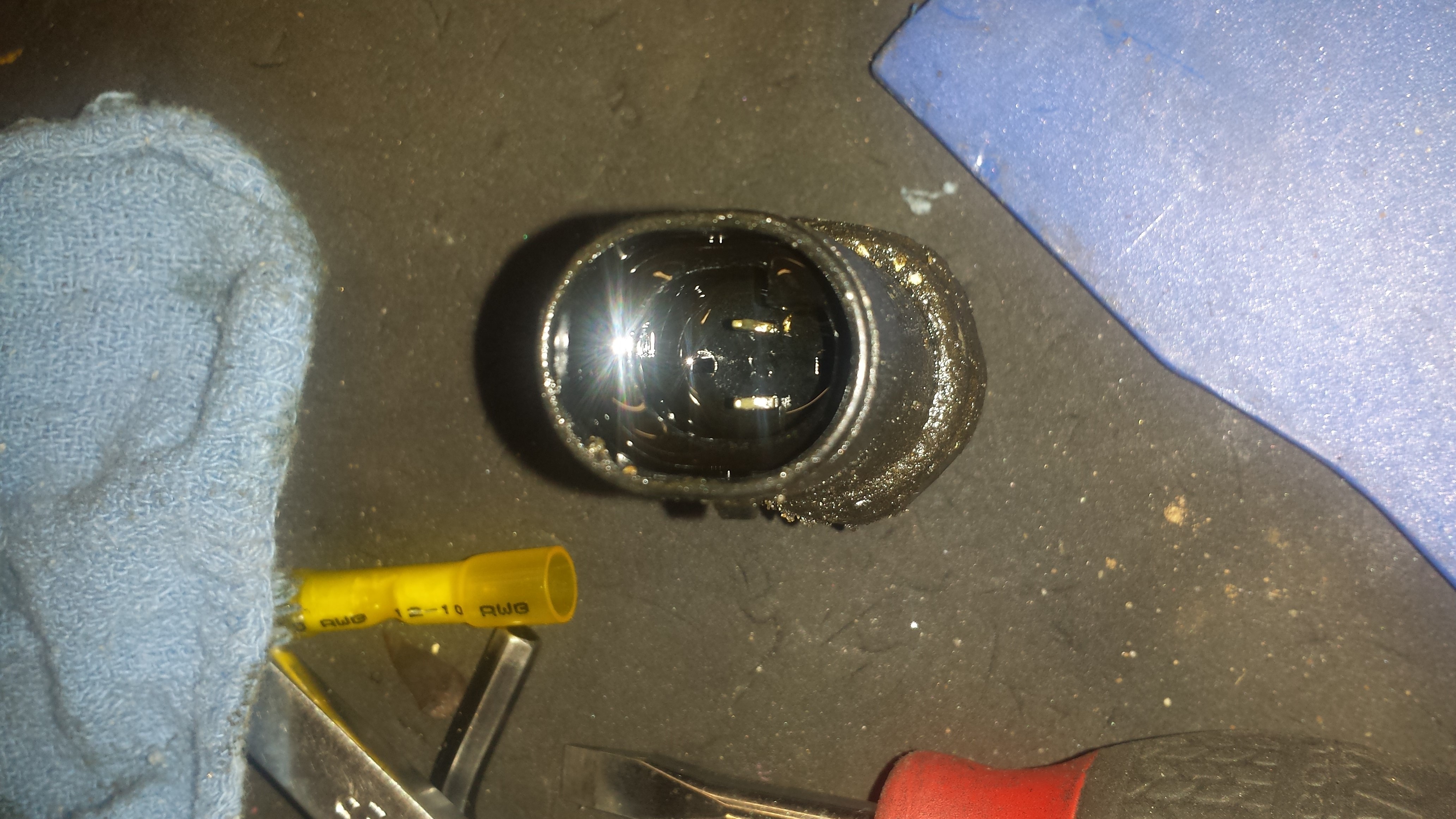

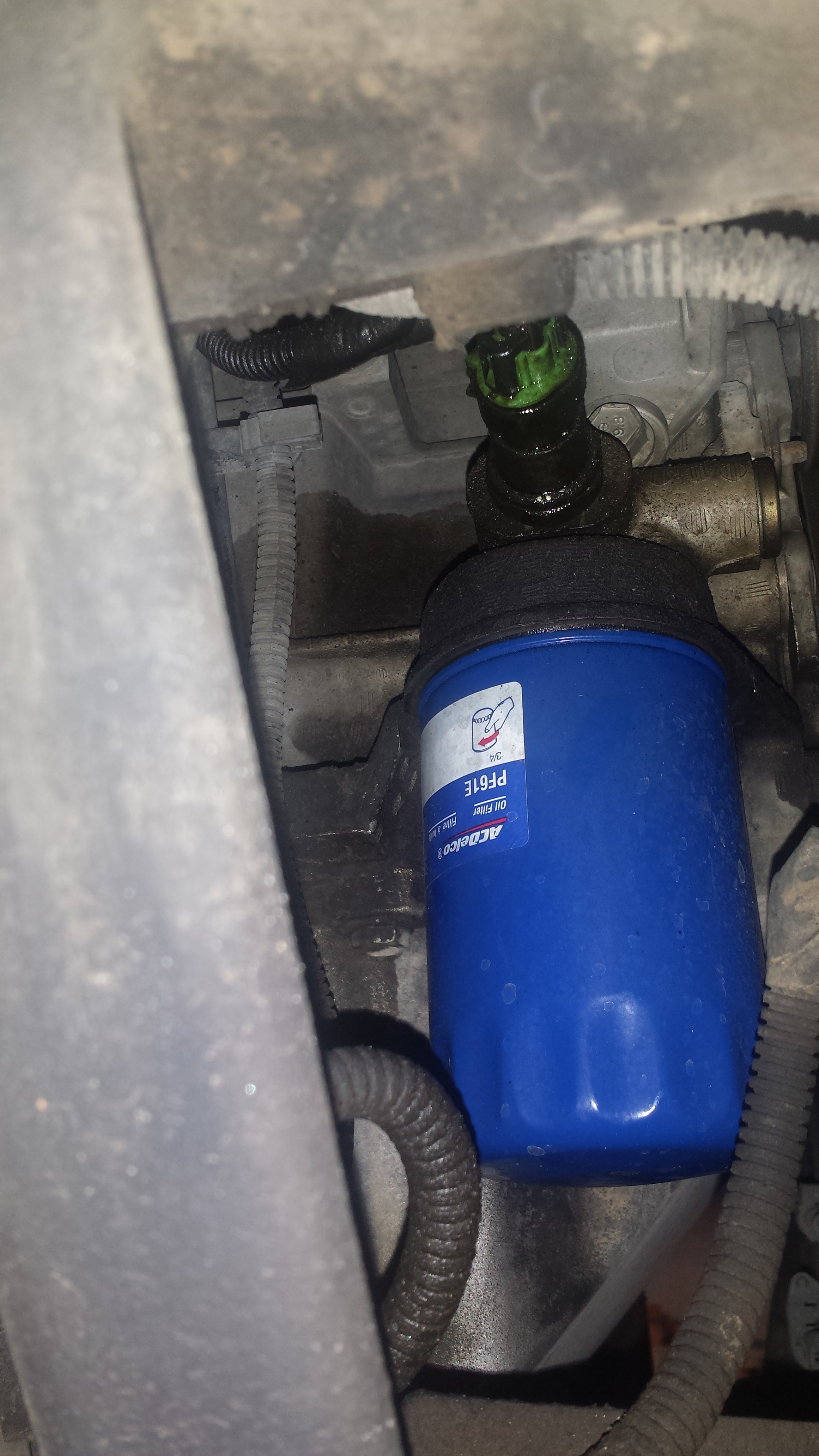

:mechanic: I may have gotten this a bit messed but while working on the front suspension I noticed a oil leak. 42 doll hairs later I installed a new GM oil pressure sensor. Pictures are for your entertainment. I almost forgot to say that last summer I noticed when sitting at a red light and it was hot out (100+ DegF) that the oil gauge would bounce to zero. Im thinking this may also be part of the problem....If not I'll always wish it was!
Leaking oil pressure sensor
Oil leaking out the back side of the sensor.
New oil pressure sensor installed

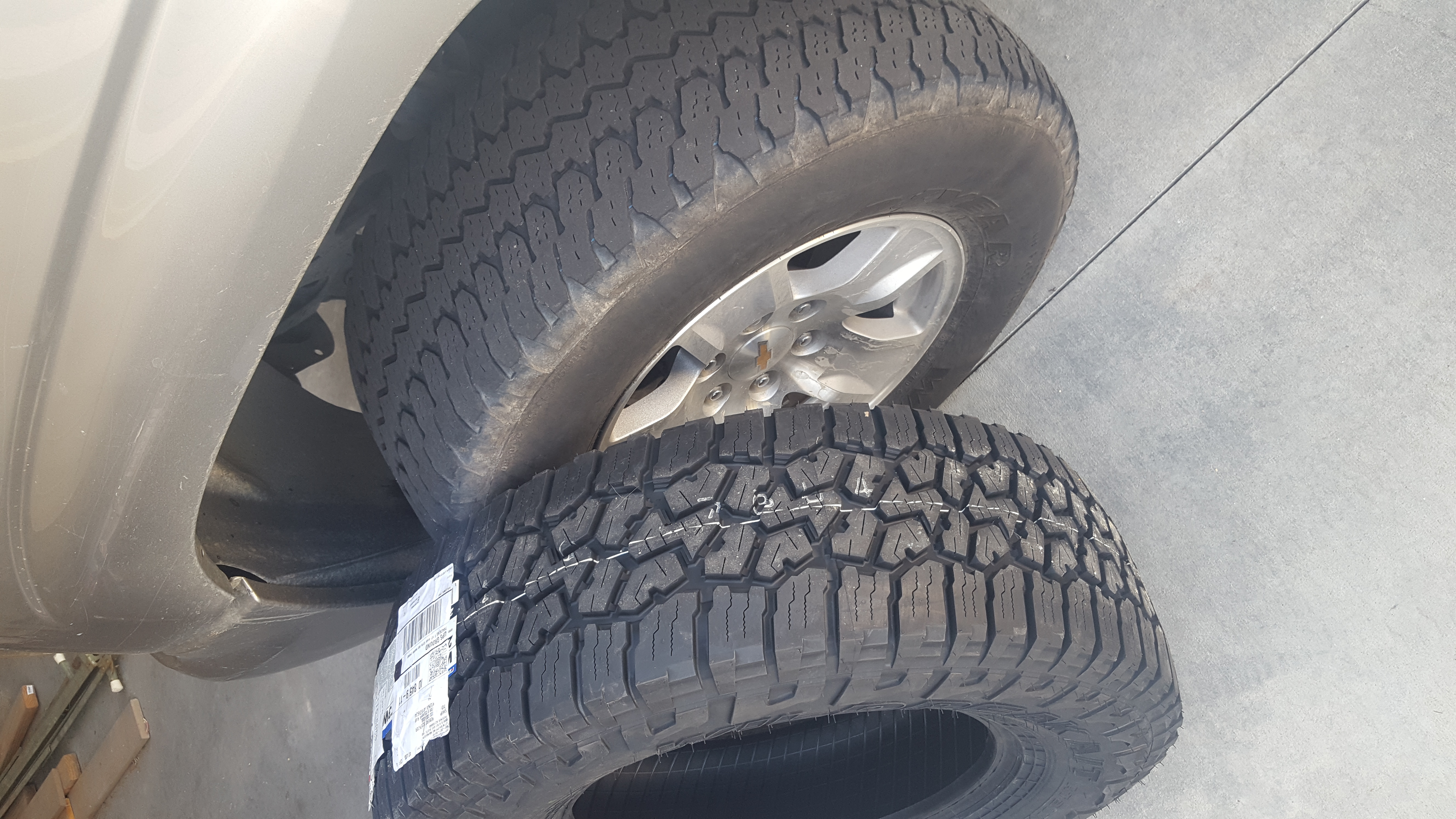

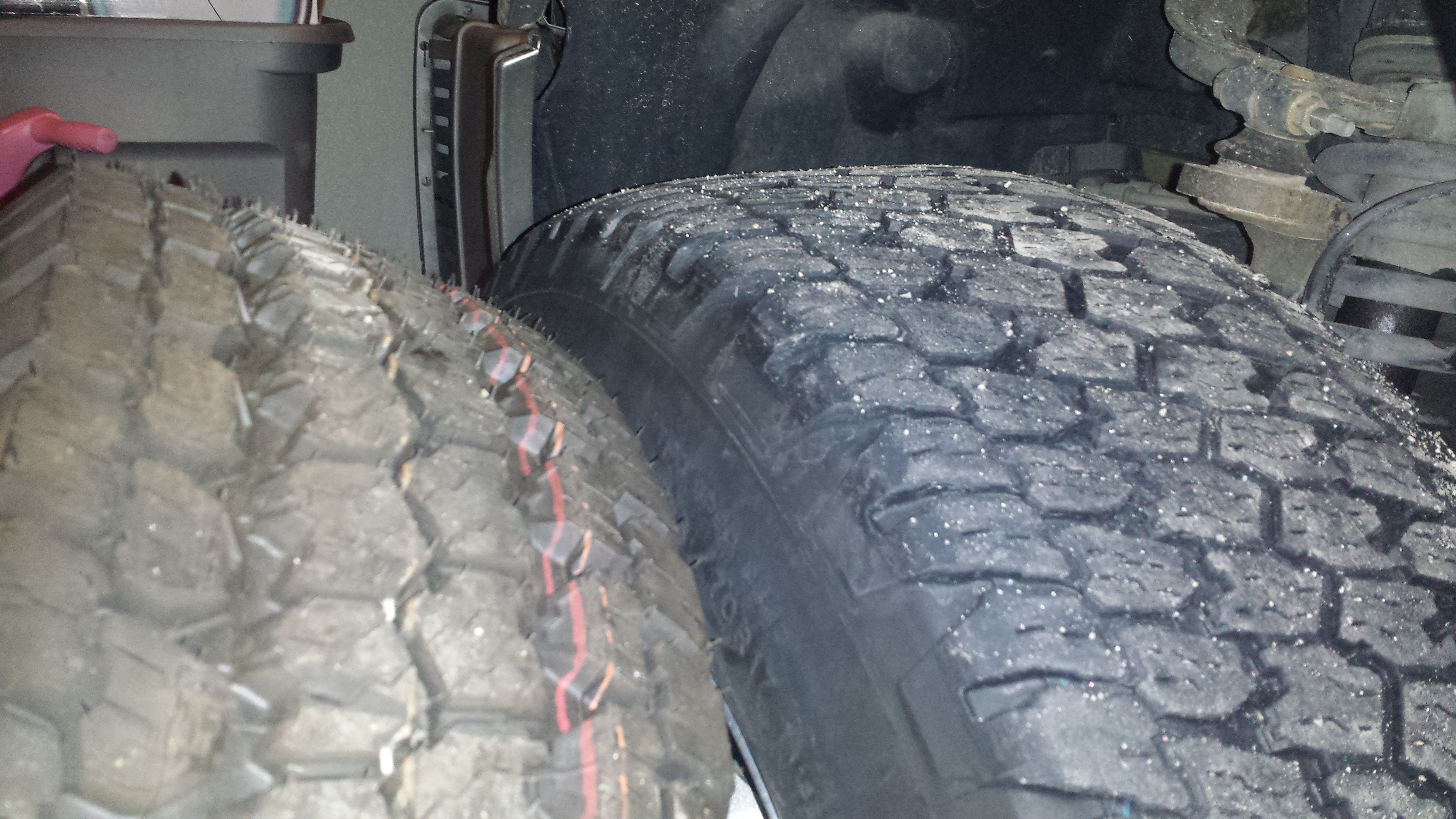

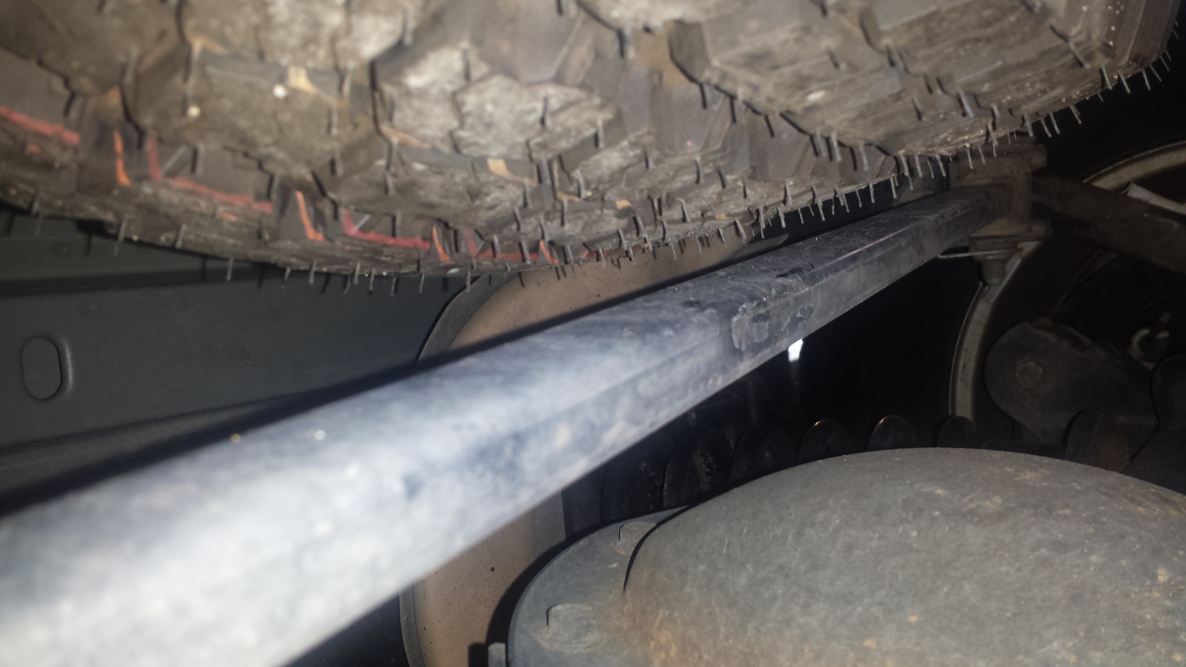

LT 265/70R17 for a spare. It fits! Kinda. actually it rubs the pan hard bar a tiny bit. Like the tit of the tire molding. Not sure this will be a issue but I'm going to run this like that till I figure out something else or some where else to put it.
Same tire? One is a LT the other is a P metric
Bought it for 50 doll hairs off craigslist
Installed. Look how close it is to the pan hard bar

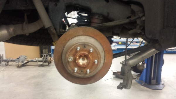

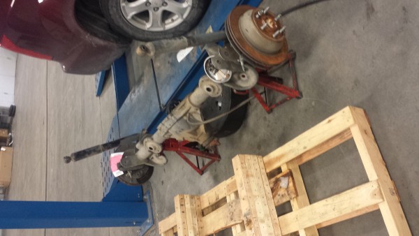

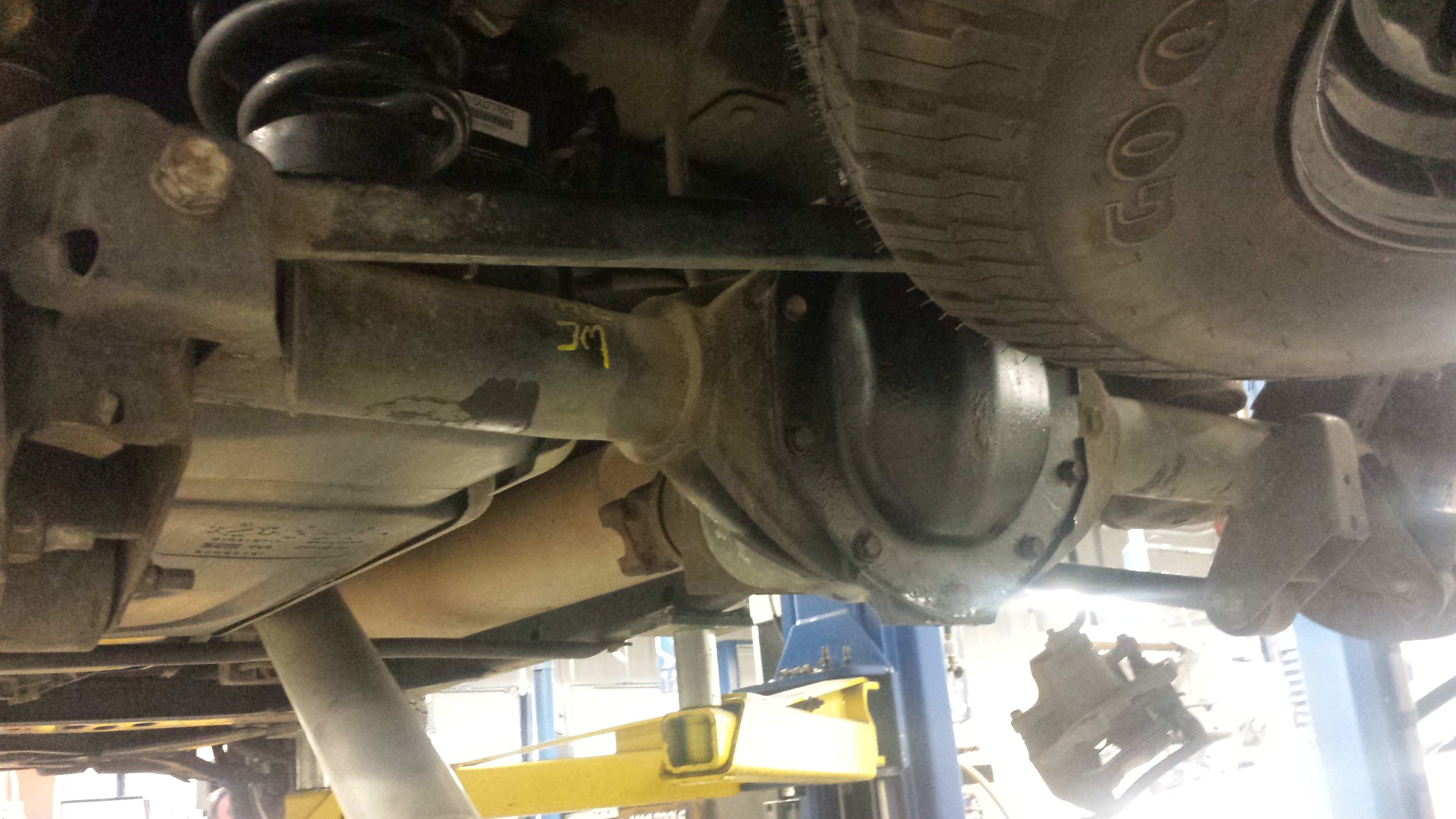

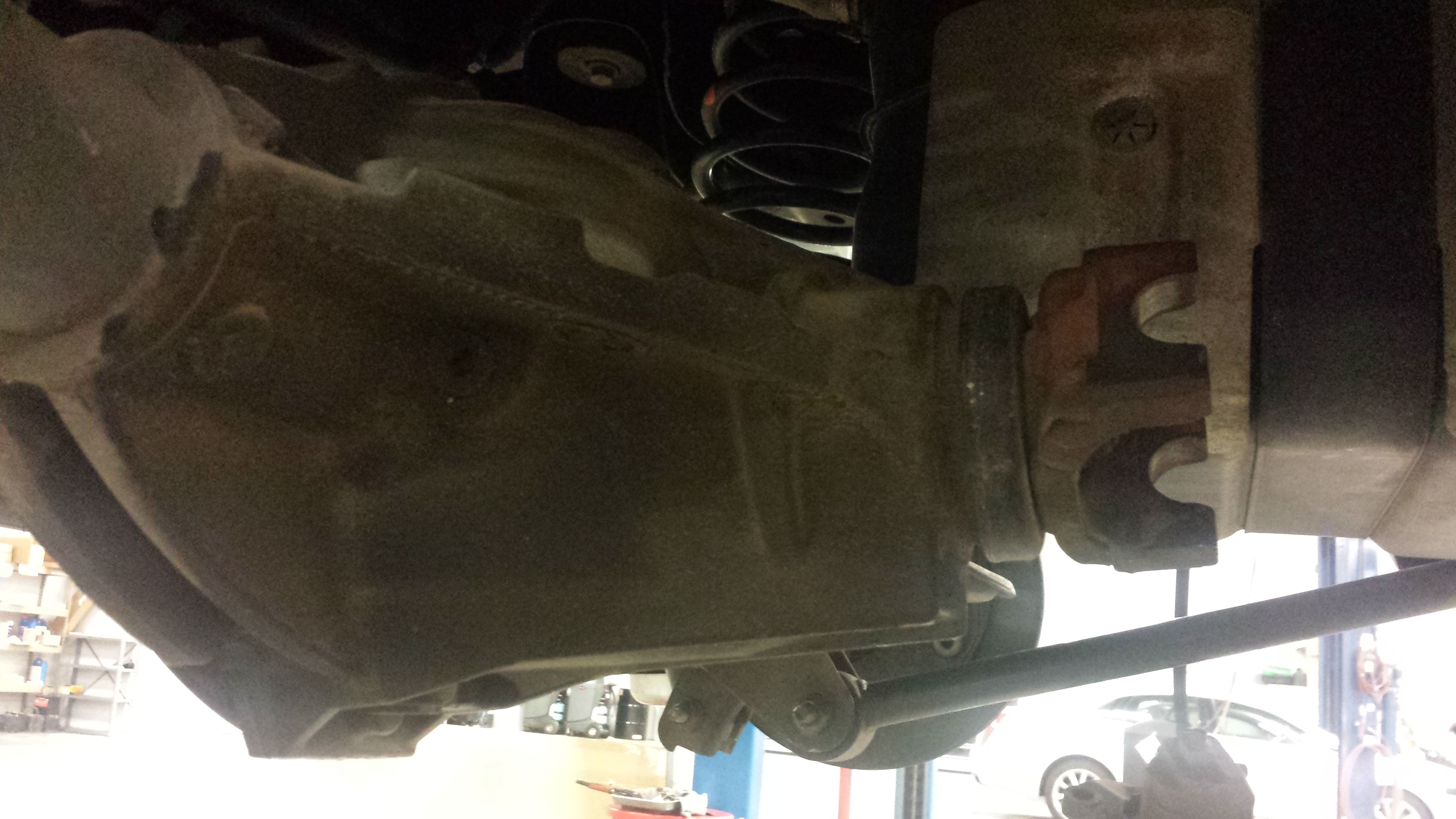

I figured its time to put the rear axle in that I bought a few weeks back. Front gears are on order from Jegs and should be here next week. I popped a new pinion seal in it and hopped for the best. After a road test I noticed the right rear caliper bracket was touching the rotor a little. So I made a little clearance with a angle grinder and it was good to go. All I can say is the 4.10 gears make it fell good on acceleration. I haven't stood on it yet but some day!

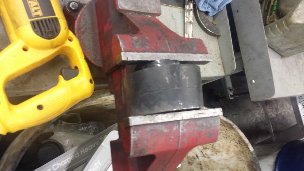

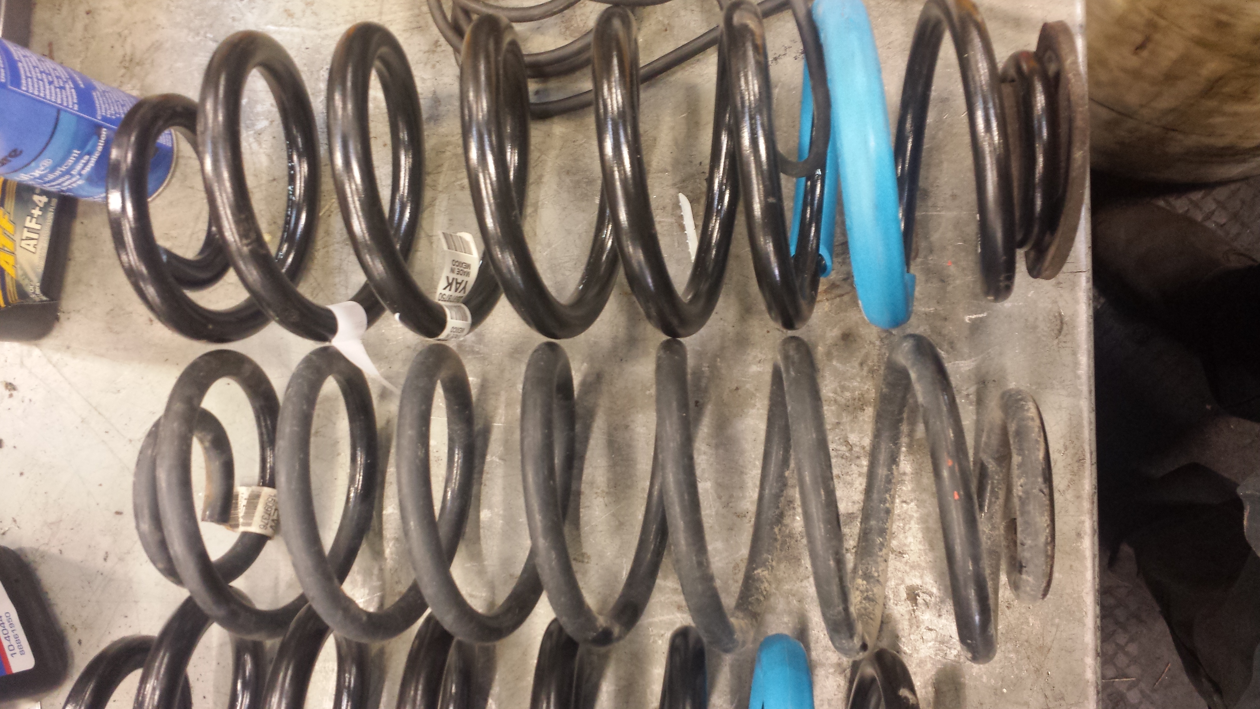

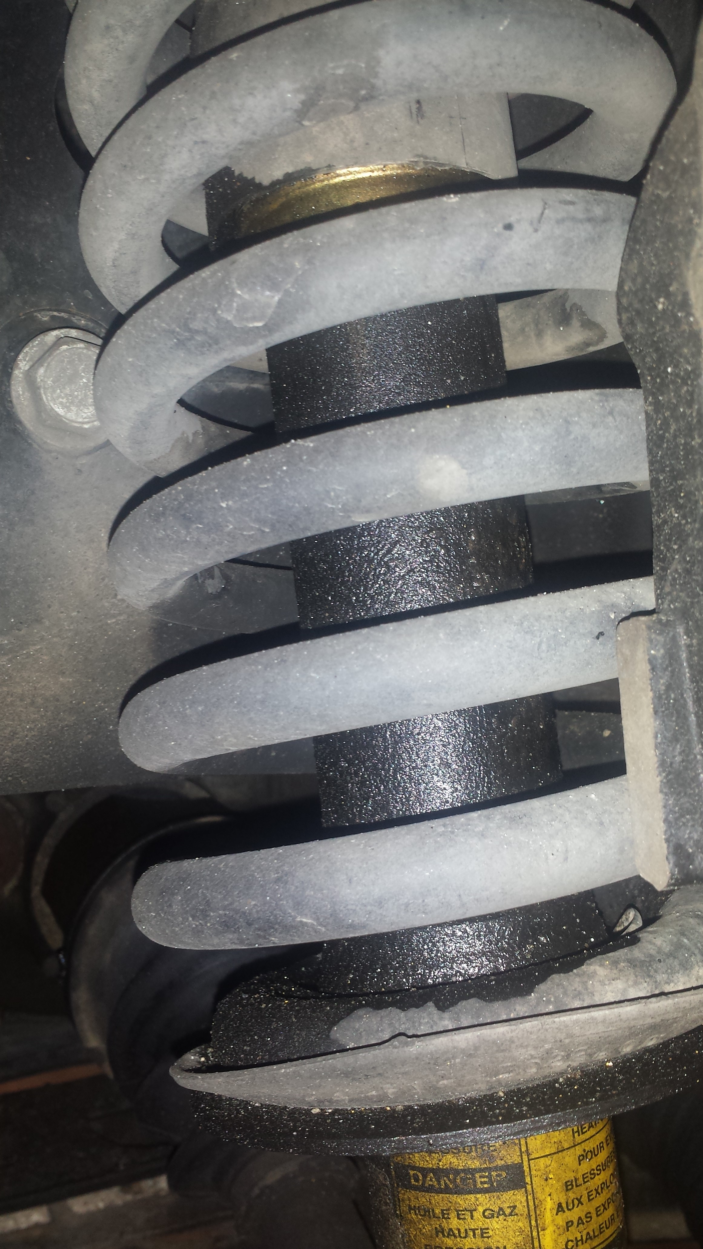

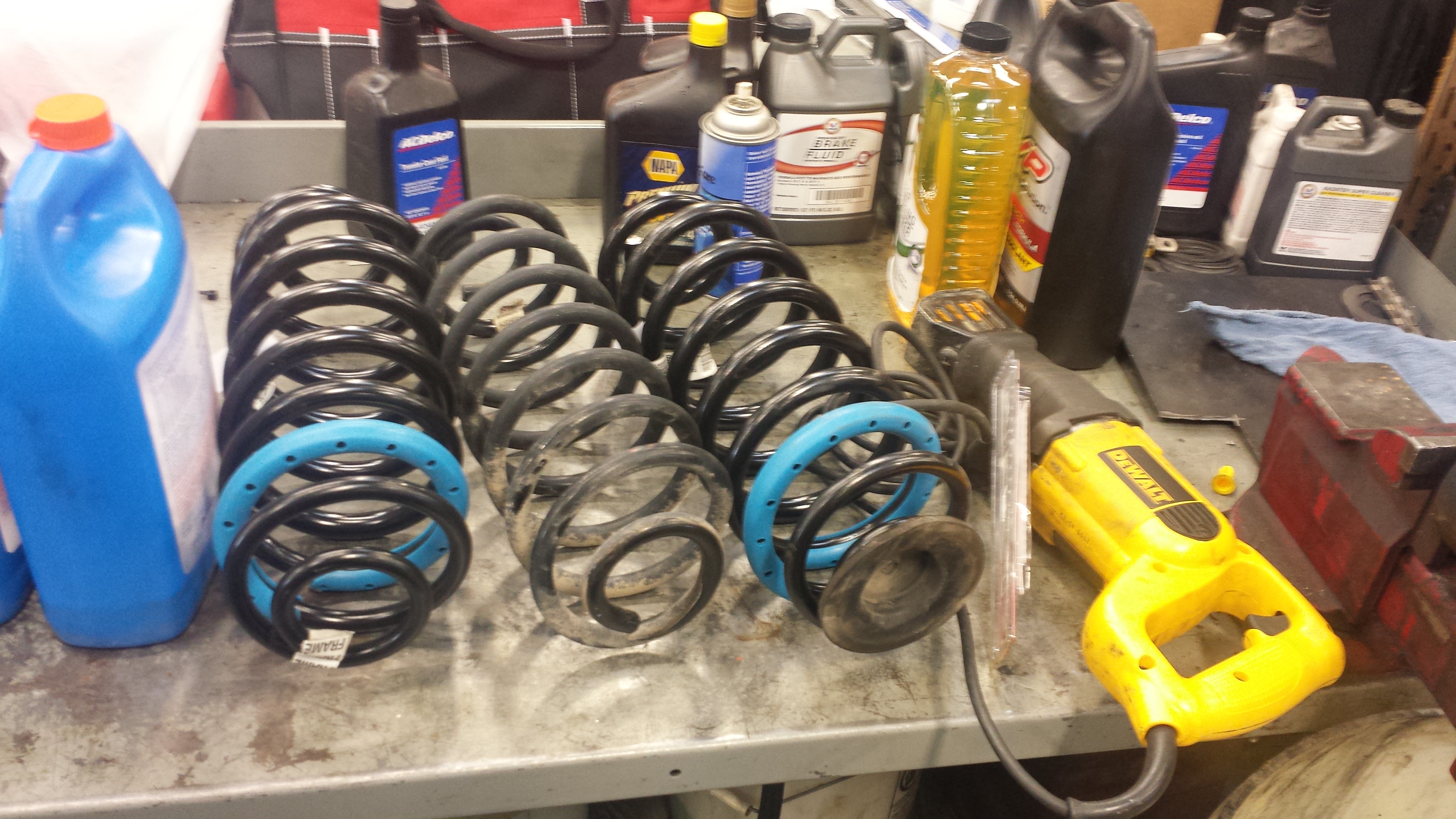

Last night I got a set of new Z71 Tahoe springs in from the parts department. As I am getting ready for a trip to southern California I had test fitted my dirt bike on a carrier to the back of my Trailblazer. The stock springs weren't bad but I could see room for improvement. So I pulled the rear springs and Marks spacers out. I have read a few posts where some members had just put the Tahoe spring on top of the full spacer, It gives a stink bug style rake to the vehicle. I prefer a level to slightly up in the front look. So I trimmed the spacer. I believe Mark had cast a line into the spacer so if you decided to go the route of using Tahoe springs you just trim at the line and then (most importantly) notch the inner part to clear the locating part on the axle. (the boob looking part!) Also on a side note while I'm here I ordered a set of 4.10 gears for the front. They were scheduled to be here last Tuesday 2/21 and go put on back order till 3/30 so now I am I have a 2wd with g80. At least the snow and ice is gone.
New Springs! Z71 Tahoe
Stock Trailblazer spring vs New Tahoe spring
Its a hack way of cutting the spacer but it worked for me
Notch the inner splines! they fit better that way

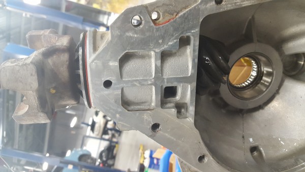

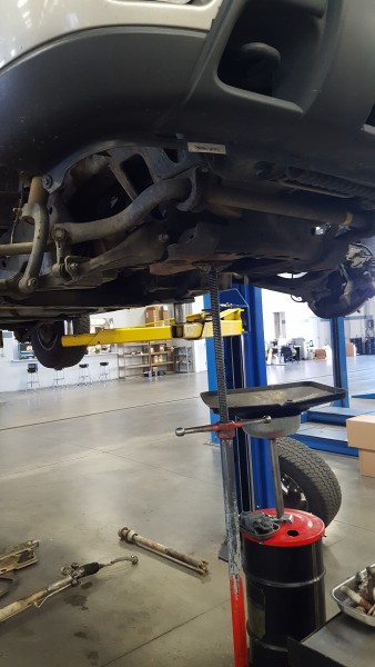

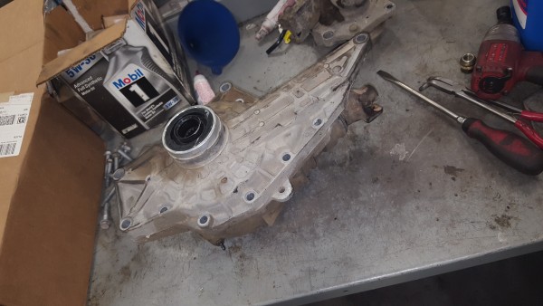

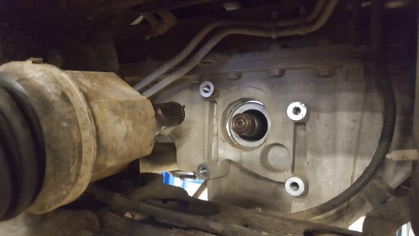

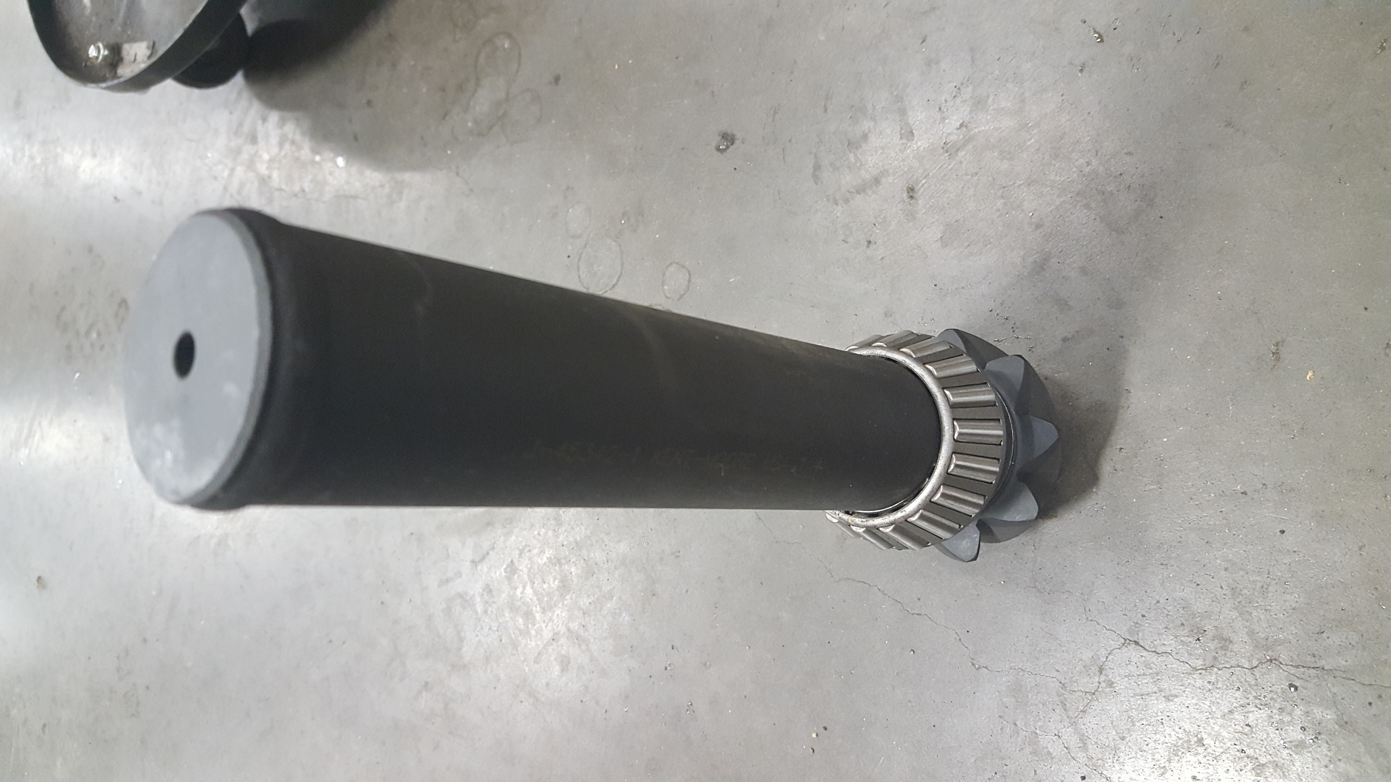

I finally have had enough time to build the front diff. This last summer has been super crazy for me at work. I found time to take a day off and roll through this. Removing the front diff was quite simple. I take mine out the bottom while others take theirs out the top. The end result is the same. Sorry in advance that the pictures are not in the correct order. The front diff on this unit was a bit different than what I have worked with in the past. The ring gear bolts are RIGHT HANDED tread. All the differentials I have worked with over the last 16 years have all had left handed threads on the ring rear. Also, the factory workshop book left out the side bearing preload. I found it in a 06 model year. All done, now I need to think of the next mod.
Setting the preload on the new pinion gear. This is the hardest part IMO
New bearing on the pinion gear
Were was that tool I just had?
Pull out a few other parts
Undo the fan and the motor mounts. Lift the engine up till the engine mount studs cleared the bracks
Removed axle disconnect
Having a lift makes it easy to service

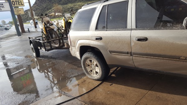

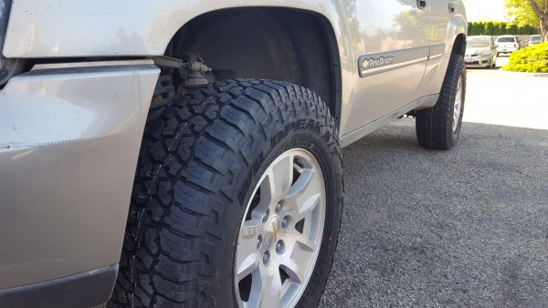

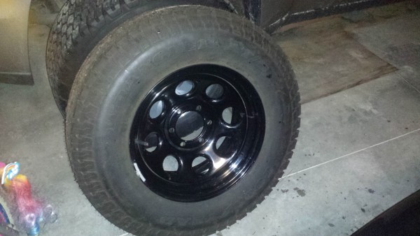

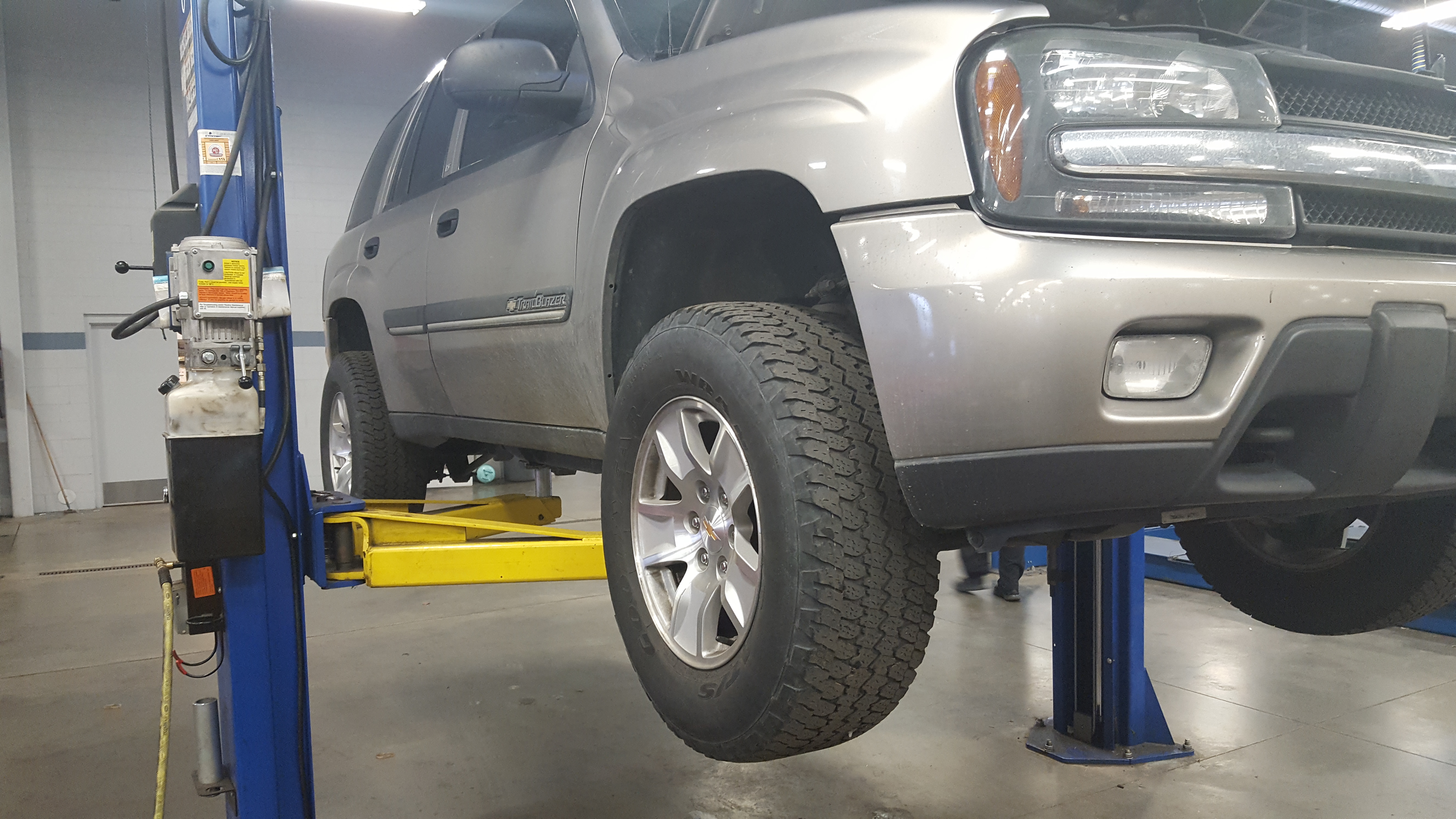

Been a while since I updated this build. So a few things have changed. The old Goodyear Wranglers gave up the chase. They still had about 5-6/32" left and were around 9 years old. The problem was almost every time I went out I would get a flat or two :cry:
Flat tire in Jordan Valley OR.
I spent a few bucks and purchased a set of the Falken Wildpeak AT3w
New Rubber!

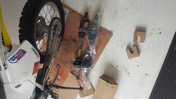

I noticed a while back that I started to get pinhole leaks in the front CV boots. I looked around on the Facebook page and found that a few of the members liked using the Detriot Axle parts. Ordered up a set $90.00 and free shipping for the set. Cant beat that price.
Removal is really easy. Jack up the front, remove the tire, remove upper ball joint from control arm. Remove axle. :D
