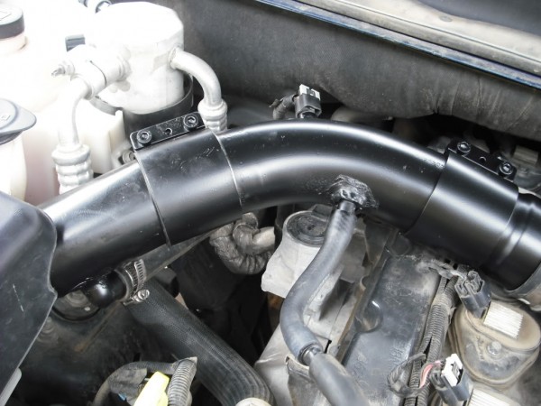

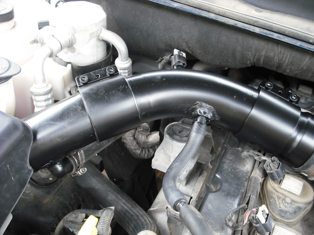

Started with the trim molding removal. Found a great tutorial on another site, won't mention the name. Used fishing line and a 3M adhesive remover. Then deleted the resonator.
Then came along the HID kit. The first kit I installed was from JetttStream that I cant remember that offered the kit to install quad beam head lamps. The bulbs failed shortly after and couldn't get new ones from him. Found this place through a buddy of mine and they have not failed me in 4 years now. http://www.ddmtuning.com/
The custom intake was next. Had some piping sitting on a jobsite so I grabed some and made this guy up. Running a K&N filter and did the intake box mod as well.
I will post some more of the mods that I have done here in the near future.

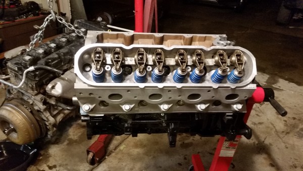

Well blew the 4.2 up (For the second time). Started knocking so the rig has been sitting for 5 months now :(
So I am now moving forward with the 5.3 swap.
Engine Mods
LM4
LS9 Cam Factory Gm Part Number 12638427
GM Performance Valve springs 12499224
Milled heads, blended bowls
Trickflow timing chain tensioner
LS2 timing cover 12633906
LS2 Timing chain - 4x Timing Gear set for moving the cam gear to the front. 9-3672TX9 Cloyes
2200 Stall Converter

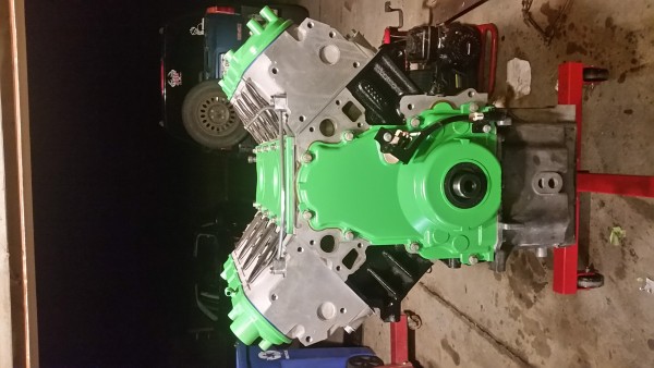

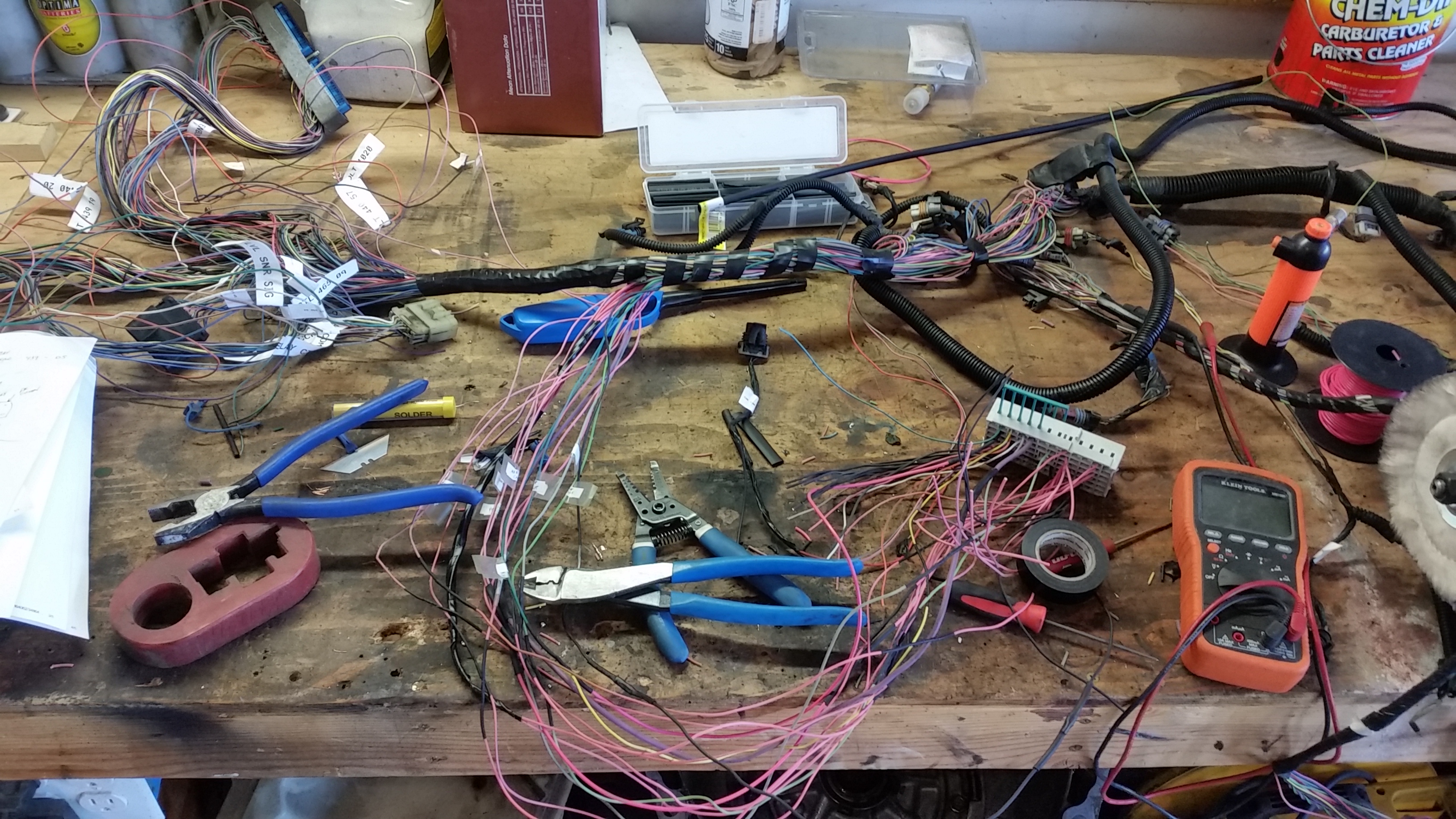

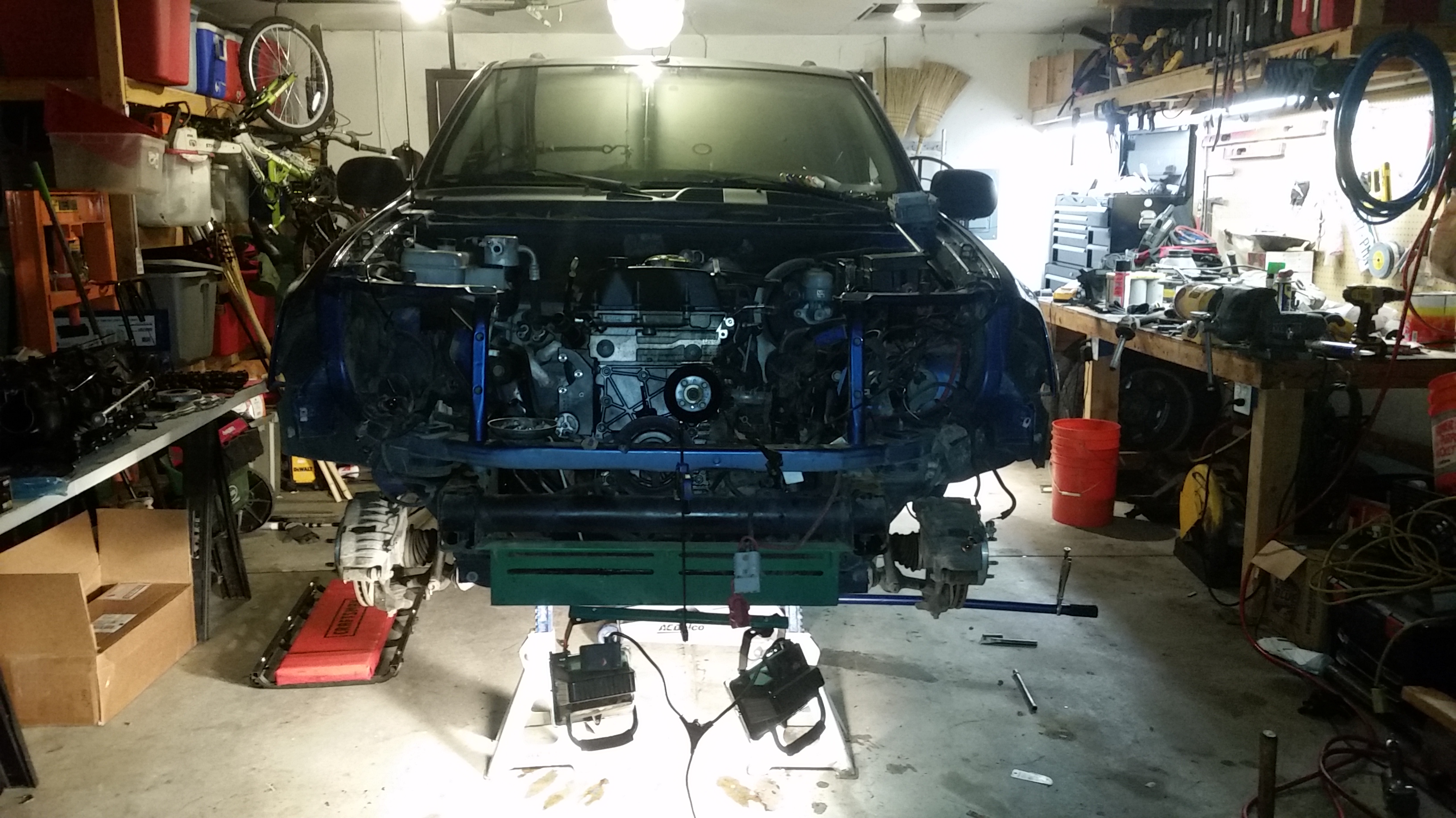

by anthonyl79 » Sun Nov 01, 2015 5:49 pm
Well here are a couple of updated photos. Working on the wiring for now. The harness came from a 03 Silverado and the ECM from a 04 Silverado. Fun thing about the 03 harness it uses a different PNP switch. )3 used two plugs and the 04 and up uses a single large plug. So little more wiring that needed to be done that didnt plan on.
Motor is ready for install just need more money to rebuild the transmission. So fell free to send some my way :excited: ;)

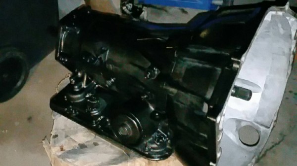

Well time for an update. The transmission done. Updated hard parts, Sonnex pinless 1-2, 3-4 acumulator pistons, vette servo, hardened seats on the separator plate. New 2800 stall converter and of course new bellhousing.
Search is on for an alternator, power steering pump, mass air flow sensor and starter. Also need some 3.73 gears for the front 7.2 diff.

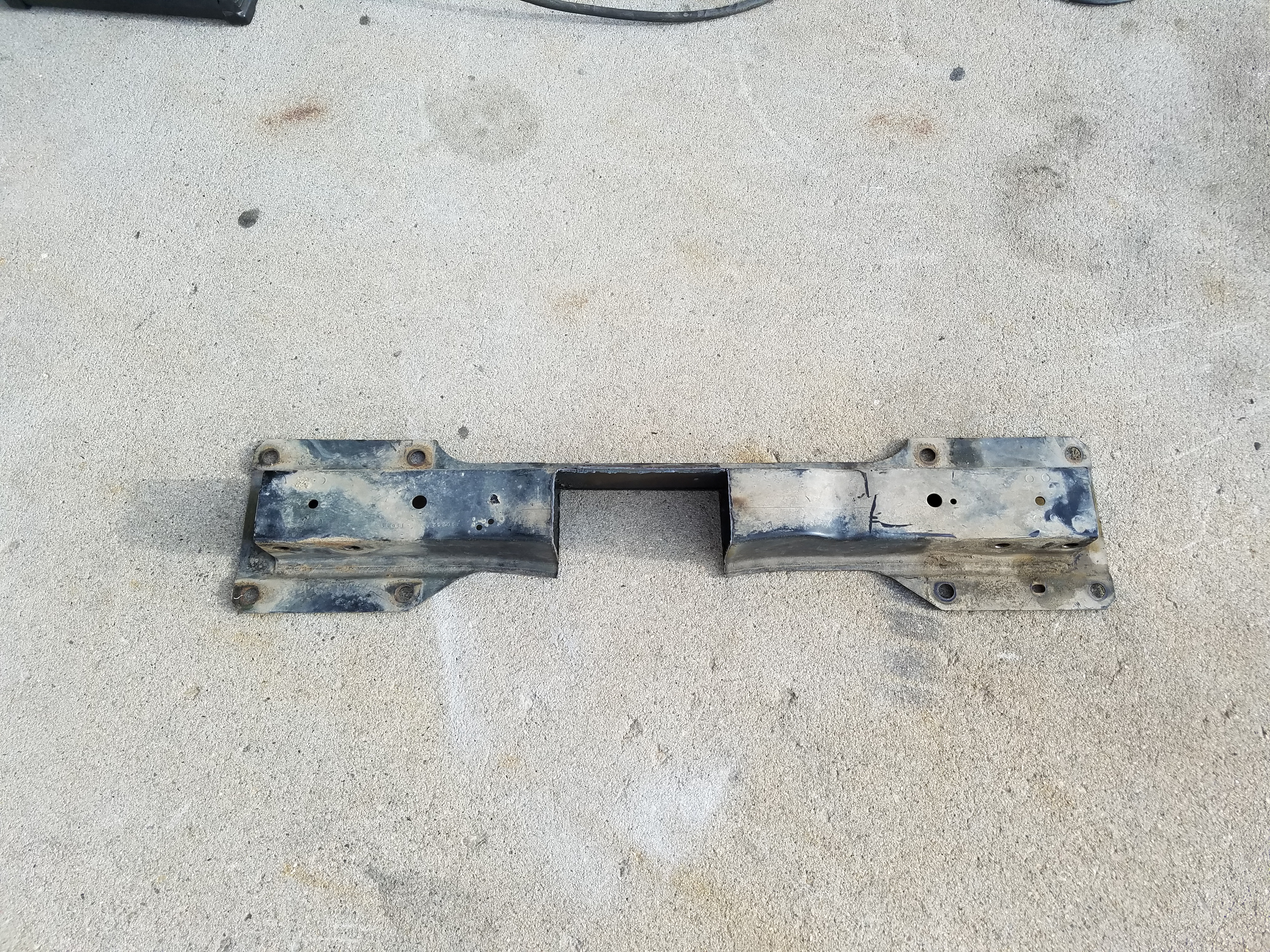

So the wiring is done, until it's ready to fire. Got the transmission and transfer case in. The back of the new 5.3 sits 2.5 inches more forward than the back of the 4.2, so had to fab the transmission crossmemeber. The 4.2 and the 5.3 Envoys and Trailblazers use the same crossmemeber but have different mounting locations.
Picked up a 2006 5.3 4x4 Trailblazer driveshaft. 4.2 driveshaft measures 36" from center of ujoint to center of ujoint. 5.3 measures 38.5 center to center. Ujoints are the same so no biggie.

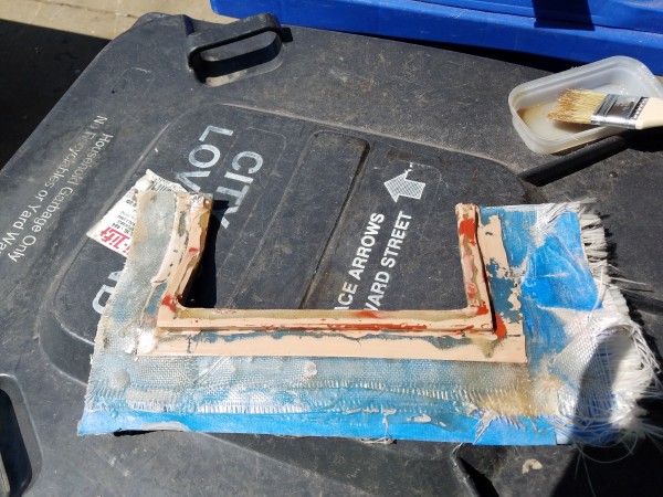

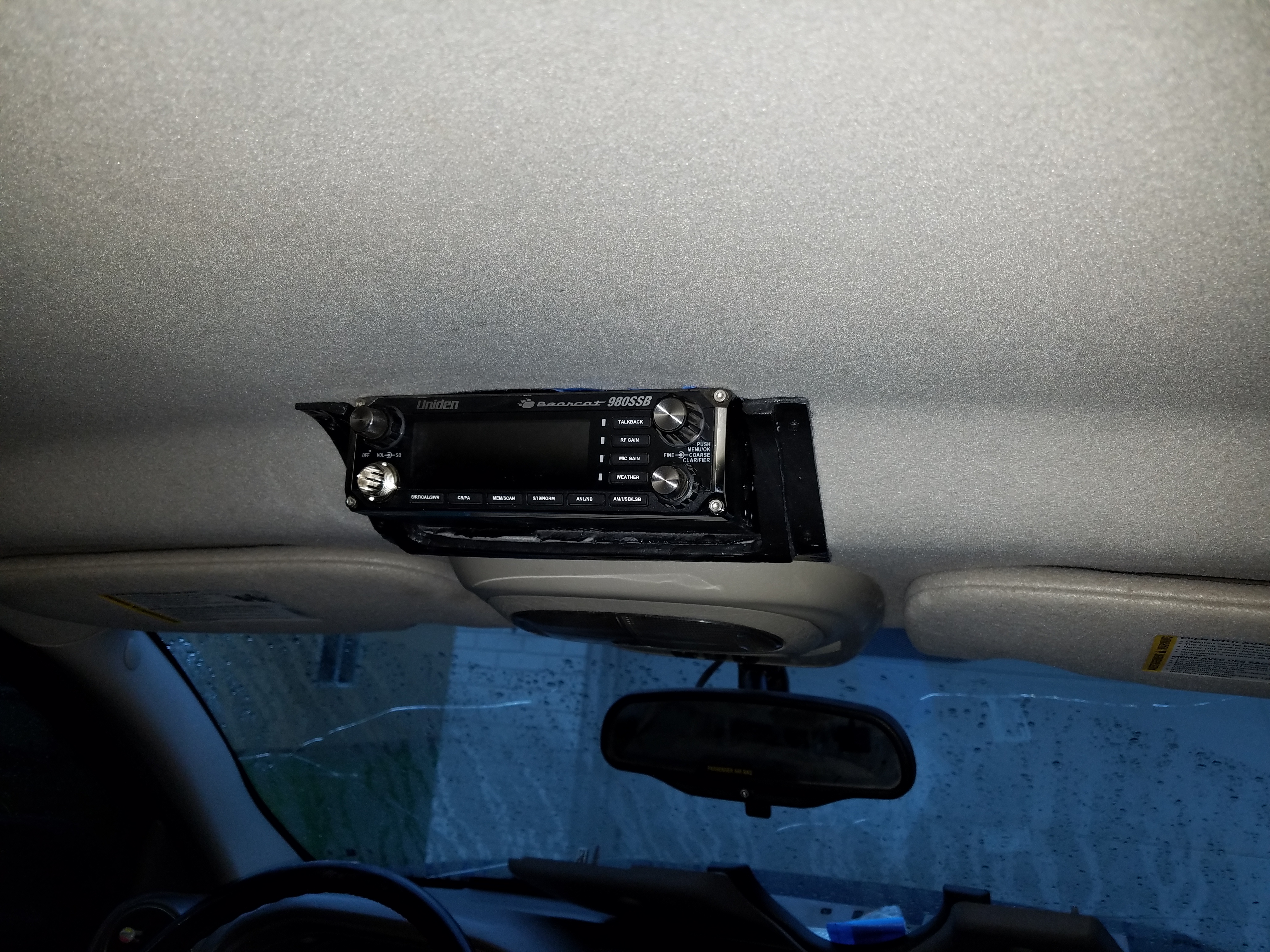

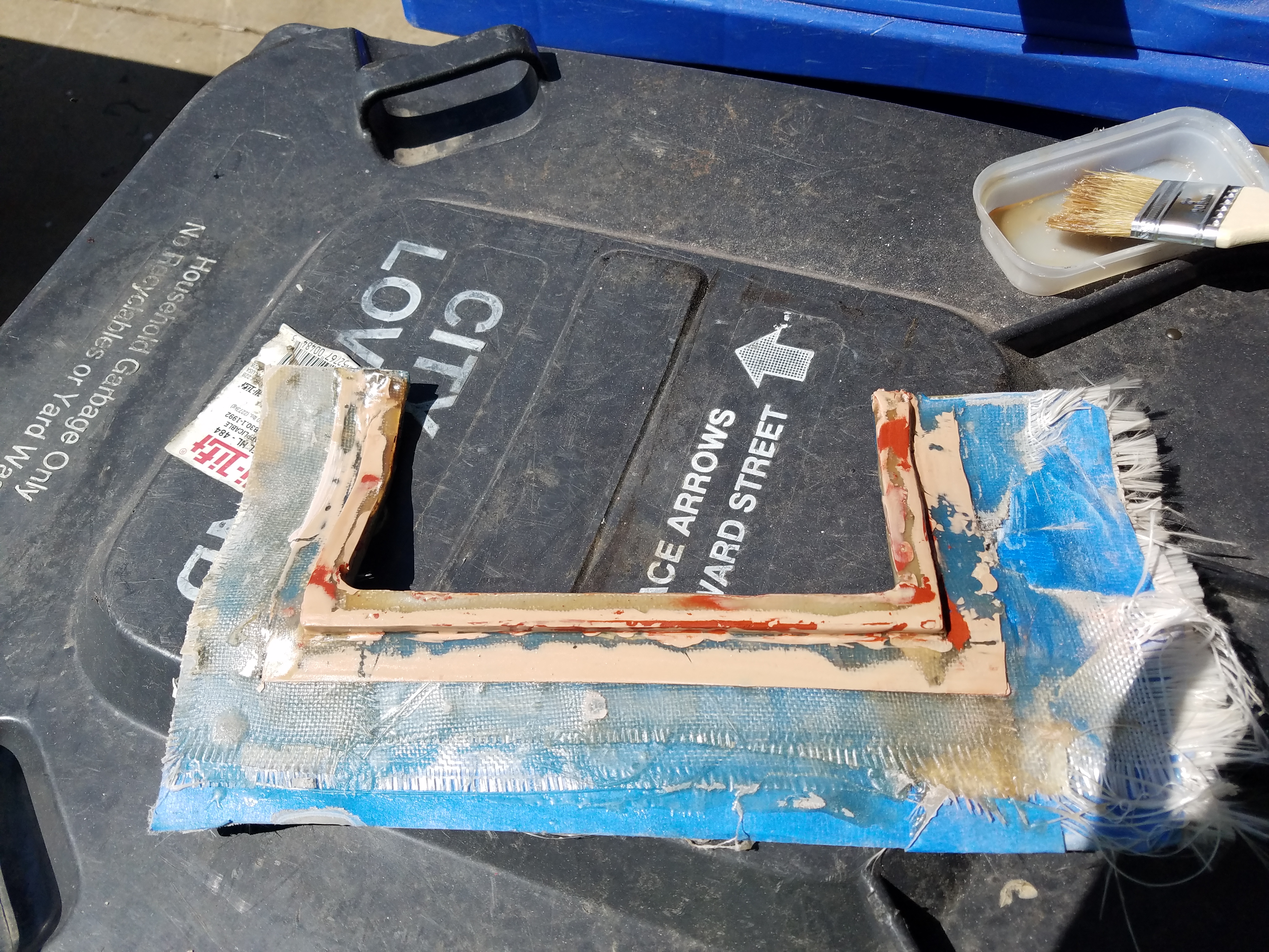

CB Radio Trim ring in process
CB radio trim
CB and trim installed
CB installed

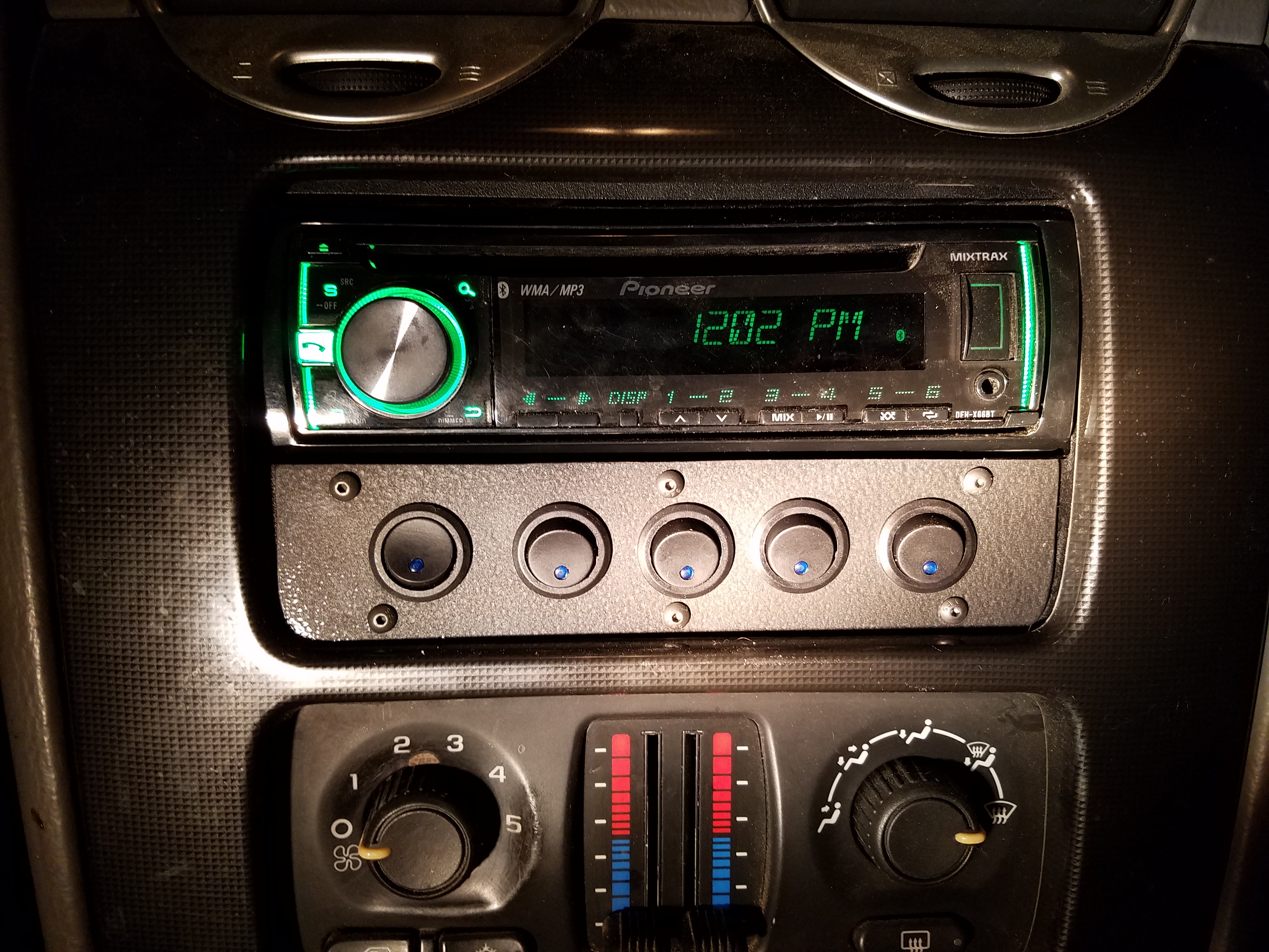

Switch Panel
Switch Panel
Trans cross member started. Forgot to get after pics.
Cross-member

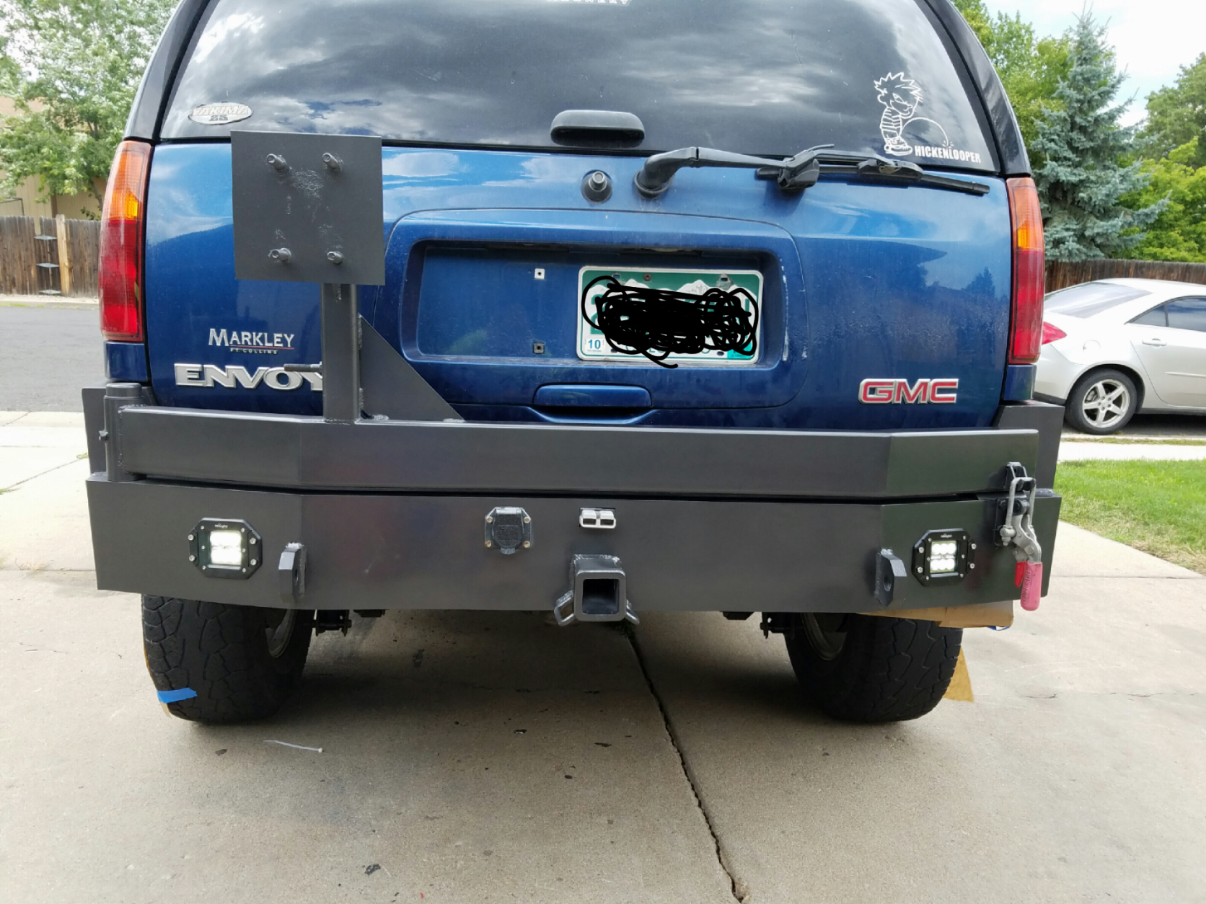

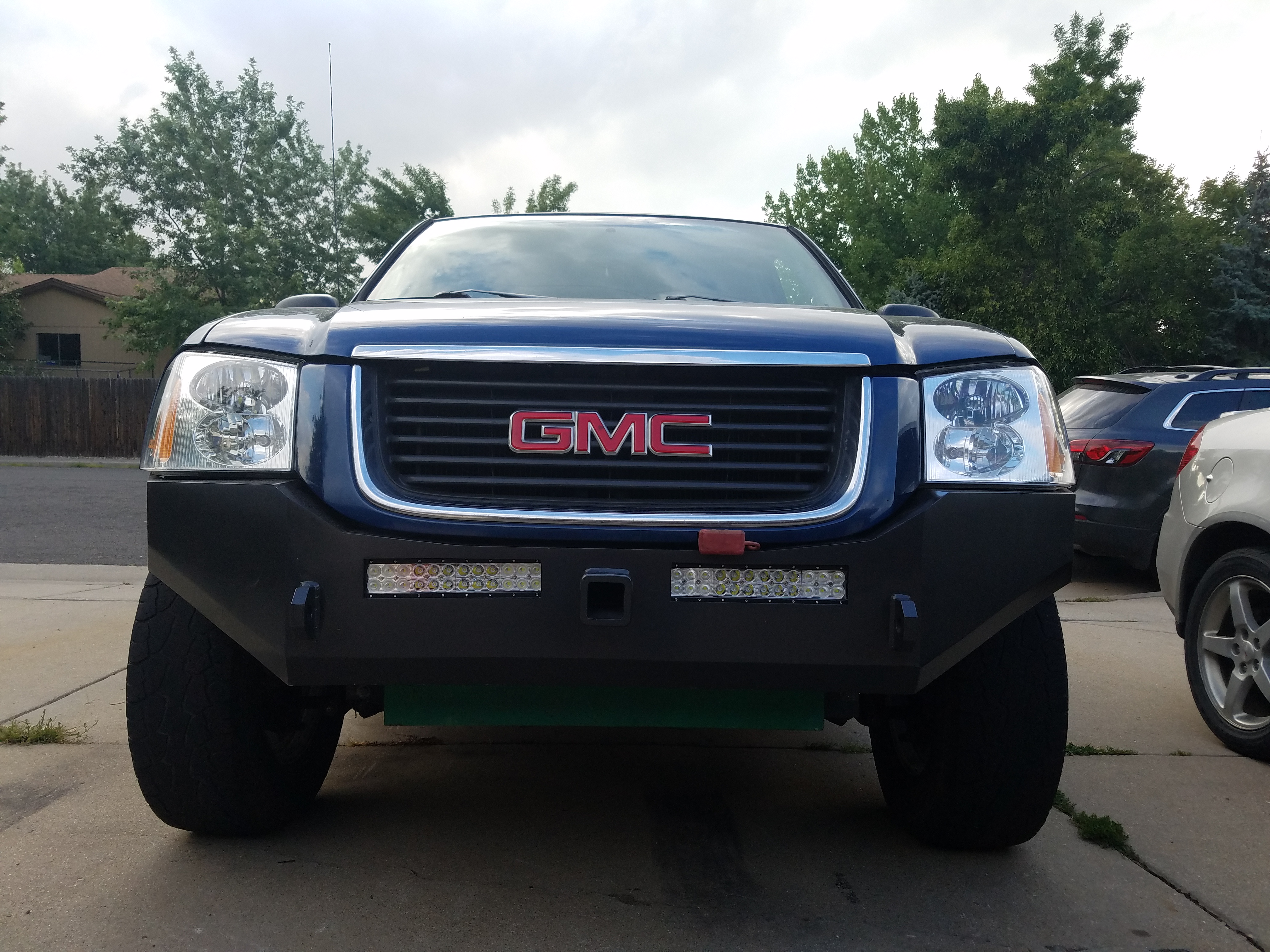

Front and rear bumpers with lights added
Front
Rear

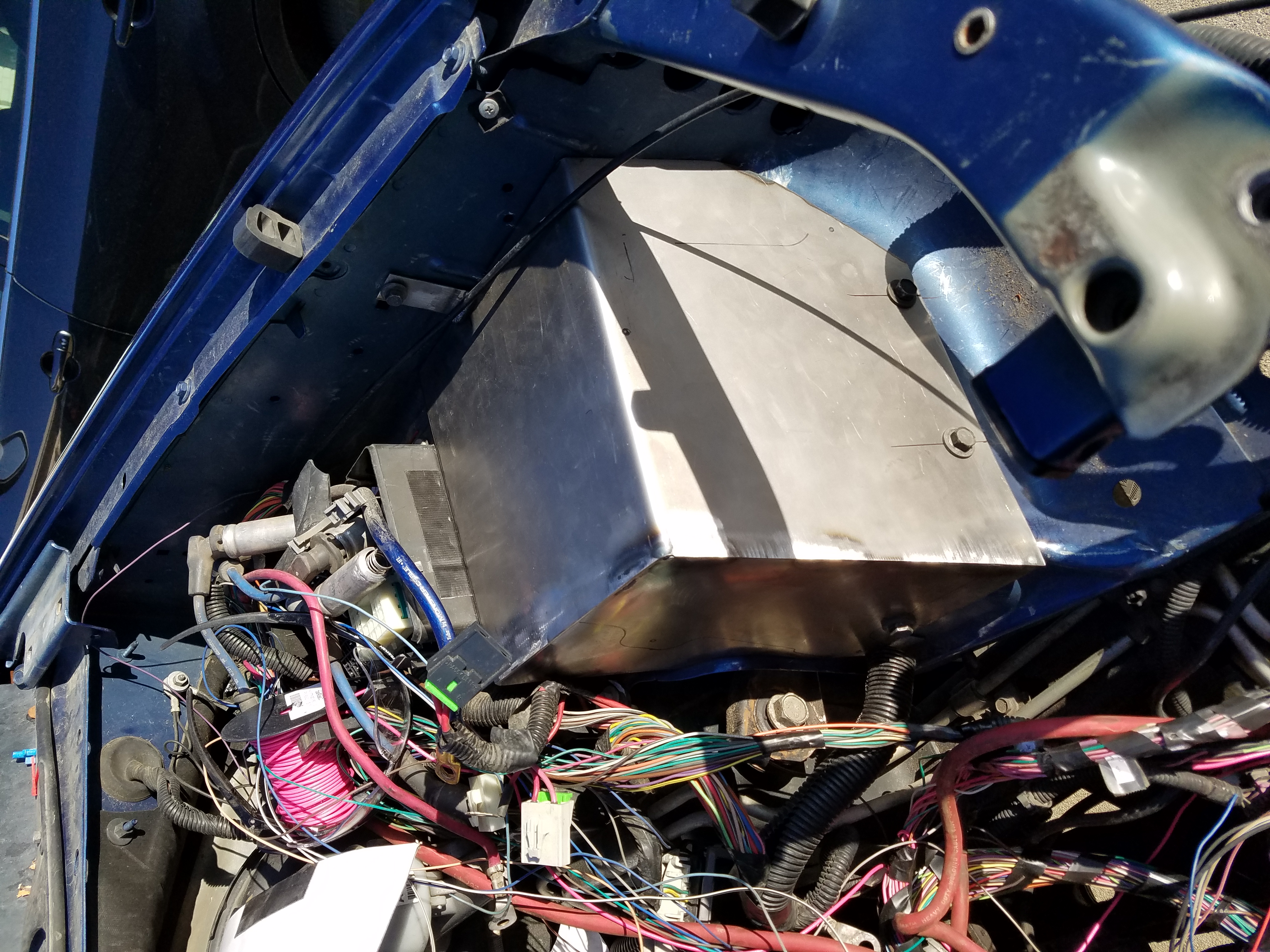

Batter used to be here now its the new home for relays and PCM
ECM Mount

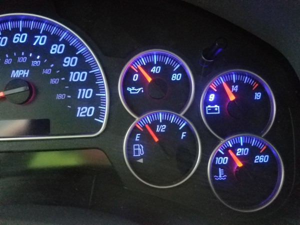

Dashlights converted to LEDs
Dashlights
